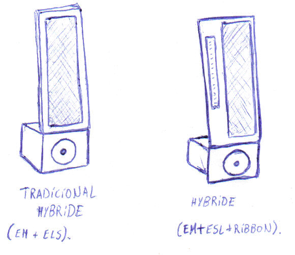

Hi. In the monent i work a ESL Hybrides... I live in Chile, the electronics stores, have a low quanty of special and advances products. For ex. special condencers, coil, toroidal transformer the low power.....

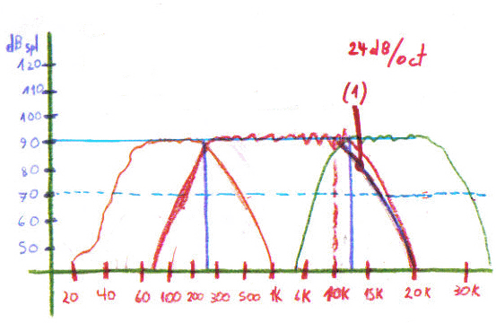

In the moment restriged my project, for impossible buy a tororidal transformer (not have stores)... I work my project with a tradicional transformer... The tradicional transformer, out 10Khz to 20Khz gradual... 90 to 70dB SPL... My news pannel limit bandwidth... (220 to 10Khz efective respose ESL Pannel) in a theory... I not real test.
http://img138.imageshack.us/img138/7690/eselsombetzkitoroidvergleich9u.jpg
For compentation i thought a work a "RIBBON TWEETER"... RiBBON have a exellent responce in a high frecuences and clarity hi definition sound, similar a ESL)...

Adding a ribbon to an ESL means just to give up on some very useful features of an ESL, like best step-response, highly linear acoustical phase response, resolution of detail, extremely low distortion and so on and so on. Too, the ribbon will probabely cost You more money than a good set of toroids.
