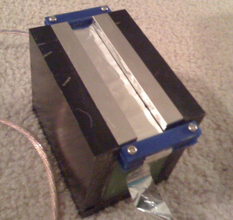

Hi everyone - These are some ribbon speakers I am in the progress of building - They are really in a prototyping stage right now - experimenting with ribbon thickness, rear chamber stuffing etc.. - I have designed the motor so I can adjust the gap from 20mm down to 5mm - I have no transformer yet so I'm just using resistors to make measurements (very inefficient) The plan is to keep this thread updated as progress is made.
Current Specs:
Magnets: Neo N40 4"x1/2"x1/2"
Ribbon size: 20mm x 100mm
Current Specs:

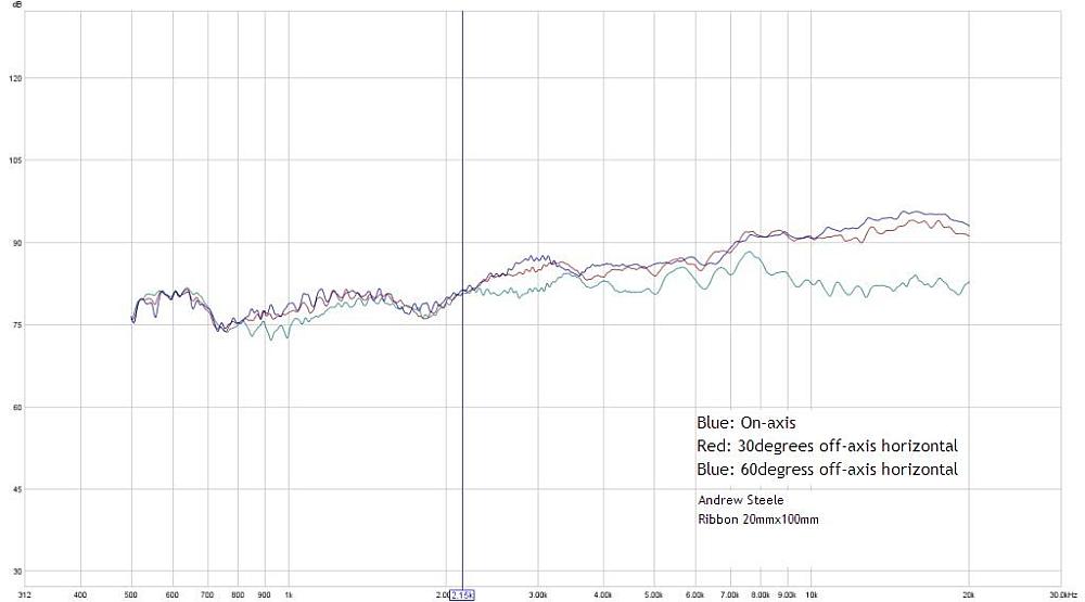

I'll try to get some measurments going - but I'd really like to get a good transformer on the ribbon before doing so. But I guess no harm in trying with resistors?

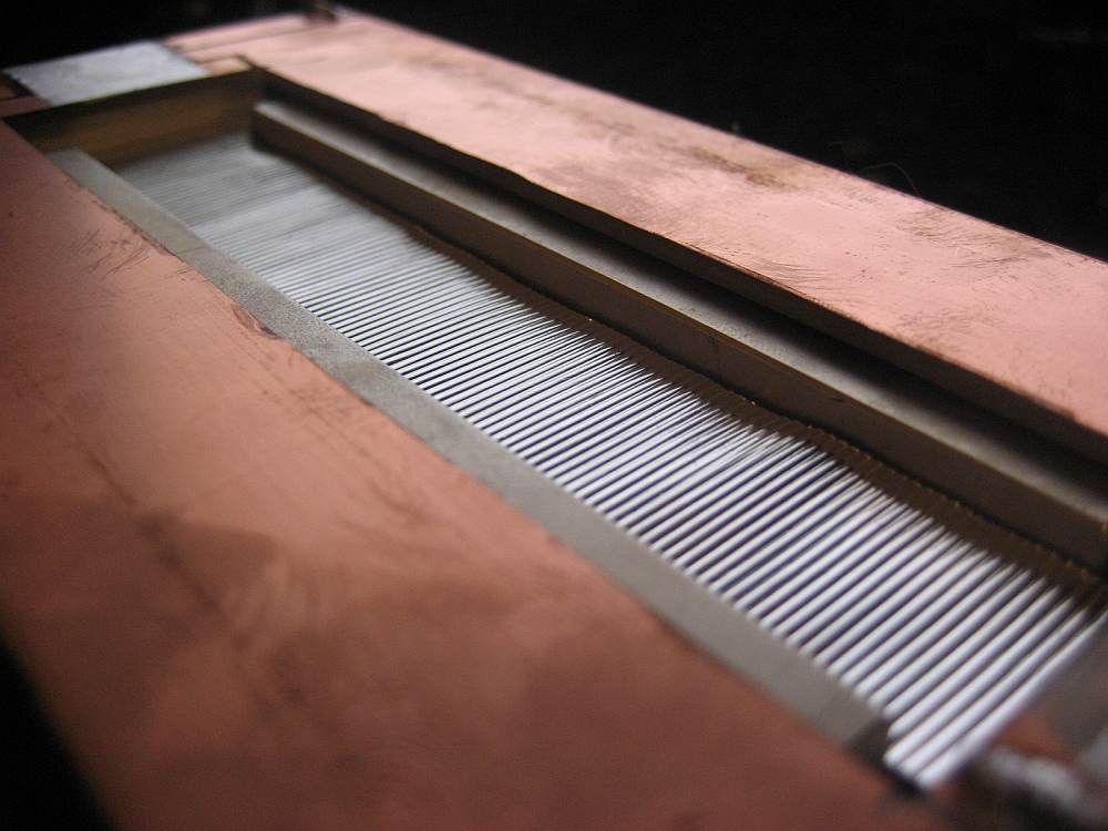

Consider measuring with a flush planar baffle on all 4 sides - no gaps (will effect the extreme HF) - that will tell you another story about the response compared to free air.
Also, consider the purpose of the corrugations found in most ribbon speakers - perhaps you want to add some? It might be sufficient to add just one or two on the ends...
Nice looking work.
Consider using the closeup feature on ur digital camera, the image is a bit fuzzy... but it looks good.
_-_-bear
Nice looking work.
Corrugation tames most of rattling noise
Mine will be pressured onto a fine zigzag pattern
Nice project
I have to be honest the progress so far was just me hooking it up to check if the magnetic motor worked - while I was there I thought I'd do some tests while I was there. I have to get a baffle set-up going and corrugations are planned.
The fuzzy picture is couresy of the iPhone and it's lack of any autofocus. I'll take some better pictures soon - When I've sorted a better ribbon mounting setup as there's no real point now.

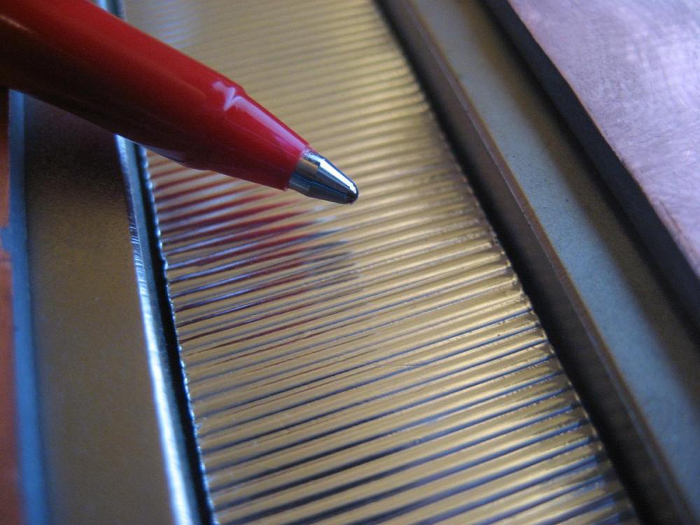

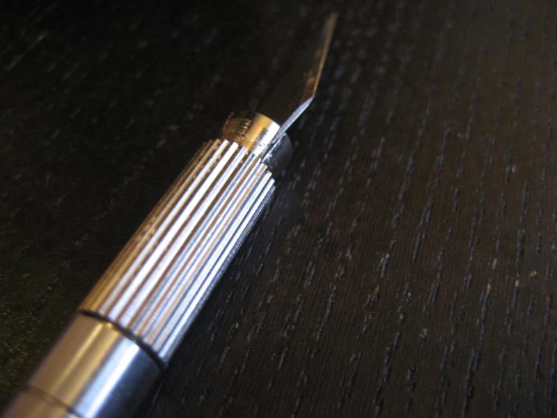

Picture of the "Artwork Knife" from Jaycar electronics I pulled off the corrugated section (20mm wide) and used it to put the pleats in the foil. I plan to make up a rig to feed ribbon through for quick and consistent ribbons.
CAT. NO. HG9955
http://www.jaycar.com.au/productView.asp?ID=HG9955
CAT. NO. HG9955
