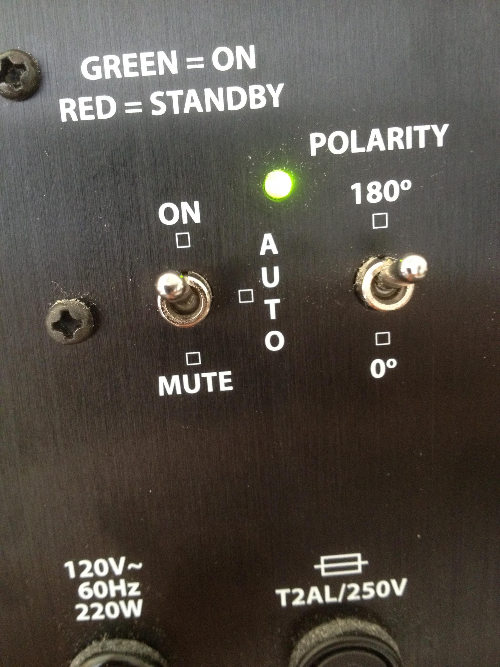

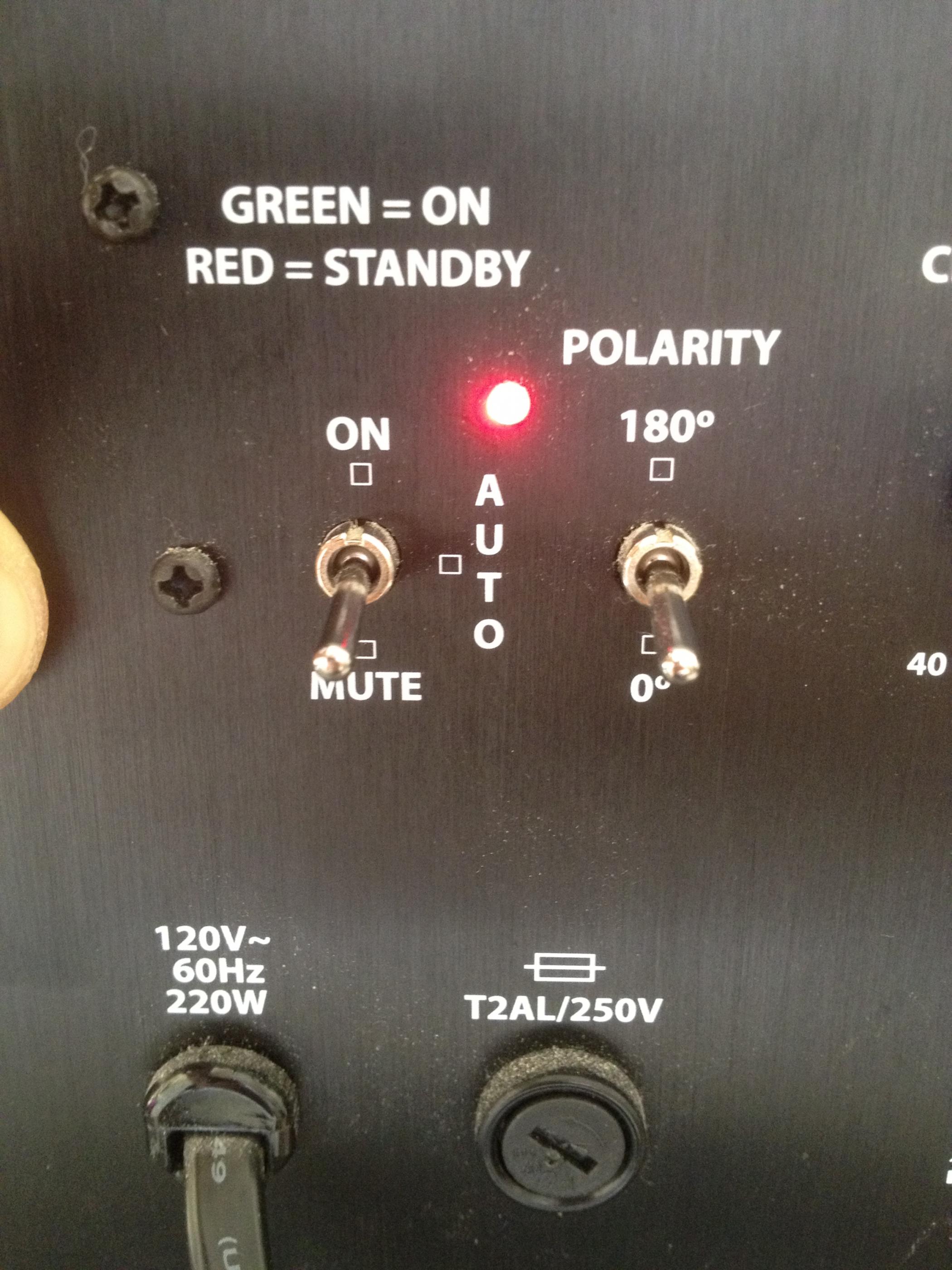

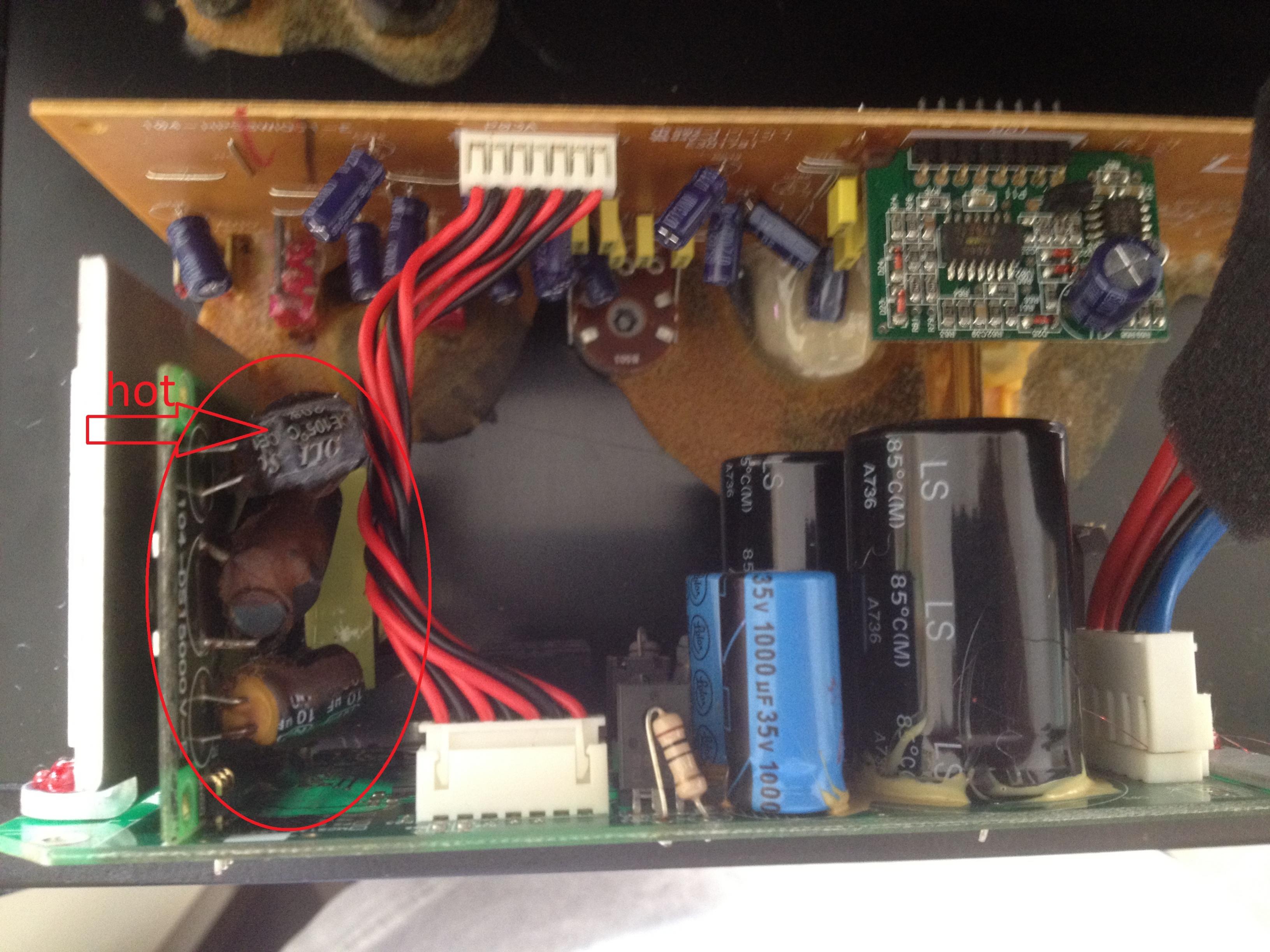

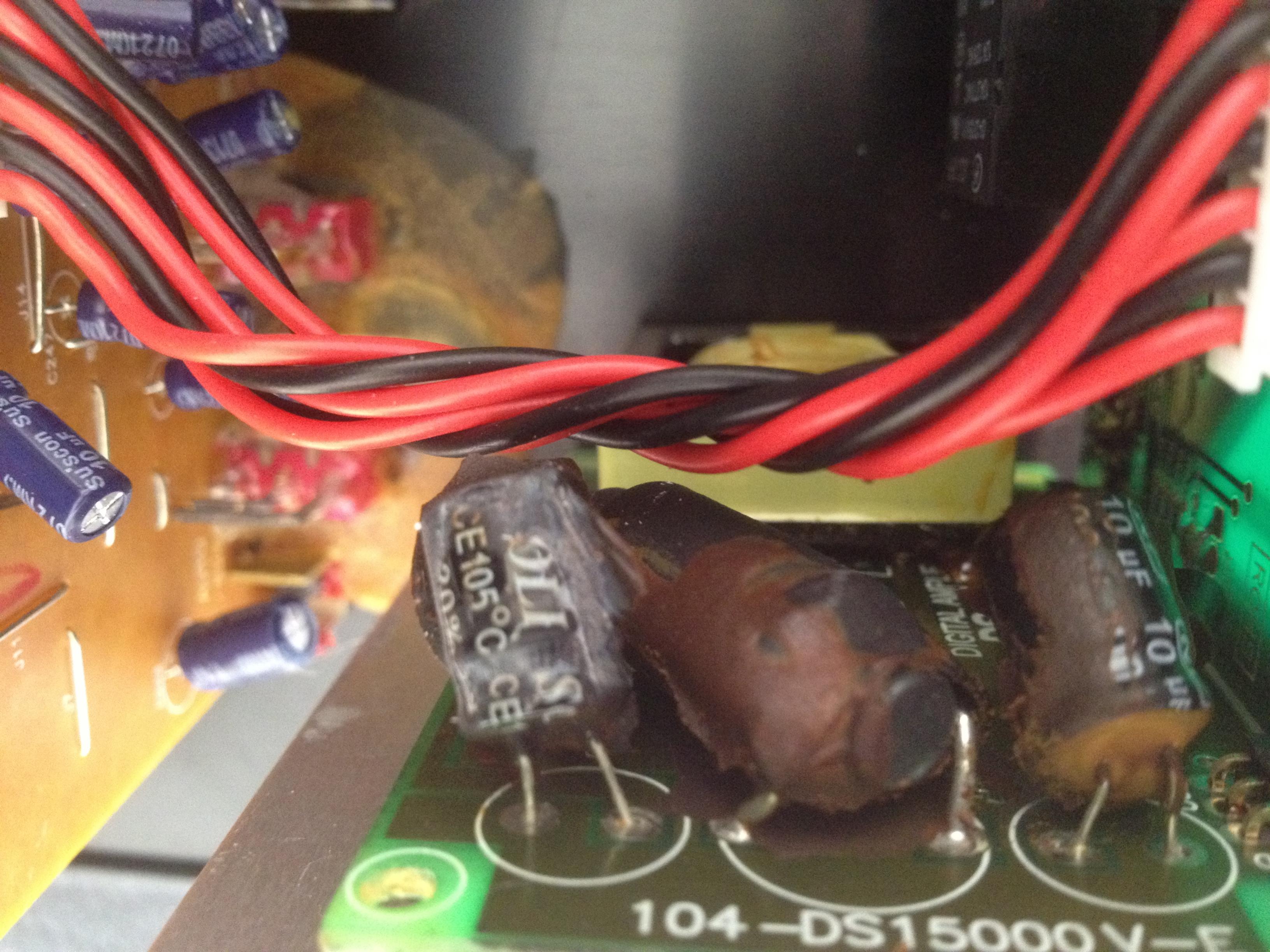

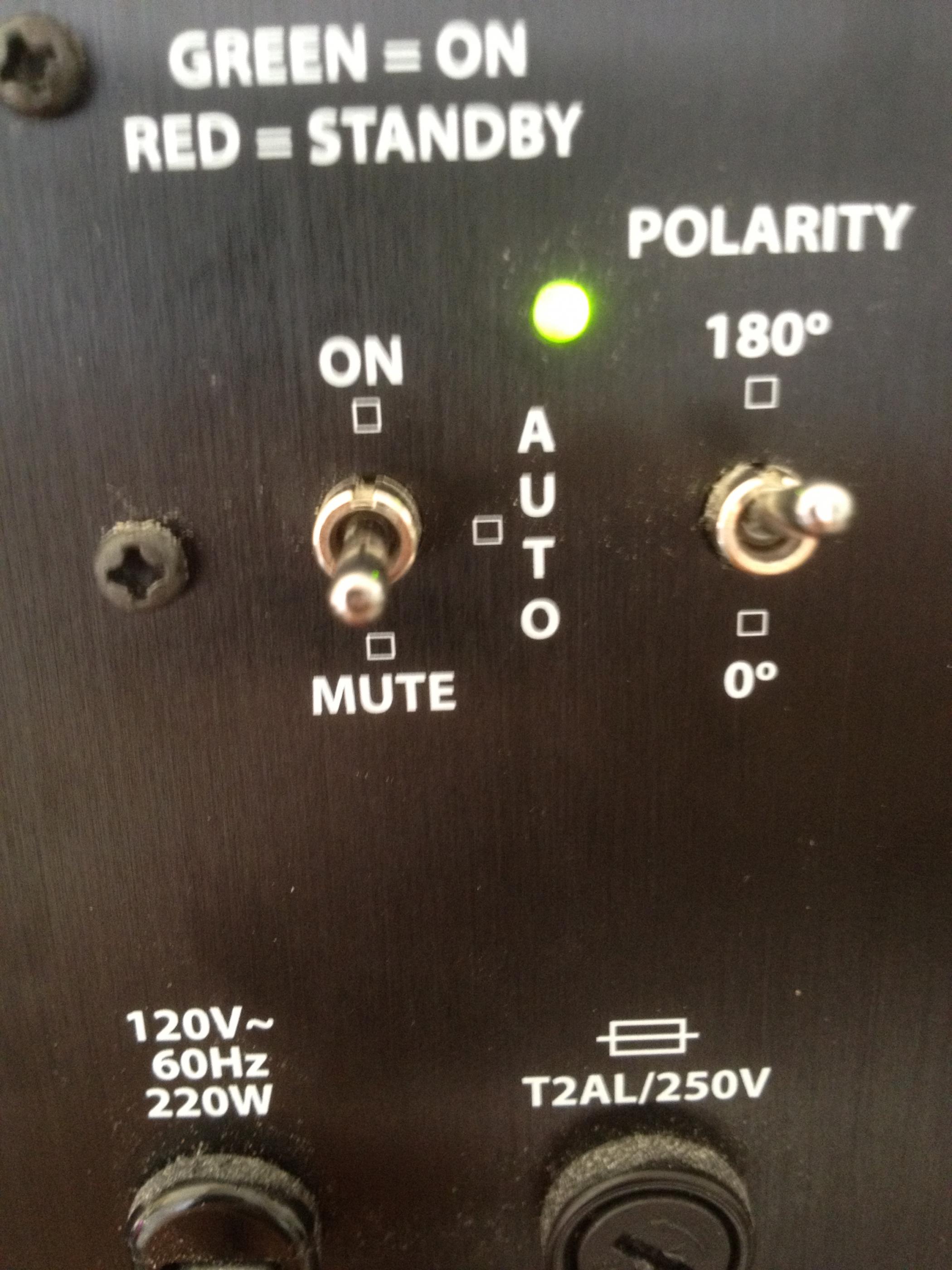

Hey, my name is Zach. I have a Boston hps 10se subwoofer with built-in amp that has stopped working. It is able to turn on, however no power goes to the speaker. I tested the speaker with a different amp and the speaker works. I did a good ol' smell test and noticed a slight odder around the caps caps in the first pic. The cap being pointed to in the pic is getting very hot as well. I also noticed that when I put the switch into auto mode the amp doesn't go into standby even when nothing is connected to the inputs.
