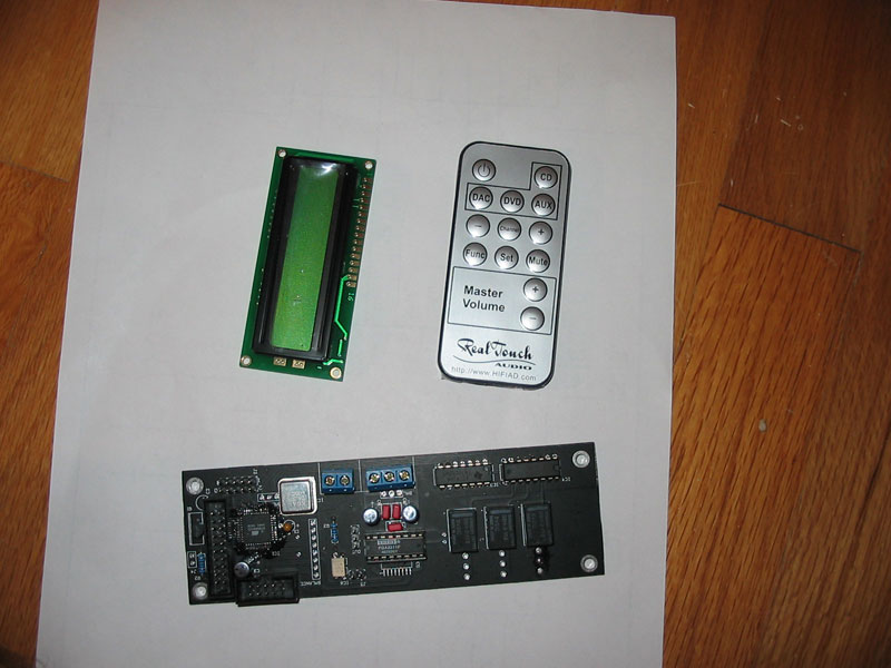

jleaman
I was wondering that would u be kind enough to let us know the source of this PCB, and if i m not wrong its based on AT89S8252 an 8051 based AVR?
I too have got almost the same board....

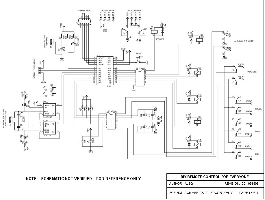

All,
Here is a REV0 schematic for reference. I have not had time to carefully walk through it so, it is not yet verified and may contain errors. That said, I wanted to post a REV0 schematic so that people could get an idea of the design and how the hardware fits with the code
Cheers -ALBQ
All,
Cheers -ALBQ
