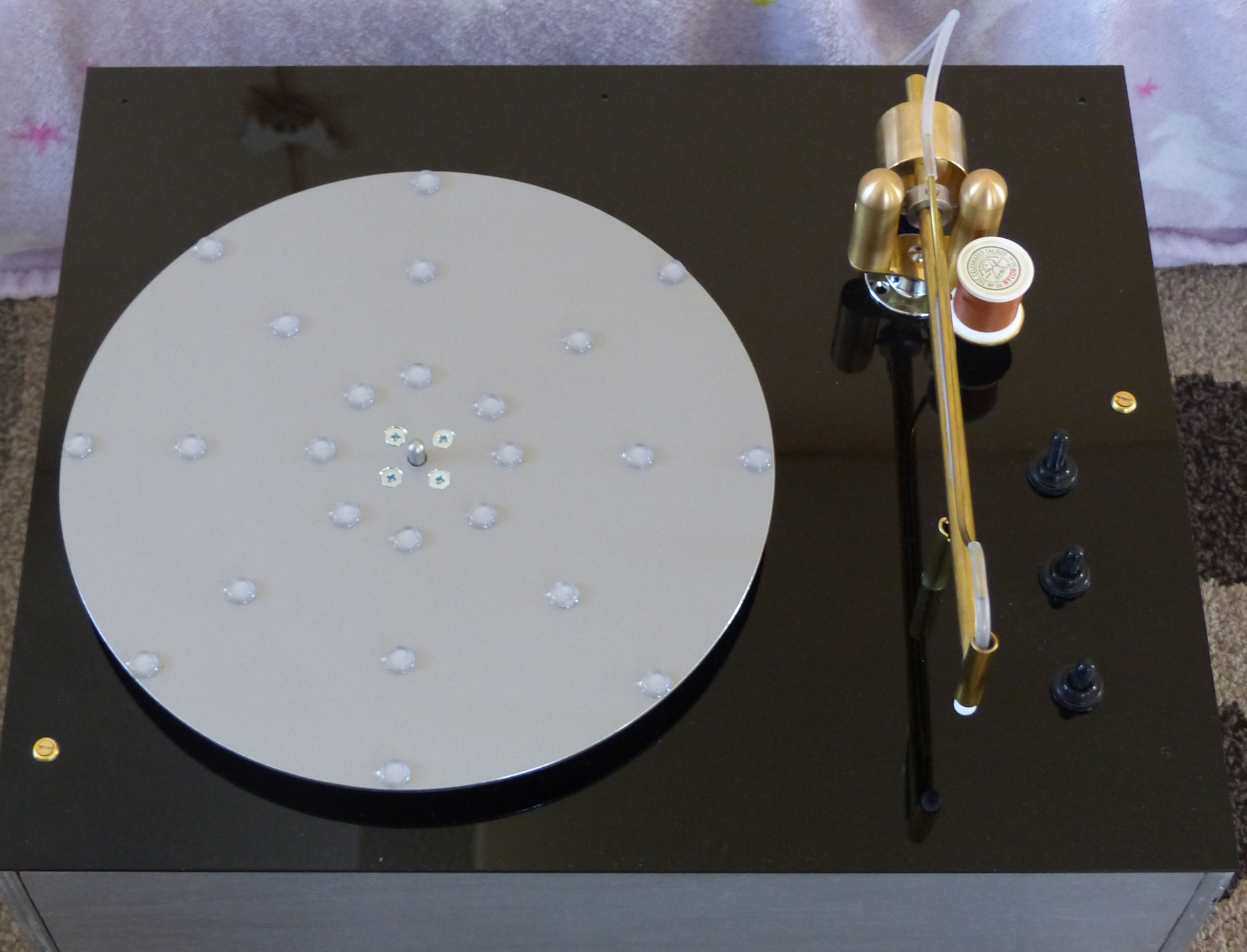

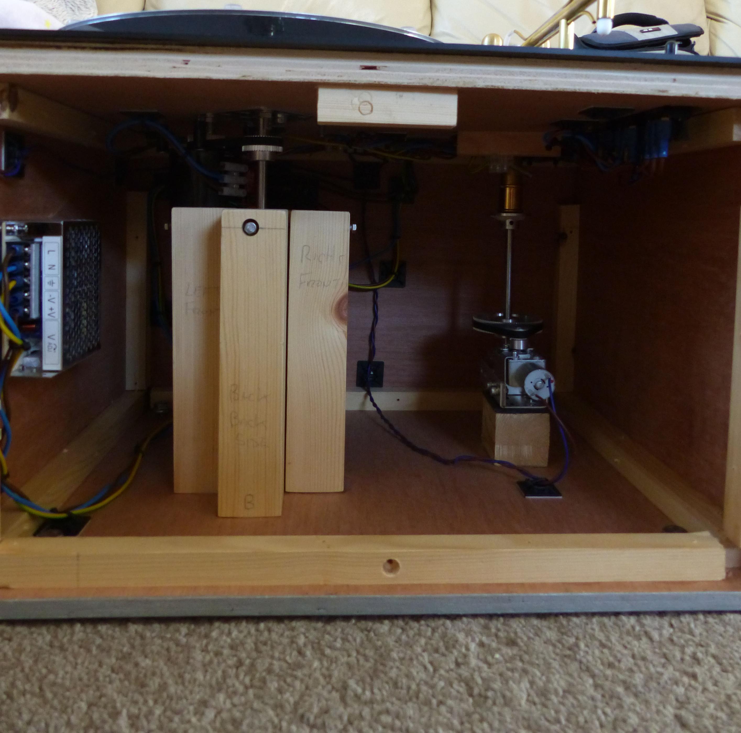

So, for starters there’s the case (box) made of 11mm ply and the top plinth made from 18mm ply with a 3mm black acrylic top.
Unable to find a suitable bearing and drive system that didn’t cost more than the entire project, I found a company called (Motionco) that supply small bearings, gears, Shafts etc., and as luck would have it a 300mm Turntable Platter.
Finding a suitable motor also turned out to be tricky, but I found one on eBay that is 230v and reversible and runs at 60rpm for around £19.00, the downside is that it starts to run hot quite quickly.
The motor drives the platter via a toothed belt and two 48 teeth gears (one on the motor and one on the platter spindle) The Platter drive shaft is 8mm diameter and has a bearing at the top and one at the bottom, The bottom bearing (and here comes Heath Robinson) allows for some adjustment of the shaft to allow it to run true to the plinth top.
The motor shaft also caused a bit of a headache as it’s 7mm in diameter, after a bit of head scratching, I found that some 8mm brass tube with a wall thickness of 0.5mm was a nice fit on the motor shaft, but a tight fit in the gear, I had to press it in with a vice, and not forgetting to drill a hole in it first to allow the grub screw to pass through to catch the flat on the motor shaft.

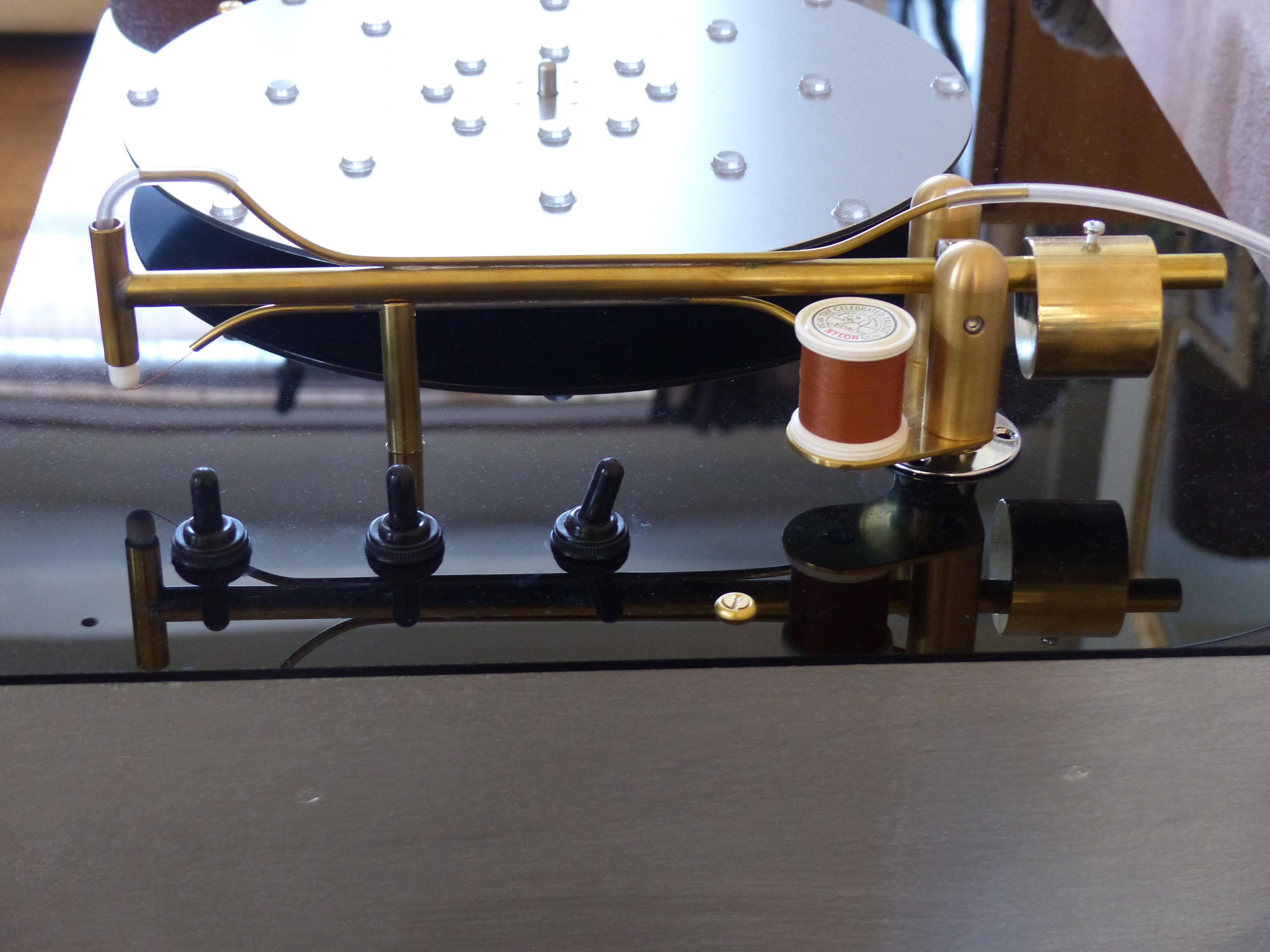

The Vacuum Arm is made from 10mm Brass Tube and approximately 12” long, with the pivot point at about 9”.
I filed a half round section on one end to accept the “T” piece, Filing it carefully so the two pieces butted together neatly also made it much easier to solder.
The Vacuum tube on the top is 3mm Brass Tube, as is the Thread Feed Tube on the bottom, and simply bent by hand (actually not quite so simple, It’s pretty tough stuff)… until I had the right shape bends and then cut and de-burred the ends for the correct lengths.
I used High Temp Caption Tape to hold things together for soldering, and also to stop any access solder running around the tube.
I was quite surprised how well the tape held up after being subjected to a blowtorch, any burnt pieces were easily removed with some fine steel wool.
The two pivot pillars, made from 20mm Brass Rod I had machined at a local machine shop, they put a radius on the tops, and drilled and tapped a M5 hole in the bottom, a hole was drilled in the side and tapped to accept a M3 Allen Bolt, the hole was recessed on the opposite side to allow the head of the bolt to be screwed in out of sight, A 10mm collar with a 3mm hole drilled either side forms the pivot point, the arm slides into the collar and is secured by a grub screw, which also allows some adjustment of the vertical axis.
The base is 2mm thick Brass Plate, cut and filed to the necessary shape to accept the pillars, Drive Shaft, and thread reel.
The drive shaft for the arm sits between the two pivot pillars, and is made from a 100mm length of 20mm Brass Rod (a bit overkill) but its weight and downward force helps offset the weight of the arm (before I had made the counterweight) and helps to keep it in a more or less balanced position through the Plinth and top and bottom guides, stopping it from pulling one way or the other if that makes sense.. ?
On the very bottom of the shaft is a 20mm Plain steel washer held in place with double sided sticky foam tape, which forms one part of the magnetic clutch.
The arm shaft drive is driven by a 1.6 rpm 12v motor, further reduced to a ratio of 10:1 using a toothed belt driving the two gears, the Gears, Belts, Shafts, Bearing Blocks and other construction parts were again sourced from (Motionco).
On the Larger of the two gears are two 20mm diameter Neodymium Magnets, One is glued to the top of the gear and the other simply sits in top of the glued magnet, the Brass Drive from the arm with the steel washer on the bottom then passes through a 20mm I/D Brass Sleeve and sits on top of the magnets, the sleeve prevents the arm slipping off centre of the magnets (something I did have some intermittent problems with) I also had random spots where the arm would slip on the magnets making the speed inconsistent, so I cut a circle of 2mm thick rubber and fitted it in between the steel washer and the magnets, and this seems to have cured the problem.

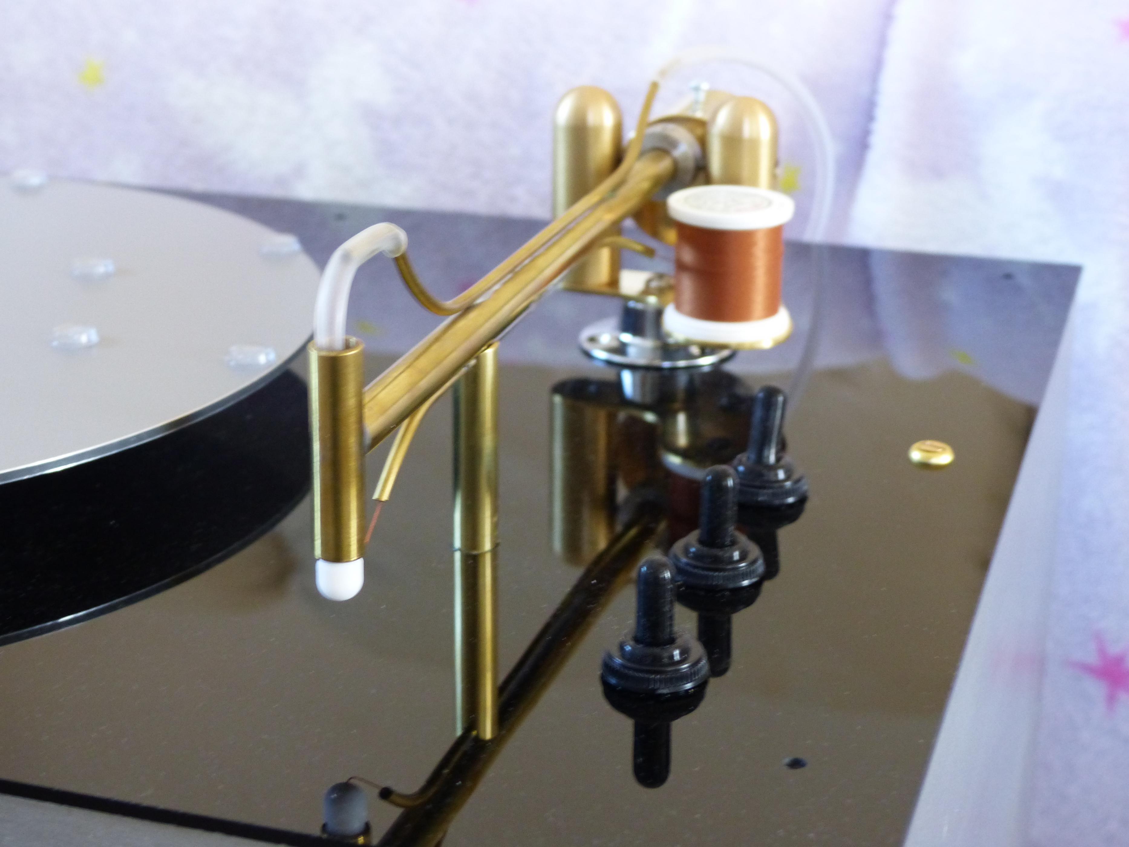

The Suction Nozzle: Is made from a piece of 10mm Round Teflon available from Ebay.
I started by cutting a length 10 – 15mm longer than I actually needed, I then drilled a 1.4mm hole through the centre (there a videos on You Tube showing how to drill a almost perfectly centred hole in a piece of round material using a pillar drill) I then opened up part of the hole to 1.5mm at the end where the silicone tube would attach, but not deep enough to affect the 1.4mm hole at the suction point.
I then used the pillar drill, and a medium file to turn down the part where the silicone hose would attach, Slow and easy … A medium file makes short work of this, I didn’t bother smoothing this part off once I had the correct diameter, as I figured it would allow the tube to grip better. Next to turn down the material so it would fit inside the Brass “T” piece of the arm, The inside diameter of the tube is around 8mm, so again, a small medium file was used to turn the material down just enough so that it was a snug fit inside the tube.
With those two parts done I could now cut the rod to the correct length and start to shape the Nozzle. This was again done using a file to get the basic shape, and then using decreasing grades of emery Paper to finally shape and smooth the nozzle tip, It was then washed in isopropyl and blown though with an air hose, The finished length is approximately 35mm.

When I threaded the machine for the first time, it pulled the thread through the feed tube no problem, I left about 6” of thread laying on the plinth ready to get it through the nozzle, connected the pipe, and turned around to switch the pump on, when I turned back I couldn’t find the thread, and then I realised that the vacuum had picked up the thread from the plinth, sucked it through the nozzle and threaded itself ! …Bonus…. The thread by the way is the original Talbot #30 Nylon Thread.
I do know that the pump will pull just over a negative 800mbar through the 1.4mm orifice and about 850mbar while pulling fluid off of the surface of the record.
The other plus side to this is the fact the arm has a VTF of Zero, Once ready to vacuum, the nozzle once placed on the record label will stay in contact under its own suction, and when it reaches the end of the outer edge simply floats off, so no risk of the brass tubing dropping down and possibly damaging or knocking the edge of the record.

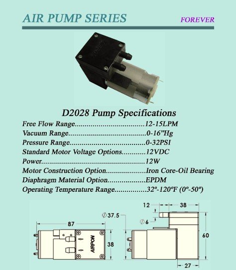

I have been looking at the cheap Chinese 5L/min oil less diaphragm pumps available on Ebay at around £11.00 delivered, I already have one and have another on order, I believe it is also possible to get them in 8/10/20 and 40 L/min sizes.
I did a bit of an endurance test on the one I have, one test at maximum vacuum at which it pulls about a negative 650mbar for about an hour, and again just pulling free air through a small inline filter. In both cases the pump housing and motor remained very cool, considering it was 35°C in my shed, pulling a continuous vacuum the pump housing was slightly warmer than when pulling free air.
Going back to pulling a vacuum again there was no degradation in vacuum pressure or motor / gear noise, so first impressions look quite promising for these cheap little pumps, albeit if they are a little noisy, but this seems to come mainly from the outlet / exhaust port, and by placing a small piece of foam around the port the noise is reduced quite dramatically, with no impact on suction. The downside is that one pump on its own will pull 0mbar through the nozzle and around 25mbar with the nozzle and thread placed on a dry surface.
I have seen two of these pumps used in series on some DIY machines, but my train of thought would be to use two in parallel, better still .. Two 10 litre pumps in parallel, this mode of operation could possibly give me the chance to run them at a lower voltage thus decreasing the noise, I think the motors are the same size just the pump heads are slightly larger.
So, how well does it work with the current setup?
The first attempts were performed on a few records that had just minor crackles in between tracks and quiet passages of music using l’art du son, the results were a little hit and miss, one area would be nice and quiet but background crackles seemed to have moved elsewhere on the record, after getting the same results on a few records, I realised that because the platter is only rotating at 60rpm, and the arm taking just over a minute to traverse the surface of the record, certain areas were getting missed.
Measuring the distance from the label to the outer edge of the record gave me a figure of 110mm, so to effectively cover the entire surface I reduced the speed of the arm to two minutes, this made a world of difference and while there was still the odd tick here and there it was a great improvement to the results I had been getting.
The records that I thought had been trashed by the ”permostat” I put on them back in the late 70’s early 80’s, (and I’m finding more and more of them as I work my way through my collection)The l’art du son just doesn’t cut it, and won’t remove it, so I mixed up a 1:4 bottle of Isopropyl / Distilled Water with a couple of drops of Ilford Ilfotol, and ran that, but this time with the platter running CCW, I followed this up with a rinse of plain Distilled water again with a few drops Ilfotol and running the platter CCW, and finally the LDS and again ran the platter in a CCW direction.
The difference this made was incredible, nearly every single tick has been eliminated, the run in track is silent, the Bass smooth but still punchy, snare drums have “snap” that almost makes you blink, and cymbals are clear smooth and sweet, it’s like the difference between night and day, and a far cry from the woolly, distorted, stylus gunking noise I had previously.
I’m not sure if running the platter in a CCW direction has made an improvement, but as I’m still dialling the machine in, I’ll try a few already cleaned records to see if there is any improvement to be made.
Last but not least, In an attempt to help keep any static down, there is a long weak spring that is connected to ground, and this is just in contact against the arm spindle, I thought that any static may travel through the wet thread and get discharged to earth, I don't know if this really works, but the records are or appear to be totally static free after cleaning.

Very nice work, diygazza! Re: the cheap pumps you are experimenting with; I used two, running in parallel, in my own thread-buffer RCM. It works well and met the pressure/airflow spec I’d found in researching the commercial machines. They are quite noisy though. I’ll give the foam-over-intake a try—I assume you used a very porous foam, like an a/c filter?

What sort of pressure do you get with two of these pumps working in parallel? I would have imagined somewhere around 200mbar just pulling free air through the nozzle. I actually ordered 2 12L/min pumps last night, but they won't get here until the end of July / beginning of August, at least that's the estimated delivery time. 🙄
Putting a small piece of foam over the outlet port just takes the edge off the noise, it doesn't work miracles, but it helps. I used a small piece of sound dampening foam I happened to have to hand, it's about an inch thick, so I cut a small square and cut a slot in it to slip over the outlet port and cable tied it in place, as I mentioned it didn't appear to affect the vacuum at all.

A spec sheet I dug up for these pumps ("Airpon D2028") gives a free airflow range of 12-15LPM (roughly .5 cfm). Running the pumps in parallel, in theory, should double that. I think the reality is that both flow and "pull" benefit, but flow isn't doubled. Still, experimentation showed I needed a higher flow rate than a single pump could provide, so I went with parallel.

The pumps are supposed to pull 12–15 L/min; I'll try to attach the spec sheet here. I got them from Sparkfun.
