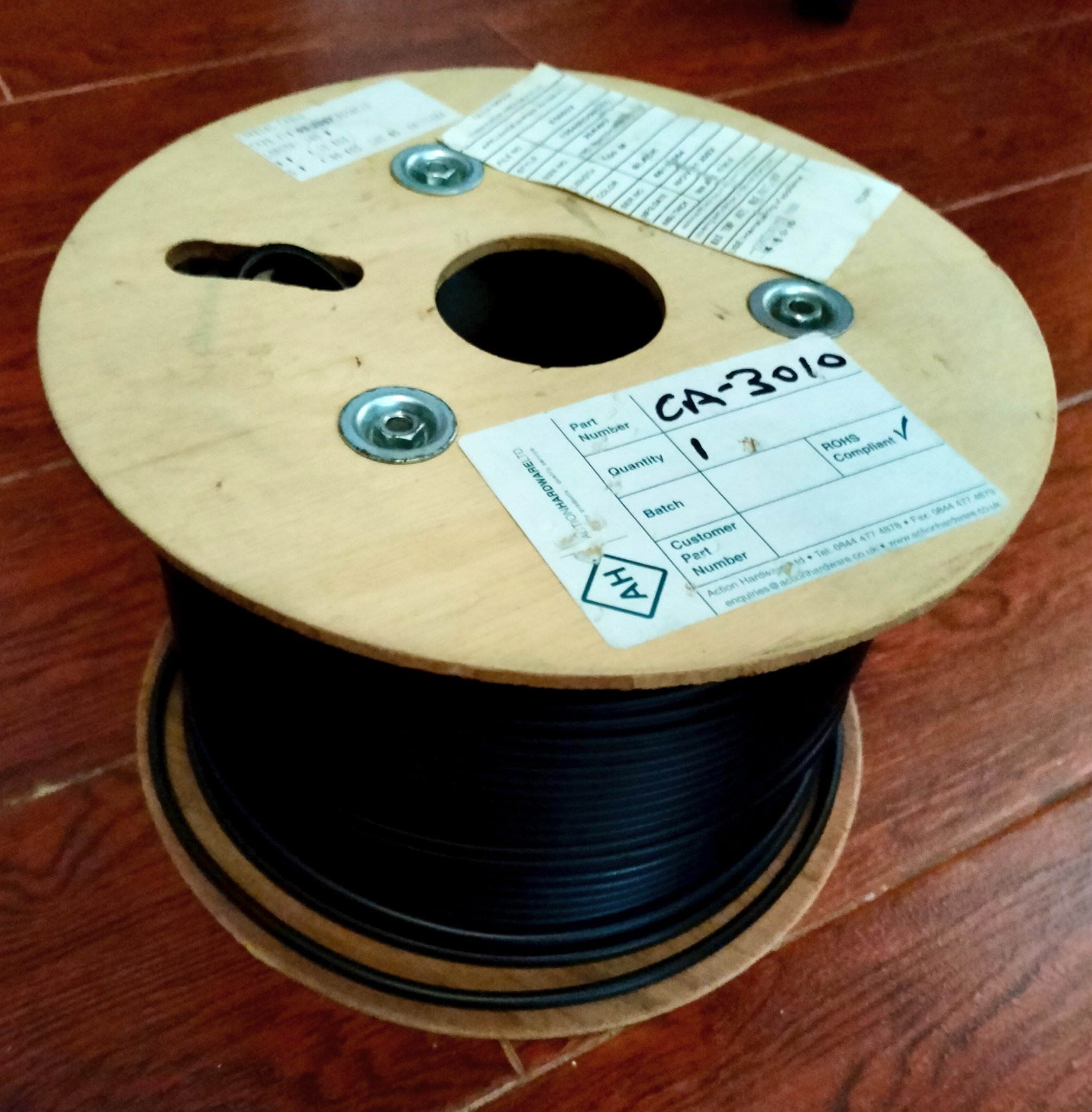

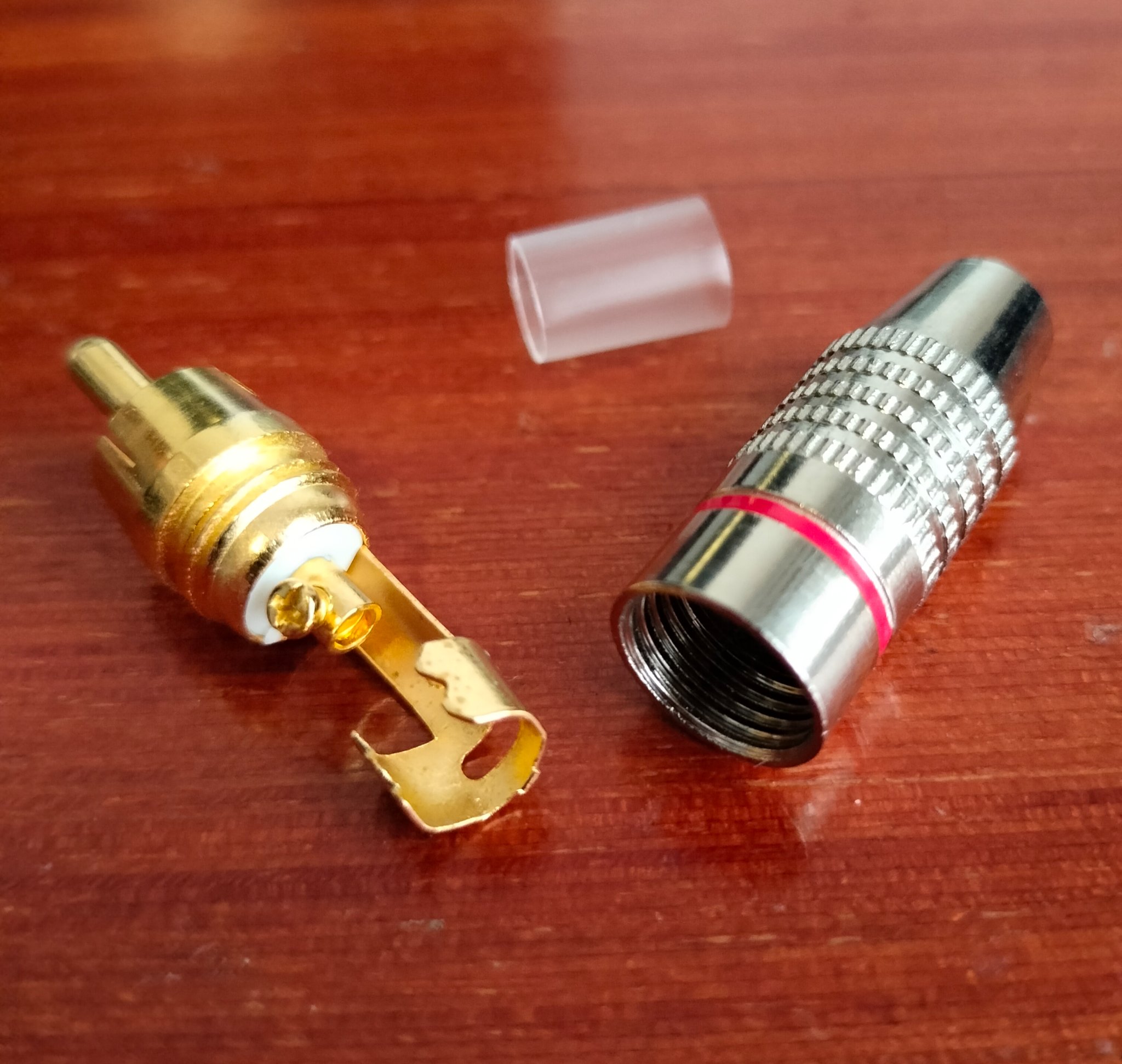

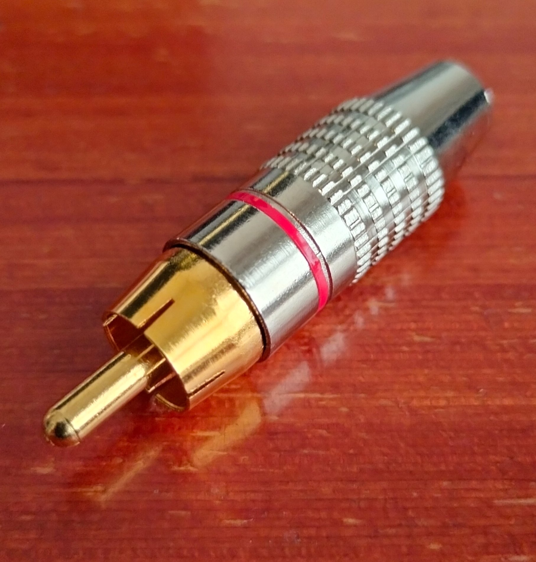

I prefer using pure copper to make cables. I need eight RCA cables where each cable will be 6 feet long. I am thinking of making the cables myself because I think it will be fun. Bought decent solderless RCA connectors and I have a whole roll of RG58C/U coaxial cable which I never used.
Just to clarify, I need the 8 RCA cables specifically for audio only.
A quick google search revealed the following about the cable I have:-
RG58C/U is a 50-ohm coaxial cable commonly used for radio frequency (RF) and low-power signal connections. It's characterized by its stranded tinned copper conductor, polyethylene (PE) insulation, and tinned copper braid shield. The outer jacket is typically made of black PVC.
Ultimately, is it better for me to purchase RG6 cable for better shielding and to avoid compromising audio fidelity? - not sure if there are pure copper versions of RG6.
I'm sure there are people on this forum who have deep scientific insight pertaining to this subject.

Deep scientific insight: Copper oxide is a semiconductor.
Copper oxide diodes were commercially made before germanium and silicon became commonplace. If air can get in and oxidise the copper, a semiconductor between the wire and the other conductor will introduce distortion. Soldered joints are gas-tight. You should be able to solder to those connectors. The trickier bit will be to make those soldered joints without melting everything.
Sorry if I disagree with the above, but as far as I know air cannot enter the contact between two metals when a joint is well crimped, and a screw in a connector perfectly approximates a crimping.
If the screw is well tightened air cannot enter the point of contact between the two metals, but only oxidize what is outside the joint if it is oxidizable.
As far as I know, a well done crimp is the best possible way to join two metals in both electrics and electronics, but it is not always possible to implement it instead of soldering/welding.
In the case of the OP I would keep the RCA plugs as they are and as suggested by @NIXIE62 I would change the cable.
As you're in the UK have a look at HiFi Collective. https://www.hificollective.co.uk/ You'll find lots of ways of becoming poor, but also some silver plated, multi strand, screened cables and suitable silver plated connectors. Silver is the most conductive metal. Various other plating materials are more to do with appearance than function. I always solder joints.
For basic interconnects I use https://www.hificollective.co.uk/wire/interconenct/van-damme-1.html which is a mix of copper and silver, with a good shield and it's flexible and not too thick and the price is very good. There are single and twin conductor versions. Or https://www.hificollective.co.uk/wire/neotech-nei-4020-up-ofc-silver-plated-interconnect-cable.html for a little bit more money. And go up from there.
For RCA plugs, I've not found better than: https://www.hificollective.co.uk/connectors/rca-plugs/xhadow-reference-small.html But you don't need these, obviously, but as an example the conductive parts are all copper with silver plate, non-magnetic.
Sorry if I disagree with the above, but as far as I know air cannot enter the contact between two metals when a joint is well crimped, and a screw in a connector perfectly approximates a crimping. If the screw is well tightened air cannot enter the point of contact between the two metals, but only oxidize what is outside the joint if it is oxidizable.
Agreed as far as it goes, but plugging and unplugging the connector provides a mechanical disturbance that can move the pin and eventually loosen the contact between pin and screw, allowing air in. This is a well-known problem in UK domestic power outlets, where the gradually loosening connection over the years causes an increasing series resistance.
Also, metals under pressure gently creep. Copper is probably better than most because it work hardens. My reel of RG58 has a stranded tinned inner conductor and I have a deep suspicion (no evidence as yet) that my crimped BNC test cables onto RG58 will not last as long as crimped BNCs onto a cable having a solid inner conductor. If it wasn't for the fact that assembling a traditional BNC having soldered pin takes three times as long as a crimped BNC and the connector is far more expensive, I wouldn't use crimped BNCs.
