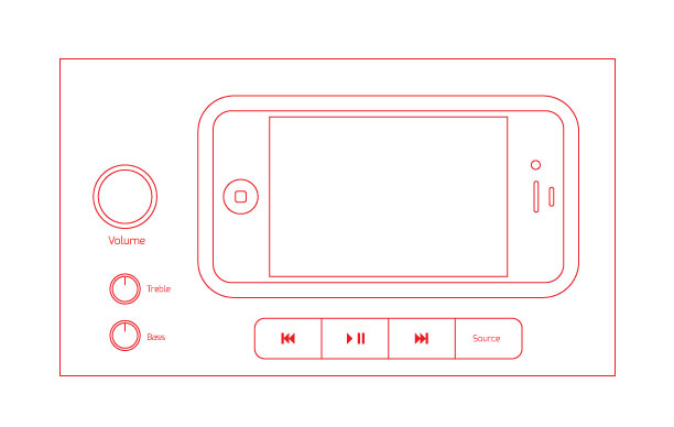

By the way, here's a quick sketch of what I plan on doing with the iphone mount.
Since I won't be getting a replacement HU, there will be a double din hole on my dash where I plan on designing a faceplate mount. Here's a quick sketch of the design, something simple with analog controls.
I'll probably have the faceplate either cnc'd or lasercut out of a plastic sheet or maybe even plywood.

I don't plan on getting another head unit... I wanted to make enough room on my dash for my iphone mount.

I appreciate your concern with the drawbacks but I have thought about doing this for quite some time, and would really like to pursue this.
For about a year I have even used a cardboard cutout of this design, pushed my headunit backward inside dash and placed the cardboard mount over it, and it worked well for daily use. I just never had the chance to make it more permanent until now.
As far as the iphone's music interface, I used phoenix3200's Music Controls Pro (when my iphone was jailbroken, but there is a similar interface for nonjailbroken iphones called TuTuneMe) which is pretty slick and easy to navigate. And as far as sources go, I normally don't use my CD or radio... as soon as I hop in the car the first thing I do is plug my phone in.
I also currently use a Griffin AutoPilot for charging, lod audio and tactile music controls. I plan on hacking it up to fit the new dash mount design.
I have also seen many many different head units that have the iphone mount. Most of them either do not fit iphones with cases or they are a couple hundred dollars more than what I'd like to spend. And most importantly, I love to DIY so why not make my own custom dash mount?
