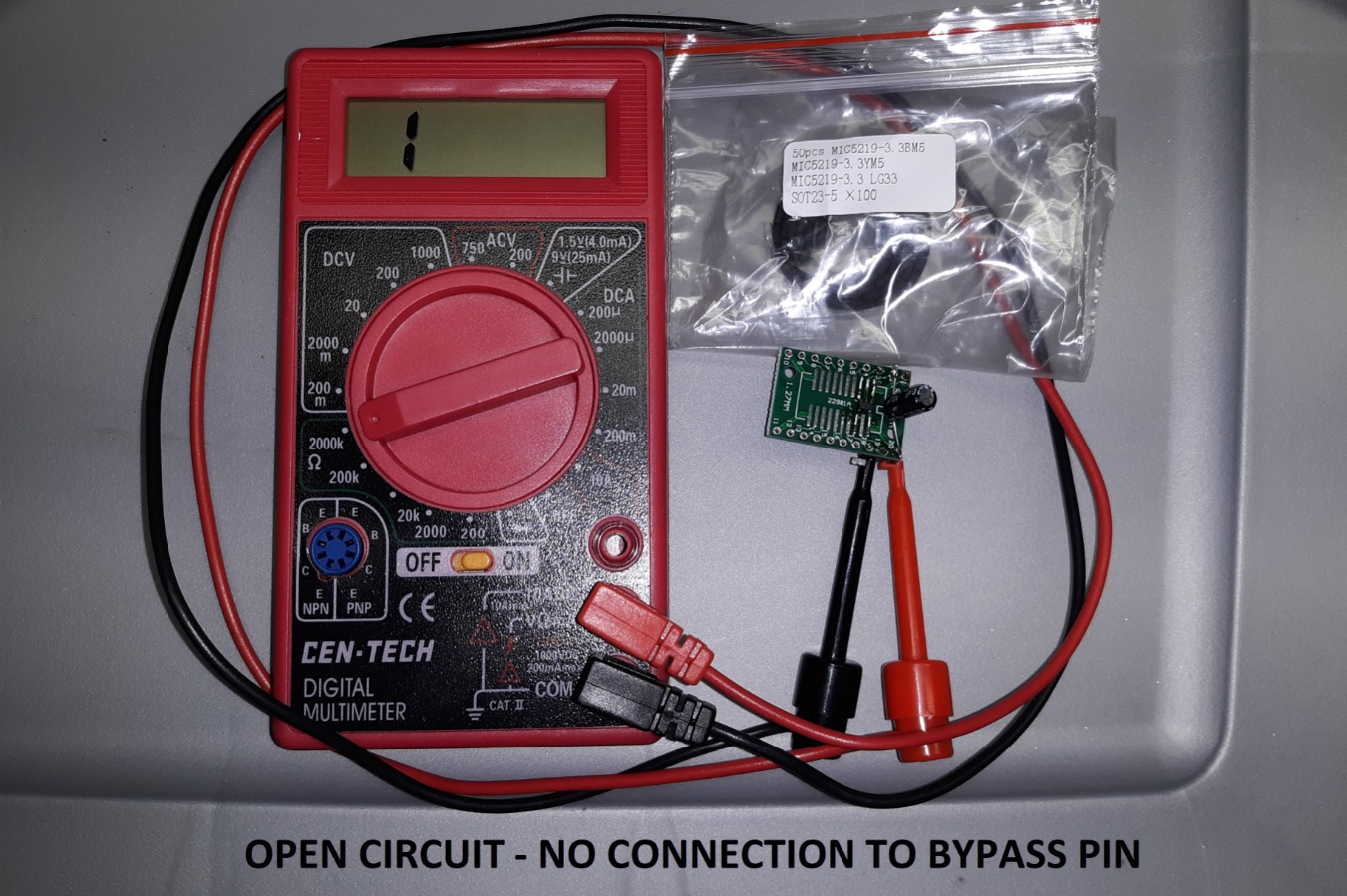

This message is intended for those who are not already aware that there are fake low-noise regulators on AliExpress, eBay, etc.
These fake regulators “work” as basic regulators but are not low noise and do not meet the specifications. In other words, cheaper regulators are packaged and labeled to appear as more expensive ultra-low noise models. Since they regulate the voltage most of the users will probably be fooled unless they employ sophisticated tests with an LNA to determine that they are not really the ultra-low noise model they are supposed to be.
In this case they are faking these models of ultra-low noise regulators: MIC5219-3.3 MIC5219-5.0 MIC5205-3.3 MIC5205-5.0.
Since they are faking these less expensive and less known models, I would be shocked if they were not faking the more expensive and better-known low noise regulators that have more demand and higher profit…

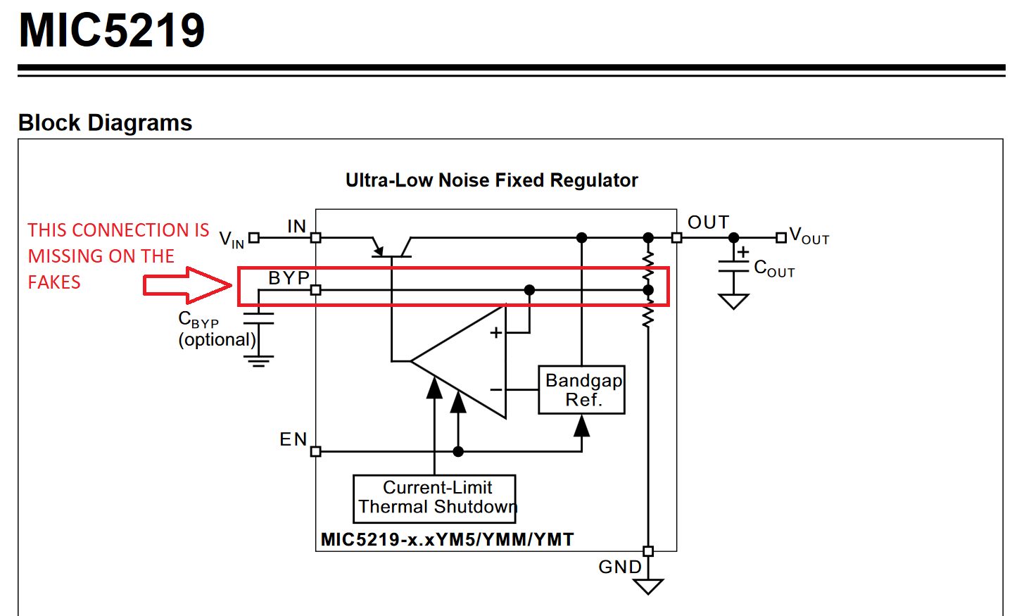

The photo shows an example of the fake “MIC5219-3.3” model. A real MIC5219 has a bypass connection to lower the noise. On the fakes there is no connection to the bypass pin. The seller was one of my most reliable online sources. (Reliable based upon extensively testing the products received.)
When these are not fakes they are often used as low noise supplies and references for high performance ADC and DAC such as where they are seen inside the E-MU 1616m and 1820m recording interfaces.

Certainly seems to be the case unfortunately. I thought that little known part numbers might be safe, especially ordered from a seller which had been reliable in the past.Aliexpress=fake

It is interesting to note what the sellers do when fakes are reported.
In the case of these fake regulators the seller was shown how to verify that they are fake with simply an ohm meter reading from the output pin to the bypass pin. A photograph was provided of the very simple test. It is very easy to see there is no connection to the bypass pin and thus these are not the marked model/part number. The test takes seconds and can be performed with the cheapest of voltmeters.
The result? The seller continues to sell them. That says quite a bit.
