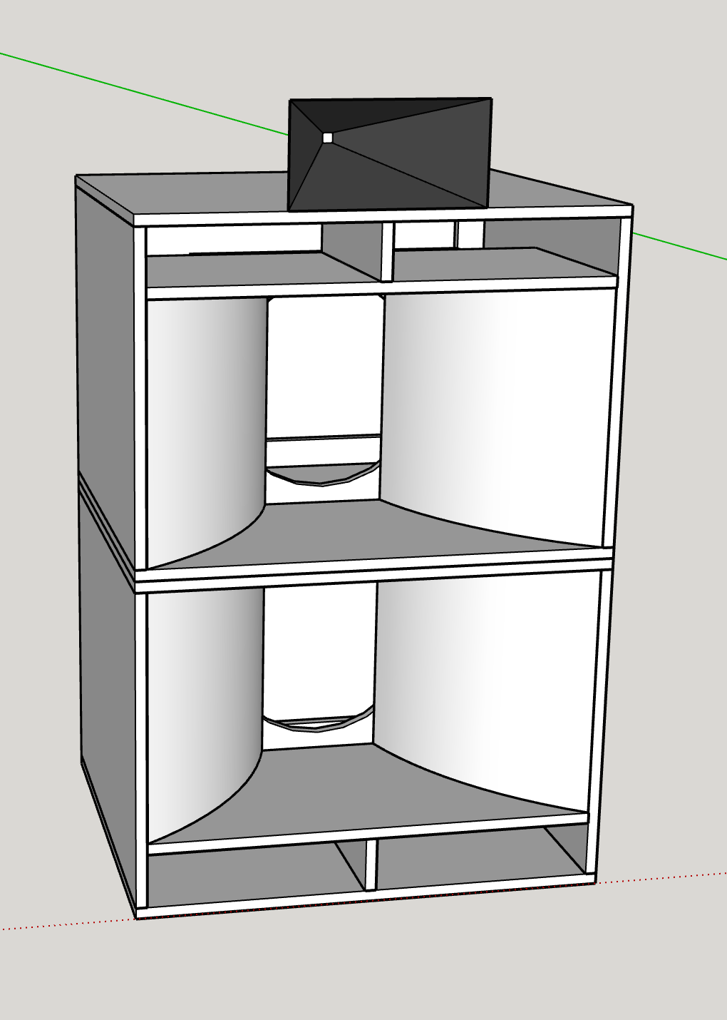

The speakers are a 2-way, almost 3-way design; in the images I included a scheme of the crossover which is basically a HP filter @ 2kHz for the compression driver, a LP filter @ 2kHz for the first woofer and a LP filter @ about 350Hz for the second woofer (JBL doesn't give exact values in their spec sheet so I tested this just by hearing).
-the compression driver is a JBL 2412, 1" exit compression driver (mounted on a JBL Progressive Transition™ Waveguide)
-the woofers are both JBL M115-8A 15" woofers
So I think I would design this setup as a three-way system with
-one 15" JBL M115-8A woofer LP filtered at 350 for the bass cabinet
-one 15" JBL M115-8A woofer LP filtered at 2 kHz as a midbass cabinet
-the 1" JBL 2412 compression driver for the high notes
In the image in the attachment I suggest how this could look like (note: this is just a quick sketch I made on top of a cubo15 sketchup file, nothing serious), I have been inspired by DIY soundsystems for dub and reggae music as they also have to be cheap and loud with a lot of bass.

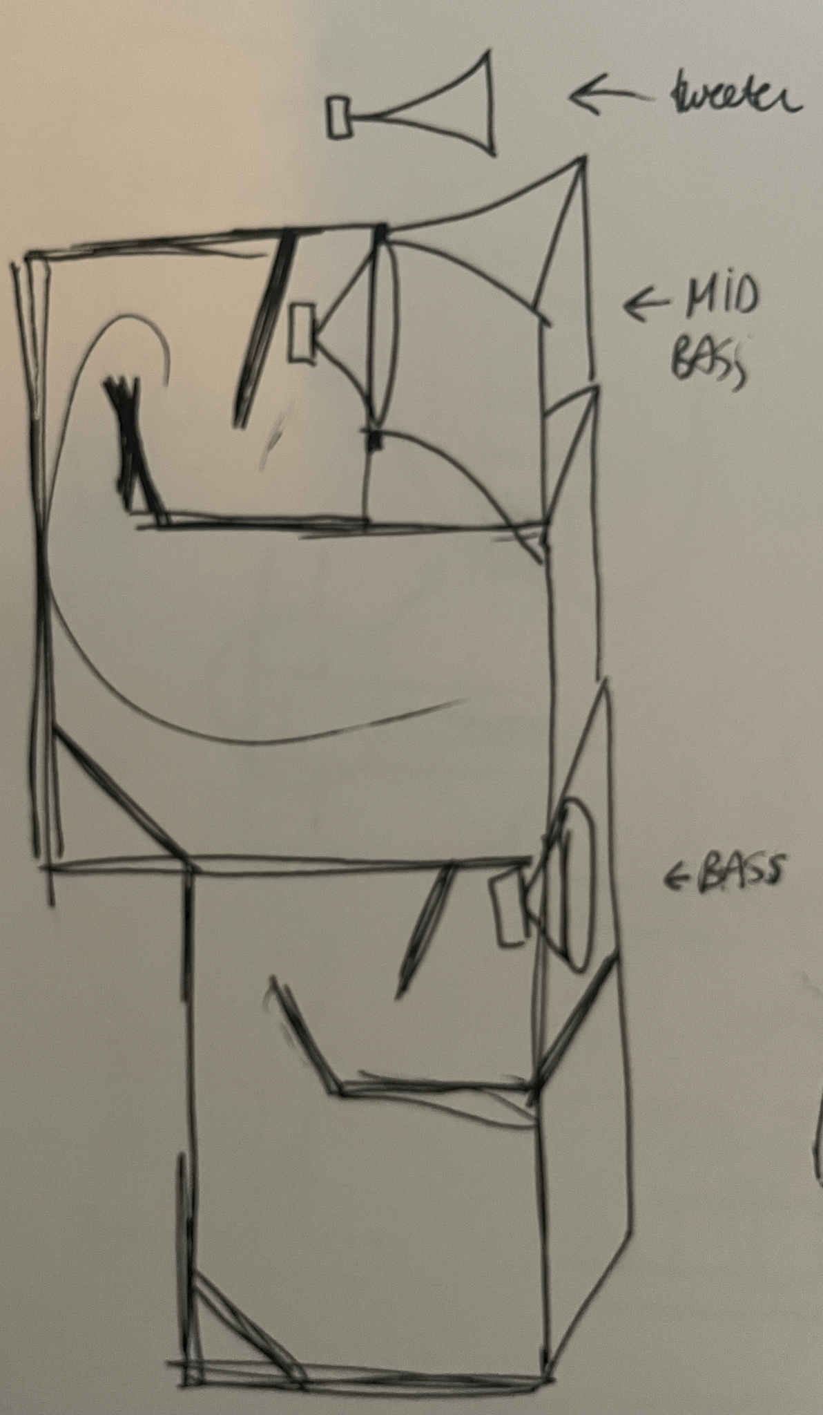

In the first image you have a bass horn at the bottom and a mid/bass horn in the middle. This makes aesthetic sense but may create some challenges in the 2.5way configuration.
1. If the lower bass is dependent on the two playing together, and one produces deeper bass and one doesn't, the system will now begin to roll off where the upper one begins to. If you equalise it, you'll be bringing up the level of the deeper one and the headroom will now be reduced.
2. If you use cabinets with different lower bass profiles for the two woofers in a 2.5 way system, they may be out of phase and partially cancel each other.
By the way how comes that these front loaded horns partially cover the driver

Thank you for replying! That makes totally sense to me as a different horn length of the two will indeed impose a different delay on both bass producing units. So logically I would need to have two horns that are the same but that is not ideal for either the midbass woofer if I make two bass horns (they are not usable for higher frequencies) and also not ideal for the bass woofer if I were to make two midbass horns (they are not efficient for the lower frequency).
1) Would there be an ideal way where I design it this way
-for the bass driver that is low passed at 350 Hz: a backloaded bass horn
-for the midbass driver that is low passed at 2kHz: a backloaded bass horn (same bass profile as the one above) and a frontloaded horn on the same driver that amplifies the mids?
2) Or are you suggesting I should move the midbass horn to the back relatively to the lower bass cabinet so that the delay is solved in their distance so that BASSHORNlength = MIDBASSHORNlength + relative distance

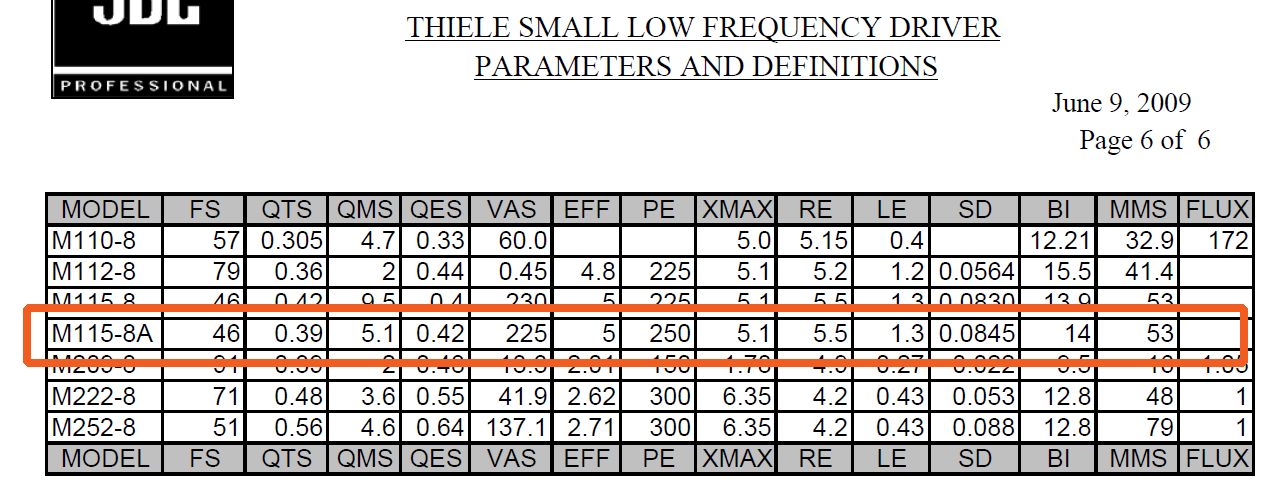

I am still searching for solutions, I just found out the JBL m115-8a drivers have an MMS of only 53 grams which is pretty low compared to other drivers. How do I take that into account choosing a horn design?

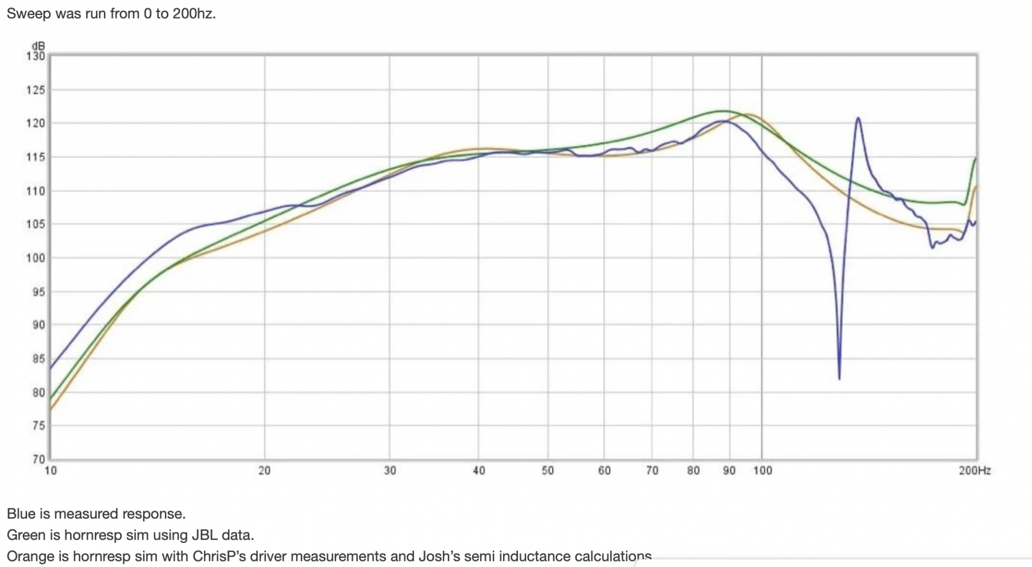

-The JBL devastator makes a huge drop @ around 130Hz (image in attachment) but nobody in the thread seems to care about that, is this not a problem?
