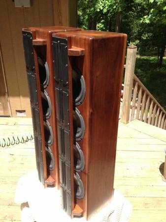

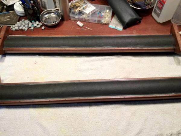

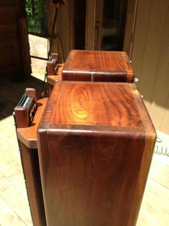

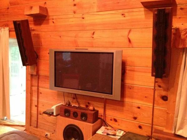

Its been done - Locally this pair was for sale. 2g for everything - I'd have just got the speakers - if he'd sell just those - except I wasn't intersted in a Home theater set of speakers. These are mids and highs only, and the sub handles the lows. If he had made em full range and a floor stander I'd all be over it.

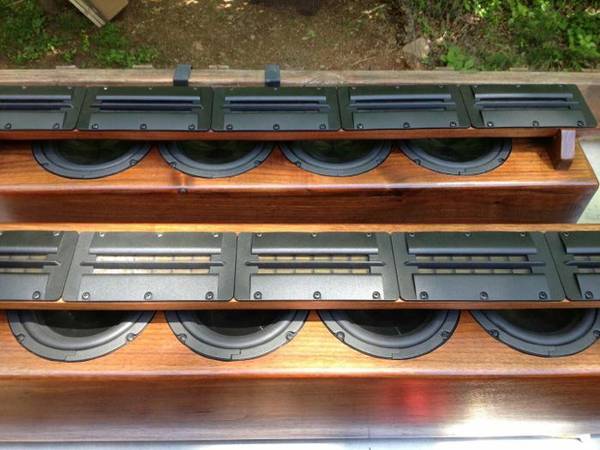

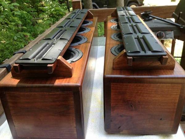

I typically use planar or ribbon drivers like these in vertical stacks of 4 or more units per side. A stack of 4 can be connected in parallel/series so that it yields a resultant impedance which is the same as the impedance of a single unit (6 ohms in this case).

Don't think of spacing with the ribbons, think about cramming them as close together as possible. Experiment with crossfiring angles between 90 and 120 degrees, decide where it sounds best to you. If you can measure, great. However, your ears have the final say. I'll let the more educated folks take it from here....
