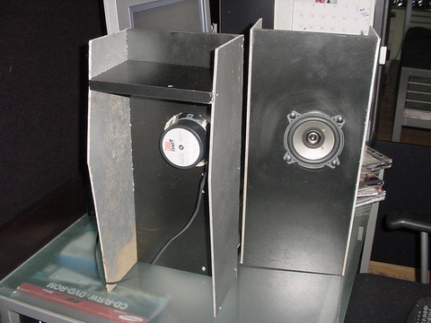

Hey...
I'm interested in creating some small portable speakers.
They will be run off a small tripath amp (2x25wrms @4ohms) through an ipod shuffle.
I understand obviously i'm going to have to compromise somewhere, and in this case it'll probably on lower end extension for portability.
At first I was thinking of just buying a set of cheap 4" car component speakers (tweeter, woofer, xover) but I figure I might's well as you guys what to do before I get anything.
I was now thinking a pair of 8 ohm 4" drivers, and a small 4ohm tweeter per side. Ultimately I'd like final impedence to be 4ohms as to get the most from the amp.
I was considering mounting these open baffle, just a small baffle with a stiff wire mesh around front and back to keep the drivers protected.
Couple of requirements I have...
All up the drivers can't cost more then about $50 AUD (+$20 if i feel it's worth it).
Also the drivers must be easily available in Australia...
Anywho, any help would be appreciated.
Cheers.

I am listening to these right now as I type. I would go with the best 4-6" car drivers you can find (used if possible) for your $. You may be suprised by how good they end up sounding OB. You could also hinge the side wings so that they fold over the drivers front to protect it when not in use. Then fold back when in use.

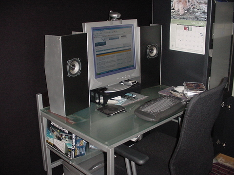

I've been thinking, hinged walls that fold behind to protect the driver, and grill mesh over the front to protect the cone...
Those NS3-193-8A's look awesome, and have more xmax then any speaker < 6" i've used! but i'm worried that they're too inefficient and we'd end up pushing the amp too hard.
How do the NS3-194-8E sound?
They're slightly cheaper and would probably run 2 of them per side, if postage isn't too bad.
I can't seem to find any "decent" 4" speakers for ~$10 AUD each nearby, so a pair of car splits might be on the cards (although 6" or bigger == bigger baffle == less portable).
Cheers

I've been following your power thread on 41hz.com as well. I'd have a good look at the 2'' full range Aurasound. I just built an iPod speaker system with the Sonic Impact T-amp and a pair of the 2'' full range Aurasound's. I'm QUITE surprised at how well it sounds. It's as loud as I have any desire to play music. My wife loves it for it's compact size and portability. These little 2'' speakers can fit in a super small box. Sure your not going to hear much below 200hz, but it's portable, what should you expect? I highly recommend this setup for the iPod.
