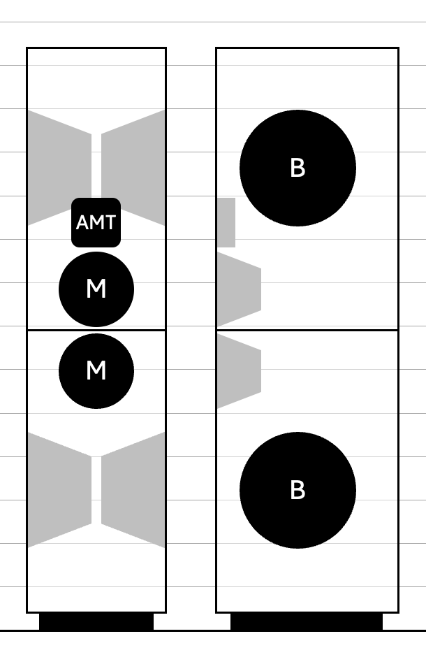

I am planning to build an active 3-way loudspeaker. I would like to use four side-mounted woofers (10 inch), two midrange drivers (6.5 inch) and an Air Motion Transformer as a tweeter.

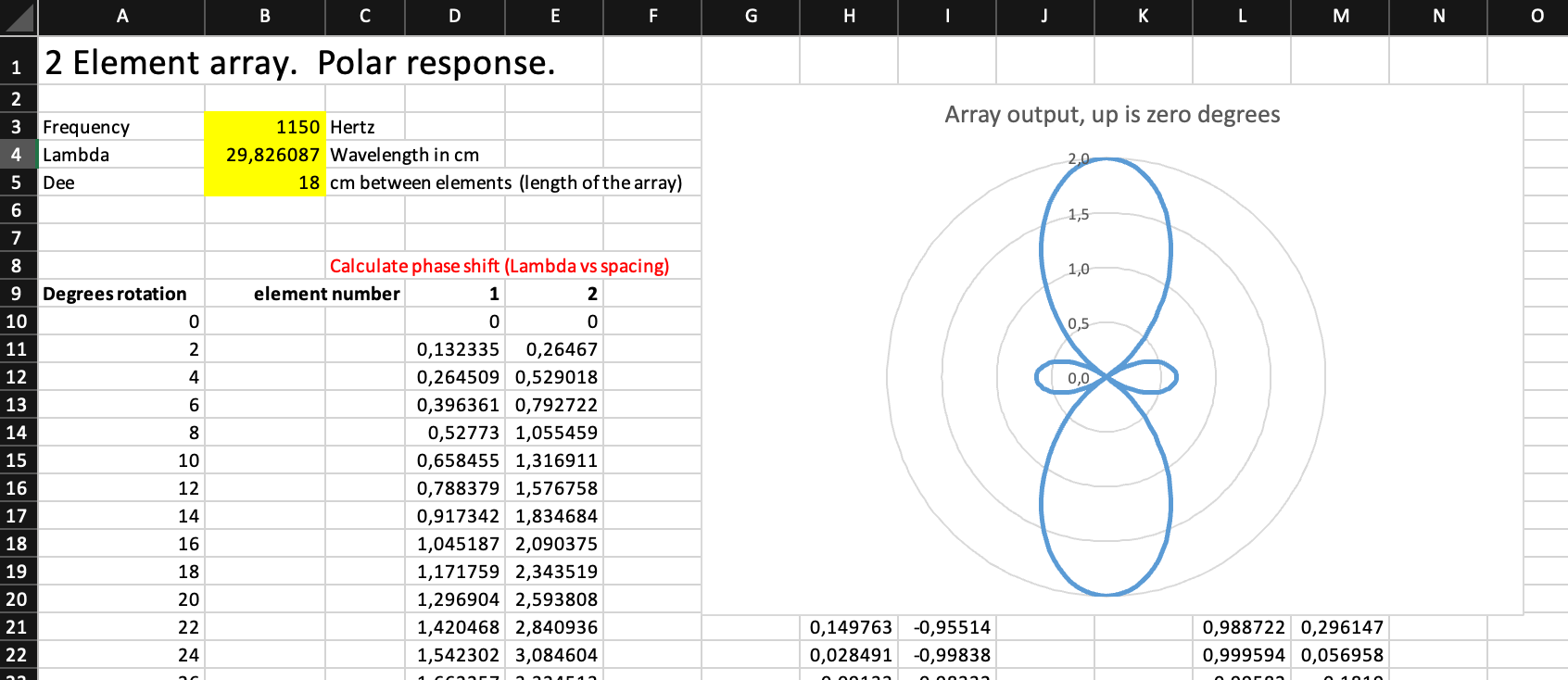

Everything sounds quite normal, but why two midrange drivers? I would like to have a wide horizontal dispersion, but a strongly focused vertical dispersion. To achieve this, I don't want to use the “classic” M-T-M arrangement, but bring the two midrange drivers closer together and place them directly above each other (about 18 cm distance between the centers of the drivers) and place the AMT directly above them. Due to its design, the AMT already has a strong vertical directivity with a wide horizontal sound dispersion.
I plan to use crossover frequencies of approx. 80-100 Hertz and a fairly low 1150 - 1200 Hz. My own calculations based on Excel templates from the forum have shown that a crossover frequency higher than 1200 Hz could cause problems with unwanted lobes in the midrange.
I have not yet completely decided on the drivers. I have the following favorites:
You can find a very simple concept sketch of the speaker from the front and from the side in the attachment. B = Bass, M = Midrange, AMT = AMT 🙂. I am thinking about dividing the loudspeaker in two cabinets per side to make it easier to handle. The thin lines in the back have a recurring distance of 10cm. Hence, the loudspeaker would be around 135cm high.
I would be very interested to hear what you think of this concept and what suggestions and ideas you have for improvement.
Thank you and best regards
Klaus
Klaus

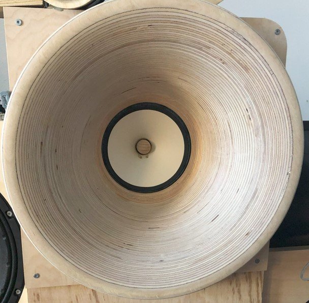

in addition i want to mention that there is another approach to control directivity with a (need to be quite large though) wave guide also for one mid range instead of the use of two in woofer - tweeter - woofer placement
here a small example of what i have used for testing some times ago with a 8 inch Sonido mid range driver, here the front horn has no difference in vertical to horizontal directivity here the main goal is to reduce the cone excursion in the low mid range frequency range
so far - so good, Stefano
