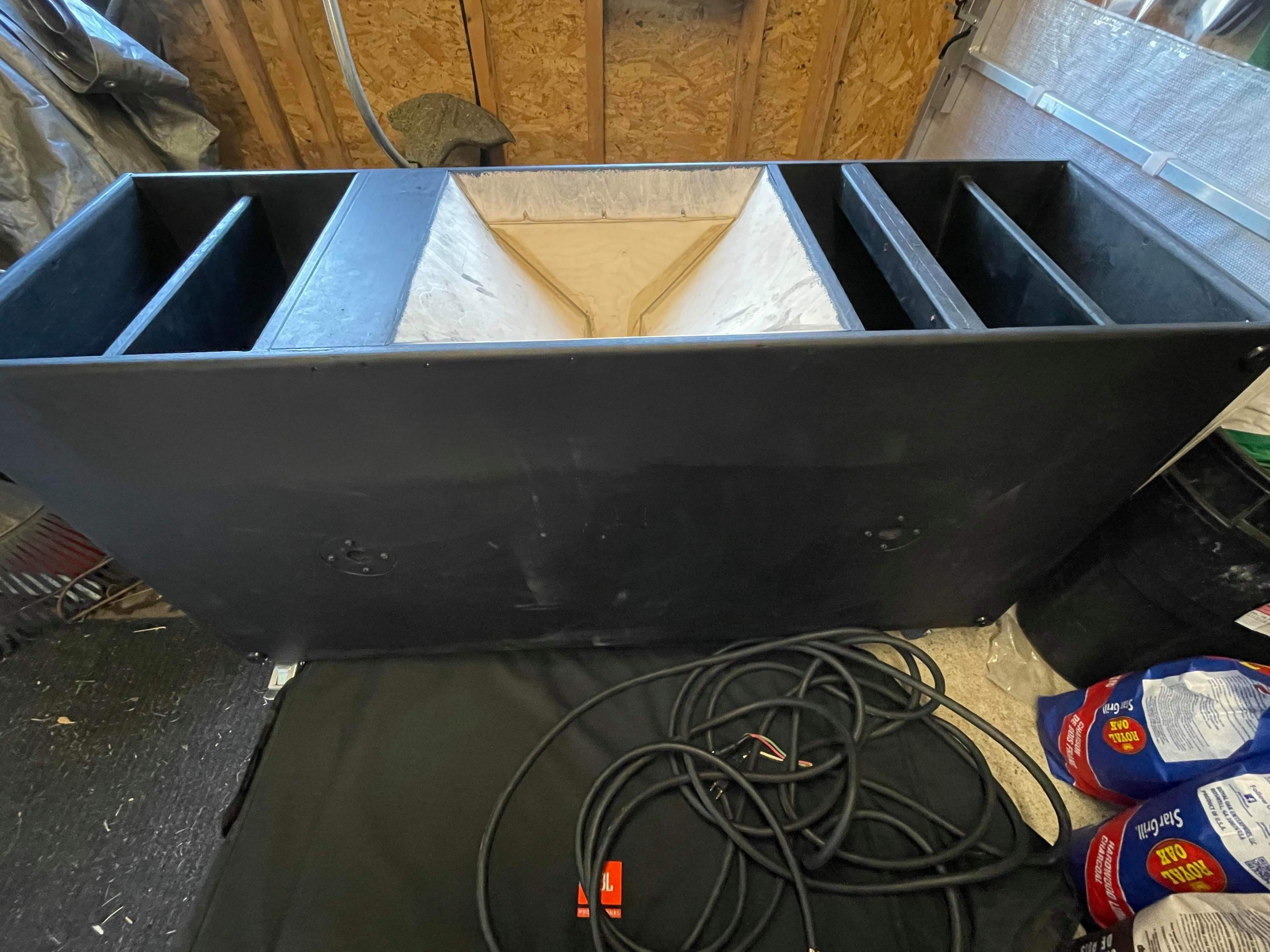

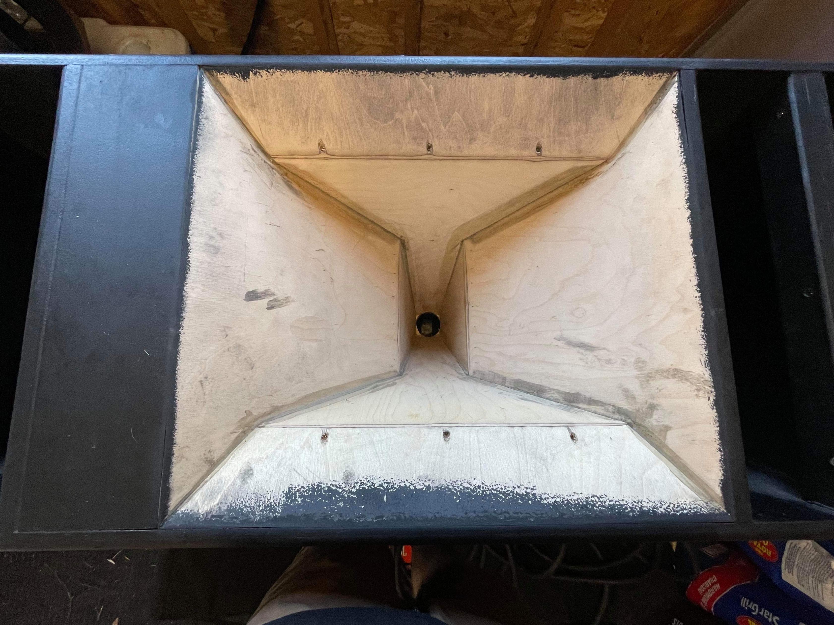

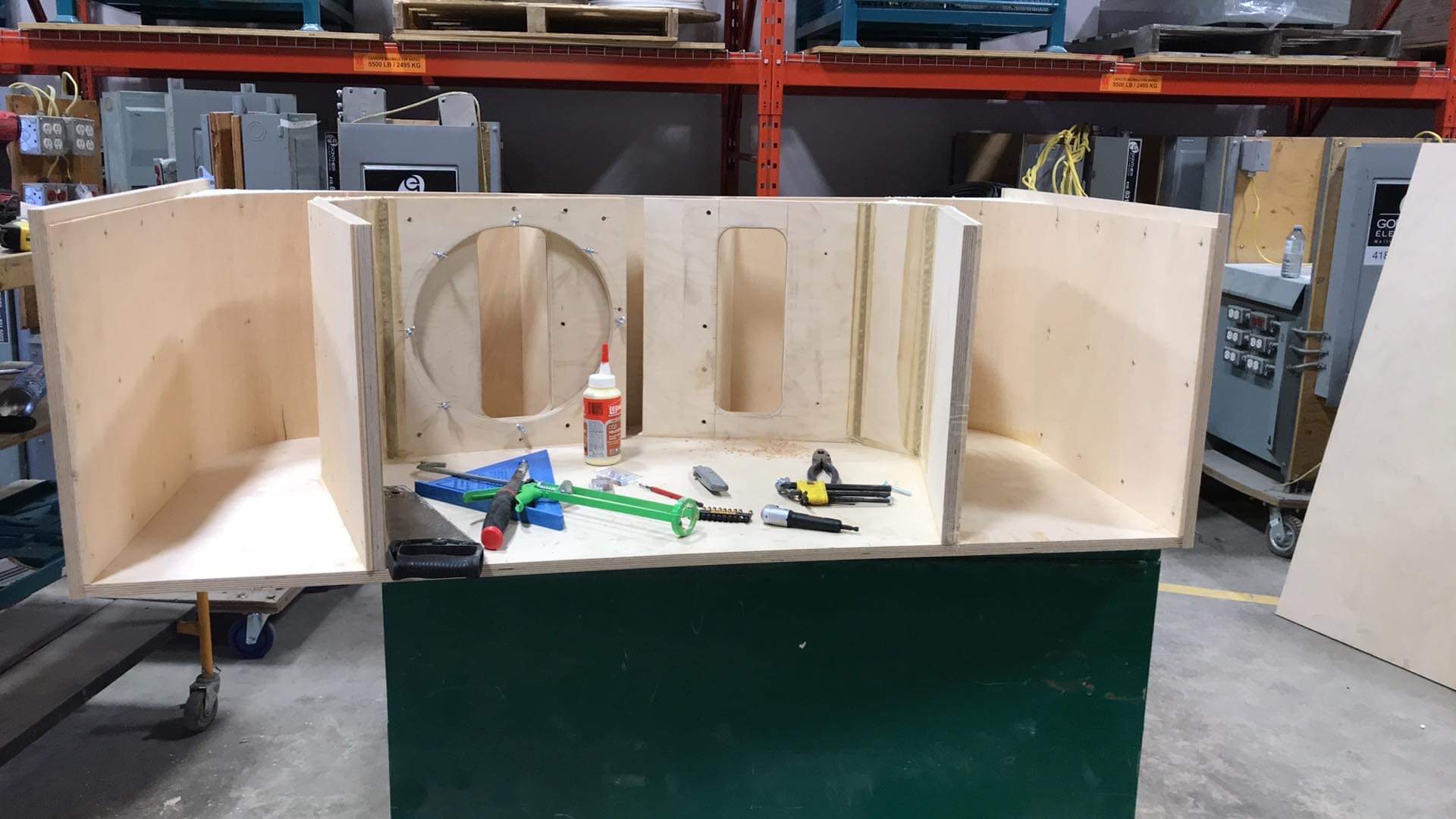

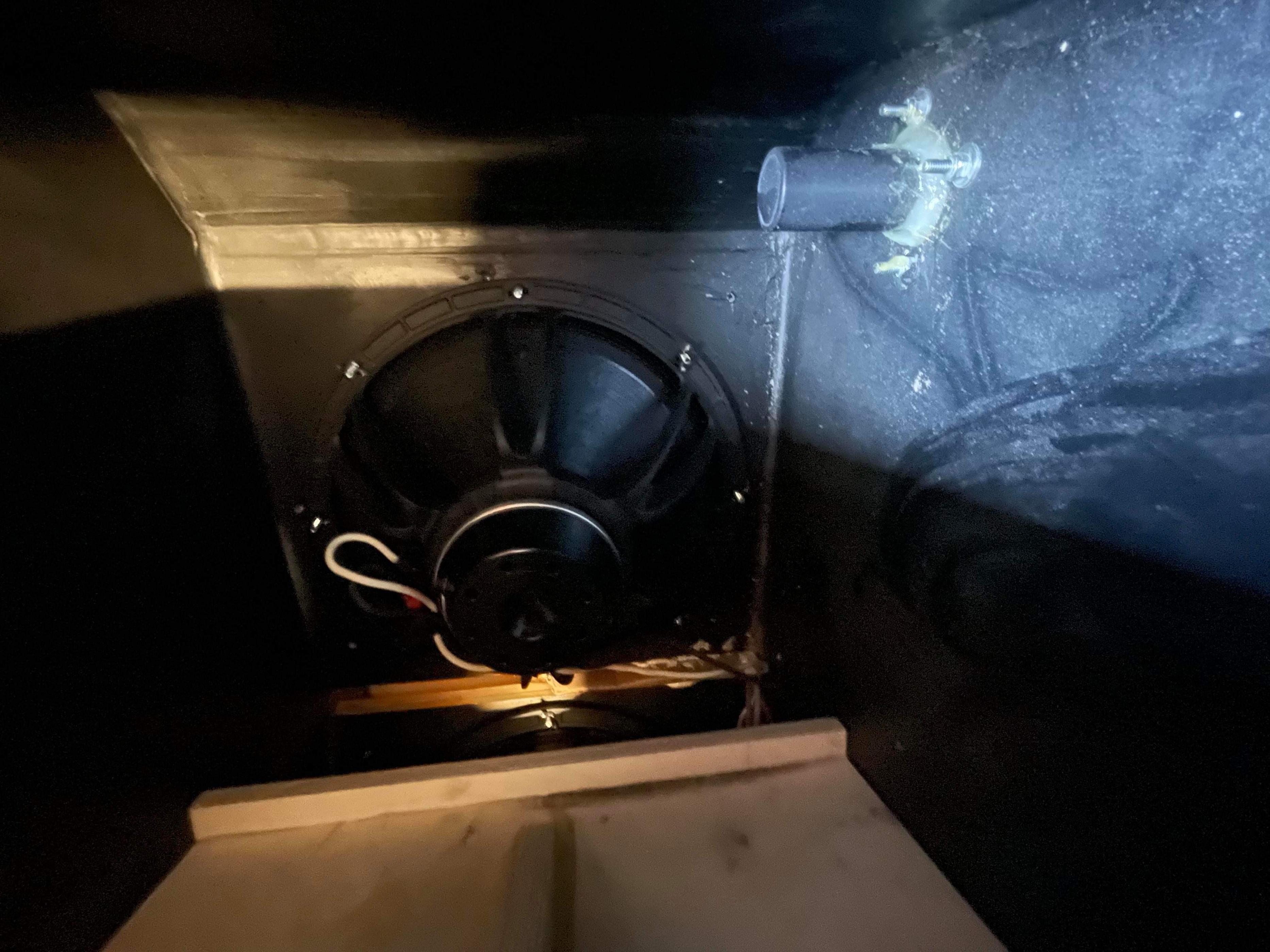

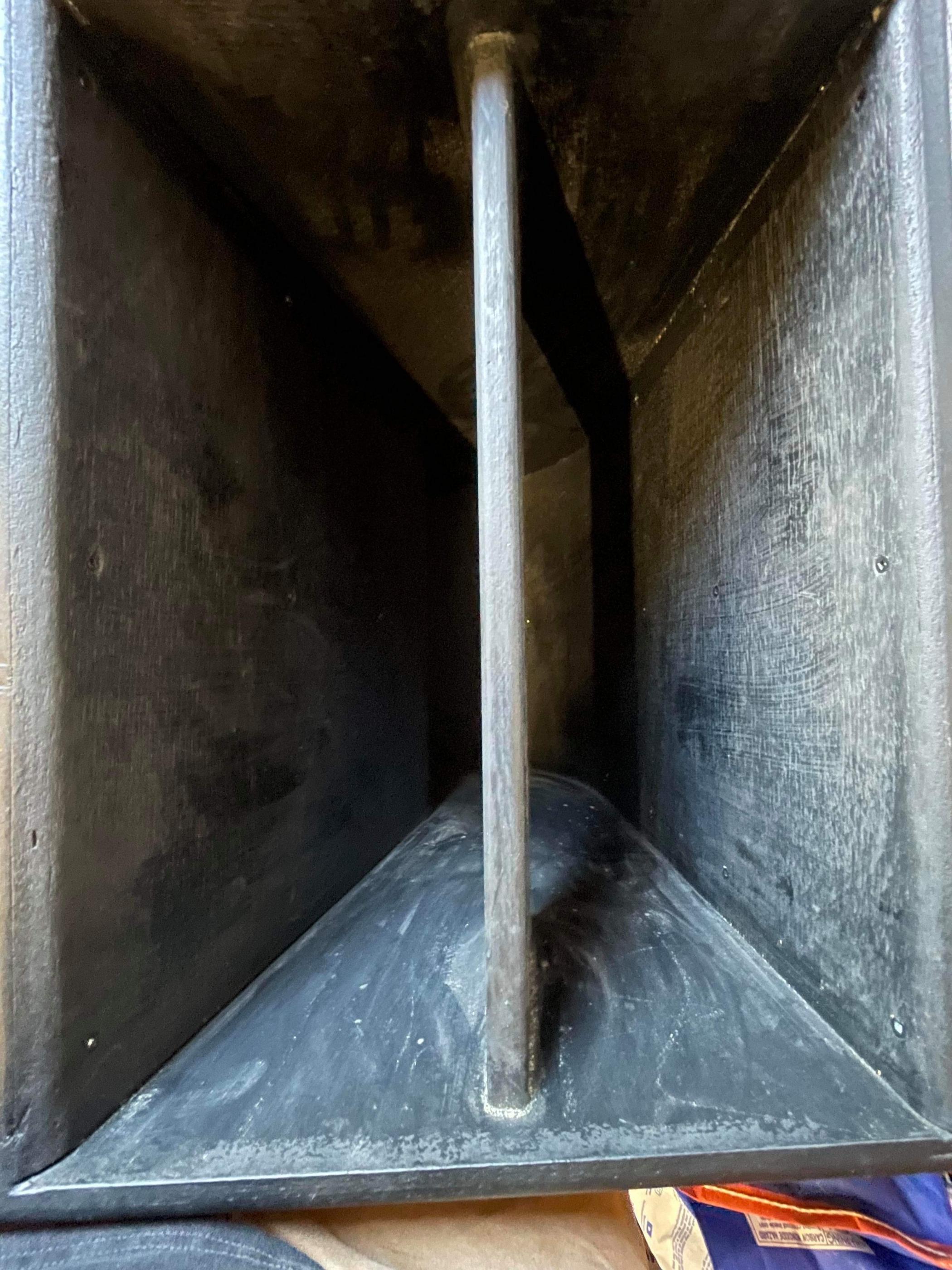

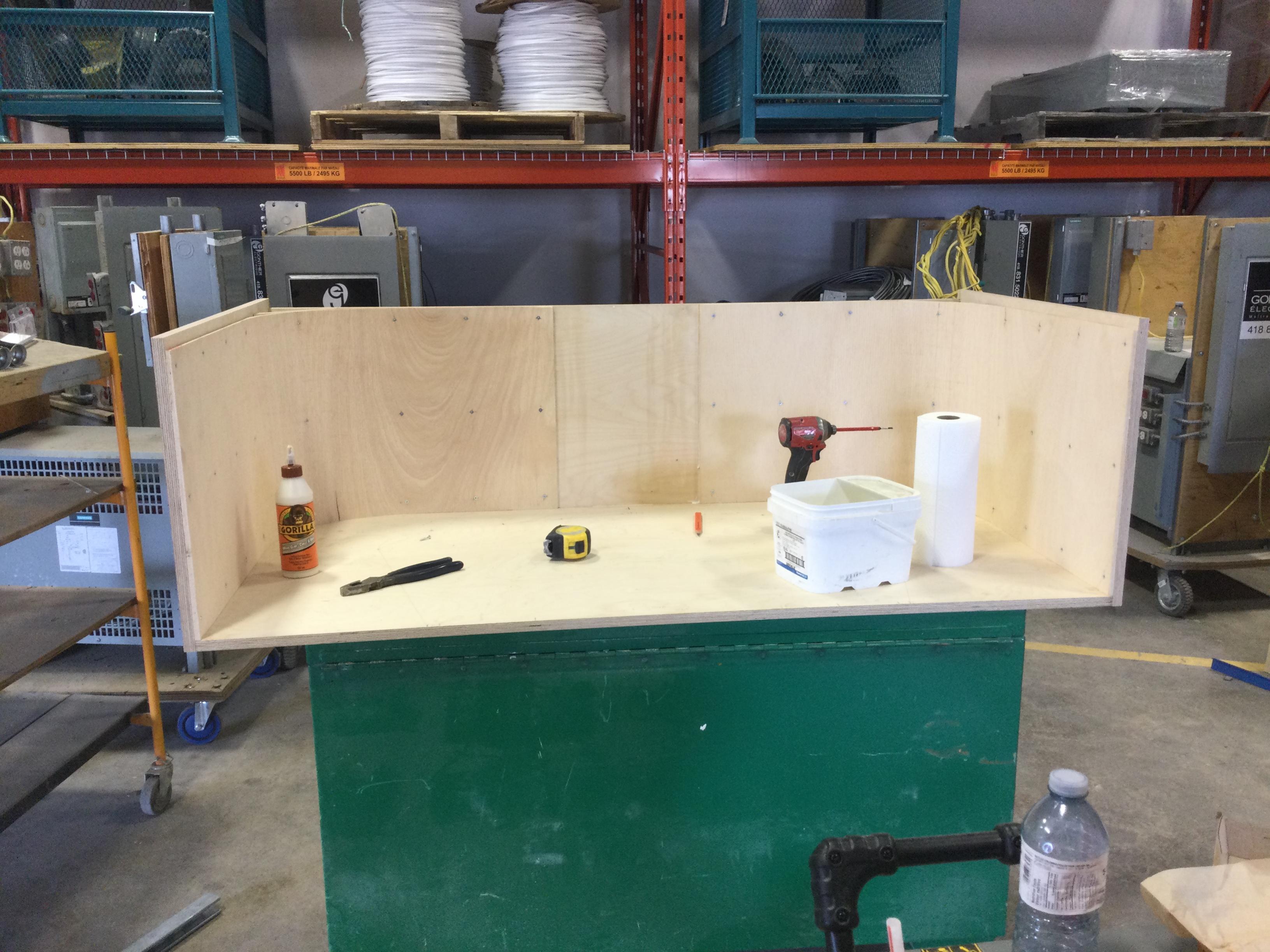

Hi everyone. I’ve been building a high end PA system in the past few weeks. Ultimately it’s more or less a copy of the pm90 but using bigger driver. Instead of the 12 inch woofer I’m using 2 15 inch B&c 15nw76. I’ve also decided to use a bms 4599he coupled with 4 ciare ct440 super tweeters. I’m still waiting on my bms 4599he as it’s being build, but almost everything is done except for a few touches. I have been contemplating a few ways on how to mount the 4 super tweeters. Given the limited space I have left, I was thinking of just mounting them one on top of they other. The only problem I’m running into is, coverage. Ciare has not shown it’s of axis response nor its coverage pattern. So coverage might be limited if it’s all on the same horizontal axis. On a side note, I’ve built a 90x40 horn for the bms 4599he. So ultimately I would want the coverage pattern on the tweeter to be quite similar. Any suggestions? Additionally, I’m not exactly sure of the built quality of my horn for the bms4599he. The horn sensitivity is obviously a big concern as it’s meant for pro applications. It also need to be able to play at least down to 650hz where it will be crossing with the 15inch woofer. Any suggestions would be much appreciated. Thx

"Bullet" tweeters like the Ciare ct440 have progressively narrowing response as frequency progresses upwards, I'd expect response similar to the JBL 2402, about 40 degrees at 10kHz.

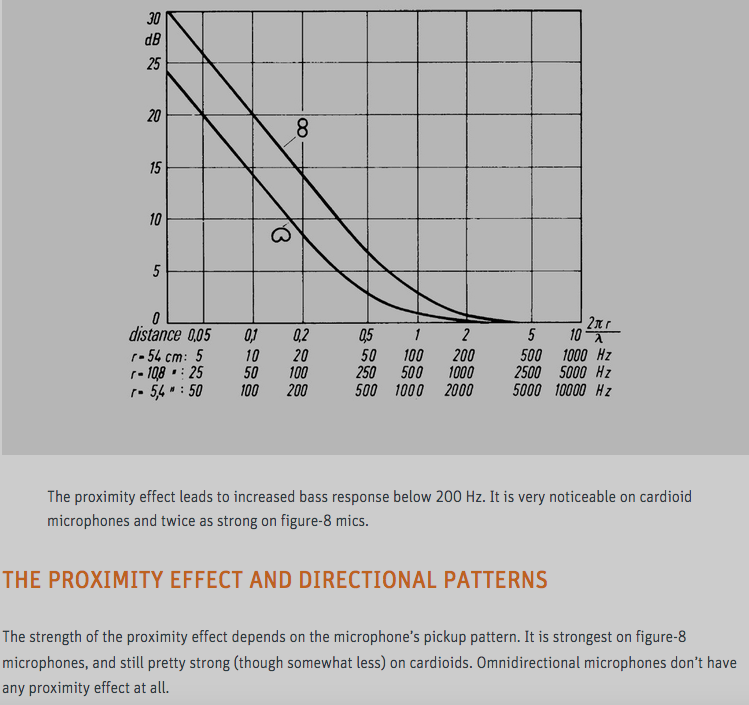

I'm going to test a 2 way speaker outside. I intended to put the mike a meter or two out front of the drivers, centered. I don't want to hear any reflection from the parallel board fence 40' to the right or the hum of the exhaust fan at the bar 800' in front of the speaker. I was going to use a cardioid mike.

Indianajo,
Cardioid microphone response varies with proximity (distance) to the source, not appropriate for speaker testing.
A cardiod mic at an appropriate testing distance (meters) will have severely reduced low frequency response compared to a centimeters distance.

Thank you very much. Eq wizard does seem like a really good software especially for free. Similar response to the jbl 2402 makes a lot of sense. If it was your build what would you do? A sort of j-shaped arch for the tweeters could be interesting. But I would also have to point at least two tweeters to different sides for optimal horizontal coverage. Say first one at the bottom straight pointing slightly down. next one up to the left (not exactly sure of the angle yet), and then the third one up to the right (would have to be at same angle as the previous one) and last one straight forward. What do you think?

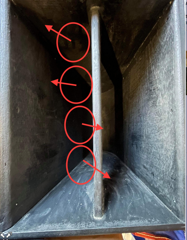

Michael,
If it was my build along your design parameters, I'd have chosen a co-ax HF driver rather than separate mid-hi horns.
I'd also arrange the cabinet in the opposite orientation, so the low output horn exits are above and below the high output, rather than side by side.
Any array of multiple devices without constant directivity throughout their pass-band and not originating from the same virtual point source will be a compromise in the placement of peaks and nulls, "comb filtering".
Assuming you are still going with the same orientation as depicted, a sort of "barber pole" vertical tweeter arrangement mounted on the inner bass horn stiffener would probably be as "good as it gets" in an attempt to match the mid horn's dispersion.

Thank you very much for your help. Would it be worthwhile orienting my speaker vertically instead of horizontally? If I do so, I would have to re do my exponential horn as the coverage would no more be suitable. I’m a bit confused Regarding your idea for a barber pole inside the inner bass horn. Wouldn’t it be best if the tweeters were closer to the mid range horn in the middle, rather than on the side in the mid bass ports for the 15inch woofers? I suspect that the pressure coming out of these horns would distort the sound? On the other hand, this got me thinking of maybe trying out another way to couple the bms 4599he with the 4 tweeters. Would it possible to design a synergy horn (would be placed in the middle where I already have a mid range horn for the bms driver). The bms 4599he would still be place right at the apex of the synergy horn, but the ciare tweeters would be mounted on each corners of the synergy horn in a way so that it matches the same dispersion. You also mentioned using coax compression driver instead. I’ve actually thought about doing this. My only concern was output. The extra output of separating both drivers to me seemed to be worth it as Im trying to use only a pair of speaker to replace a stack of line array. Ps I really appreciate your help. This is actually my first pa speaker project. Me and my brother have been working on this build. It’s more a goal of mine to make my own speaker.

When building this speaker I was inspired by this design.
