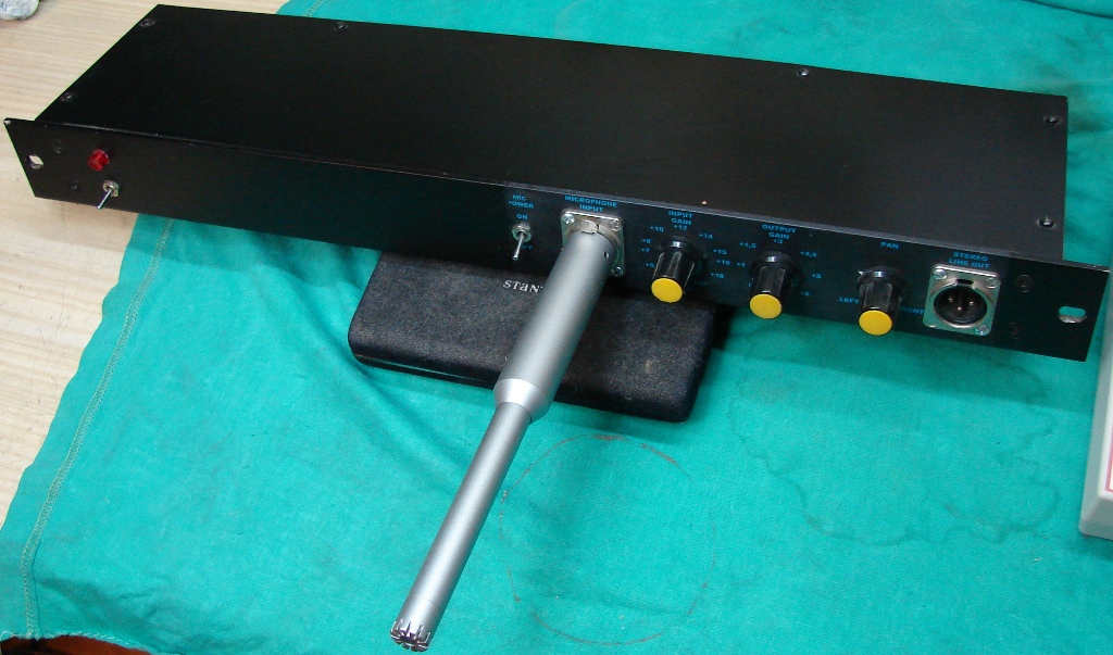

This is exactly what you need and much more. Do It Yourself, like me. I had the same need like you before 3 years. The cost it is around 30Euro (included the chassis). This mic. preamplifier except that it offers the correct phantom power for the ECM8000, with the addition of a simple switch can accept as well dynamic microphones and offers a stereo output; you can use it as well as mono via the pan-pot (balance) taking thus the signal either from the left or right output. I have the full documentation of construction, as well its performance in: http://www.eal.gr/MICROPHONE%20PREAMPLIFIER.htm
It is fully tested for use with the Audua inc. Speaker Workshop free software.
Regs
Fotios

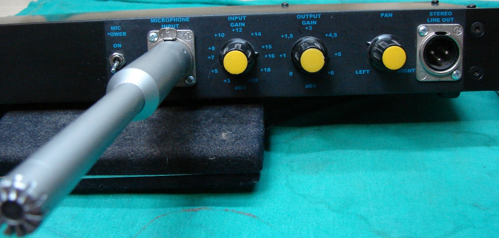

Another 2 shots with the ECM8000 clamped on the input XLR. You can see as well the details of front panel.

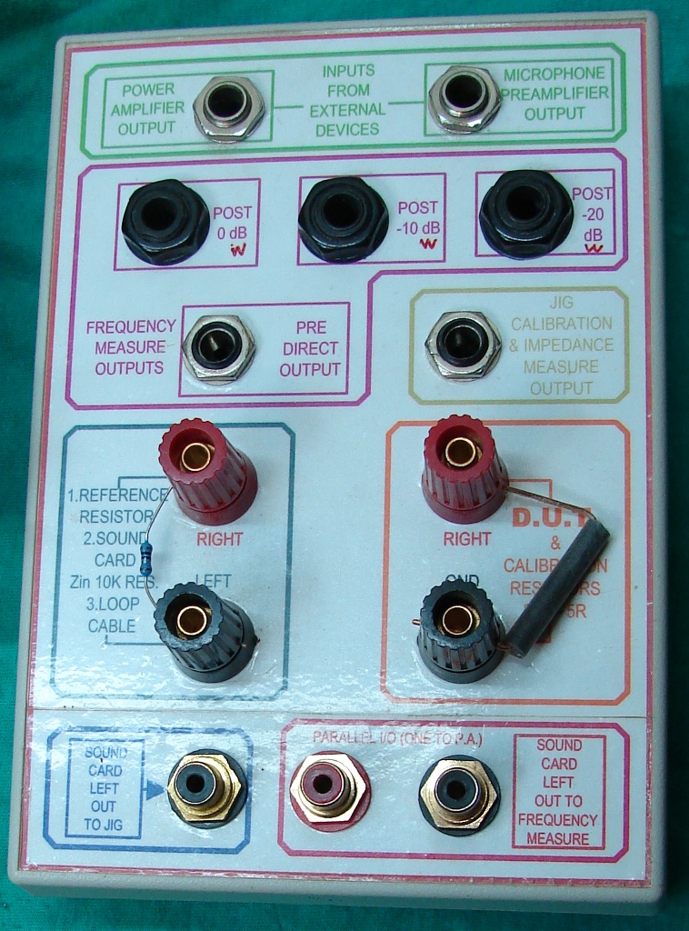

In the 3rd picture, you can see (or anyone who is interested) my own version of the jig-box which is needed for use with the Speaker Workshop. It is based on the Carlo Negri design.
There is as well a compensation file for the ECM8000 to put in your measuring software in the mic. calibration menu.
