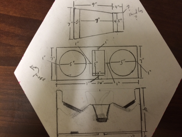

I've added a sketch that I drew a while back. the measurements aren't the same but the layout is Im planning on 2- 5"-6.5" drivers and one High frequency driver in the middle. I'm here to find out what type of drivers I need in those places. I have analog electronics construction experience but speakers building is not an area I know much about.

Best look carefully at the design considerations for these "arrayed" boxes. Getting the polar response to work is not exactly trivial or random.
In specific the vertical response of the HF driver needs to be appropriate in the horizontal and vertical axis, usually VERY narrow in the vertical axis and very WIDE in the horizontal.
The frequency of the xover to the "mids" is also critical in this regard...
Your "mids" need to meet the "subs" which usually means something in the 100Hz-200Hz range.
Otoh, any combination will play loud with enough boxes stacked.

Yeah the more reading I've been doing I've learned that the HF has to be pretty specifically set in each cabinet to work well. The more I shop around I'm finding it difficult to find waveguides in the price range I'd like. So I'm considering building my own I've seen a few different diy waveguide horns in my research. So at this point correct me if I'm wrong do the 1" drivers I've got selected look to work good IF I can get the correct dispersion in the waveguide? And I need Mid-bass Drivers for my "mids"? Looking to build each cabinet to run somewhere around 150-400 watts rms each. And building at least 12, 6 for each side. I know that a wide range but I'm seeing all kinds of options, I'm still researching and will probably buy a few different options to test in my prototype. But wanting some input on the type of "mids" and "highs" to get. If that makes sense. I will be building subs arrays in the future for the low end. But researching and designing this part first. Thanks to all for the input!!!!
OK guys what about 2- Pyle PDMW6 6-1/2" Mid-Woofer, AND 2- Pyle PDS221" Titanium Horn Drivers mounted in a equal diffraction waveguide horn? I added a pic of an example of a waveguide I'm looking at building.

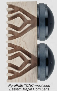

I see a lot of activity on this thread but have not been back to my PC to read comment.. I will try to tonight. I have thought about doing something similar recently and can share what I came up with.. Might save you some steps.

I was planning a smallish line array for fun but stopped because I couldn't find weather resistant drivers I wanted.
1) how much output do you need will determine how many modules you will need and the driver size required. I have never seen a line array with less than 8" drivers but I have heard there is one with only 5" drivers.
2) If the venue is not too large and you have help, a few large boxes move and pack much easier.
3) if this is live sound you can get away with the pyle drivers and some processing however I would personally never use them for professional DJ'ing.
4) will you be bi-amping the modules? that means no passive xo's but 4 conductor cable to each cab and something like speakon connectors which will factor into cost.
