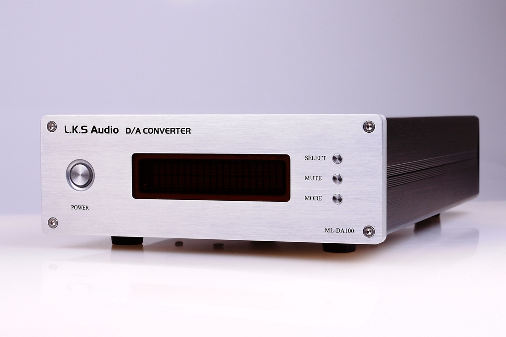

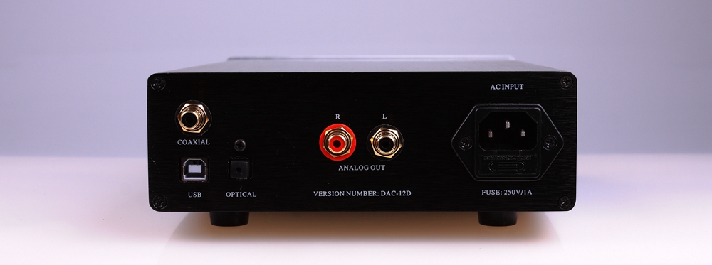

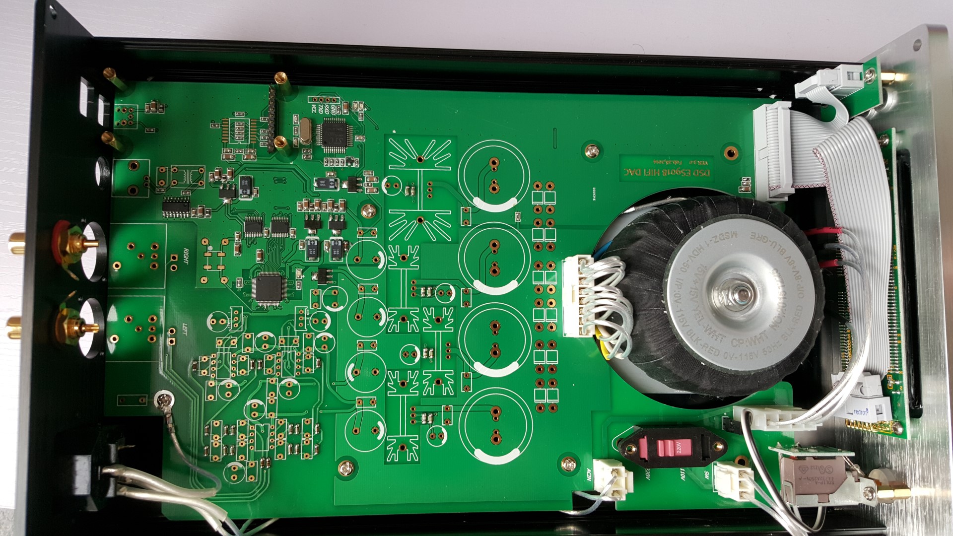

Since I want to keep one leg into the practical world I've decided to build myself a ES9018 DAC with Amanero Combo384 USB for DSD512/PCM384 streaming. The circuit is designed by L.K.S audio. Which makes some dafty looking devices. I've been in contact with the owner for a while and he seems to be a good bloke with a healthy passion for audio. He's really helpful with any question you throw at him.
https://item.taobao.com/item.htm?spm=a1z10.1-c.w9789869-11612113831.55.PTmE2D&id=25873632122
attachment.php
attachment.php
attachment.php
I've decided to build this DAC because of multiple reasons.
1. I like the ES9018 chip that I've heard in multiple devices. :hphones:
2. I wanted a design to match the Lehmann BCL :cubist:
3. I don't need al kinds of expensive fancyness like balanced ports and stuff :down:
4. Can't be to big 😱
5. It should be within a certain budget to keep the fun in it if I screw it up 😀
Well this DAC suites all my needs and I've made a very sweet deal with the owner of the shop to send it to me partially assembled so I could do the rest myself. I asked him to only solder the really small parts like the chips and small resistors and stuff. It saved me ¥500 yuan which is about €65. The fully assembled package normally costs ¥2300 (€315/$350) and I got it for ¥1800 (€250/$275). Depending of the result of course, this seems to be a bargain.

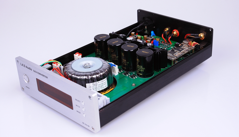

I've showed the device to a well known and experienced audio enthusiast on the forums here that happens to live in the city where I'm currently living and working. He pointed out some week spots in the circuit like that the voltage regulators are quite far away from the chip and he was not fond of the way of grounding. Well it'll have to do for now but I'm going to try to make the best out of the device with some modifications.

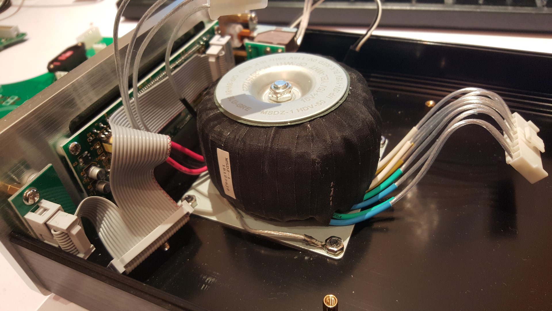

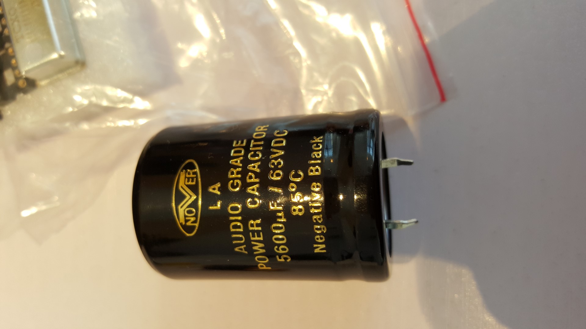

The device was delivered with a complete parts list. Some of these parts are:
50VA custom torodial transformer 8V+15V
4 big power caps are NOVER 5600uf 63V (Panasonic made). I will probably upgrade them for some Nichicon KG Type II 6800uf 63V unless people think very highly of these caps.
The regulator output caps are Nichicon Muse KZ 470uf 25V caps. Quite big. Their direct competition could be the Elna Silmics II which I have really great experience with in the signal path.. But since this is still the PSU I am wondering if it would not be a better choice to use some caps here that are designed to work in the PSU.. like the Panasonic FR caps or FMs with really low ESR.
The other electorlytes are Nichicon FG 47uf 50V caps
A lot of red Wima caps arround the opamps
3x OPA 1612A which I've never heard of
ST LM317 and Fairchild LM337 voltage regulators which I already replaced for ON version
A JYEC TCXO crystal.. never heard of them, but they seem to be used a lot by respectable Chinese brands like Gustard and Audio-GD. So I guess it's not to bad.
A Sanyo cap near the ES9018 chip
And some other parts
Feel free to comment on the project. I haven't made up my mind yet about all the part choices. If you have suggestions and also for mods to improve the circuit than I am happy to hear about them. If you have a suggestion please explain why to me. I'm trying to learn. That's the most important thing. I'm not trying to put something together quickly to just copy some other's work and race to the end goal. I want to learn more about audio circuitry.

I'm still studying the circuit and I've decided to first build the devices as it is supposed to be build according to the seller. My new 'town mate' Richard, here called abraxalito helped me identifying some weak spots in the device and he made a few good suggestions to modify some thing after I'm done building up. I will do it step by step to evaluate the changes just like I did with my Lehmann clone.
Here are the schematics for the device. The schematics show LM4562 opamps. I've got some OPA1612A that came with the device but I also have some OPA2604APs ready to take their places with some class A adapters (the same i've used in my lehmann).
http://www.diyaudio.com/forums/attachment.php?attachmentid=532020&stc=1&d=1455814207

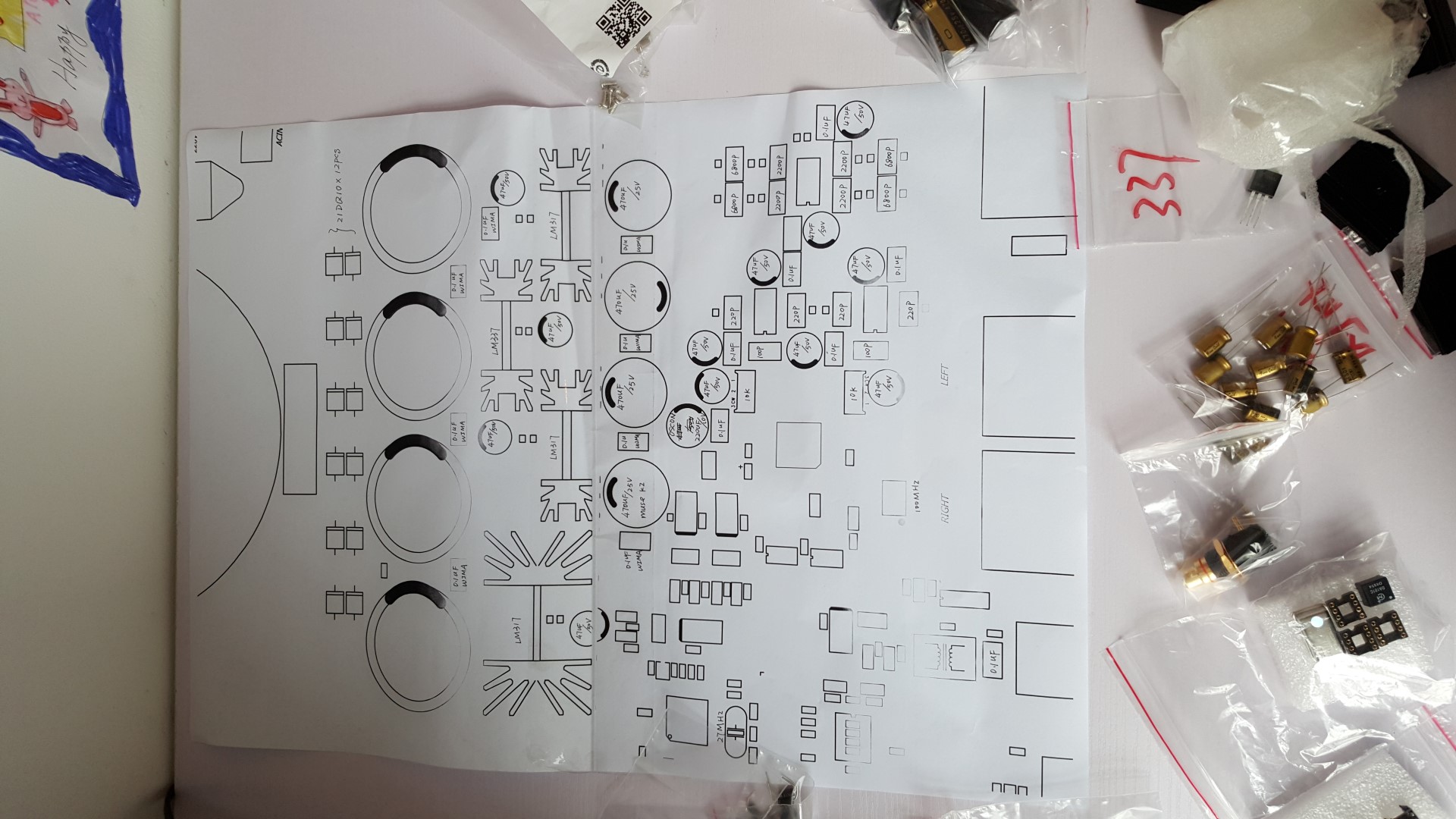

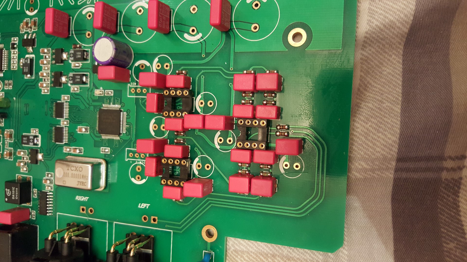

I've noticed that the parts mentioned in the schematics are not 100% matched in value looking at the parts delivered with the device. For example all 10uf/16v caps from the schematics are replaced with 47uf/50V caps that came with the package. I am not sure yet what I will do. I have to figure some stuff out. I'm still learning about all the functions of the components.
attachment.php

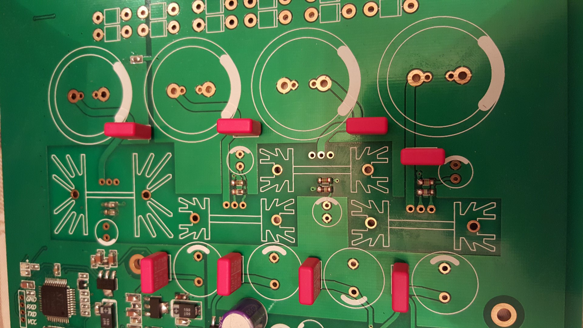

A LOT of wima caps.. not really happy about it.. better alternatives are quite expensive. At least I swapped the MKS2 0.1 caps out here for MKP2 0.1 caps. Will do more swapping after I've finished the build near standard.
attachment.php
Replaced MKS2 0.1 caps here with MKS4 0.1 caps
attachment.php
These puppies went with the package. Brittish brand from Anglia parts. They only give the ripple current spec in the specsheet. 3.3A if I am not mistaken. I have space for 30x50mm. Not sure if I should increase the size to 6800uf and maybe Nichicon KGs or Elna's for Audio.
Would and Elna for Audio 6800uf 35V be better than these 5600uf 63V caps? Or maybe KG Gold Tune 6800uf 50V. Both fit I think. I am not willing to put Mundorfs in it haha. Badshit expensive here in China!
I will be populating the reg output positions with Elna Silmic 470uf 25V caps instead of the Muse KZ caps. The other small electrolyte cap positions I will populate with Silmic 47uf 25V caps instead of the Nichicon Fine Gold 47uf 50V caps. This will be my starting point.
Probably after that I will start looking into cleaning up the power supply section with some mods.
After that I will try higher electrolyte cap values for the reg ADJ positions. and maybe near opamp.
Would it also matter if I used something better than the Wima MKP2 near the DAC chip itself below the Sanyo cap?

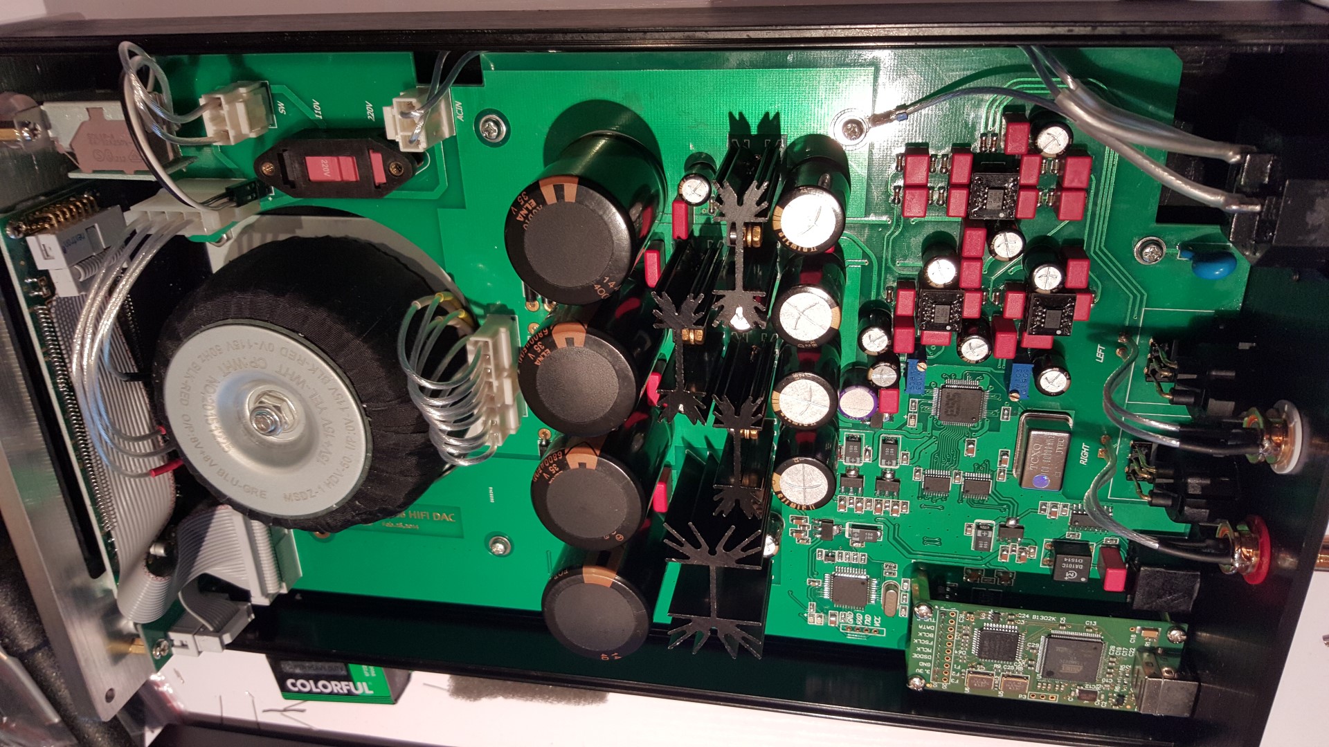

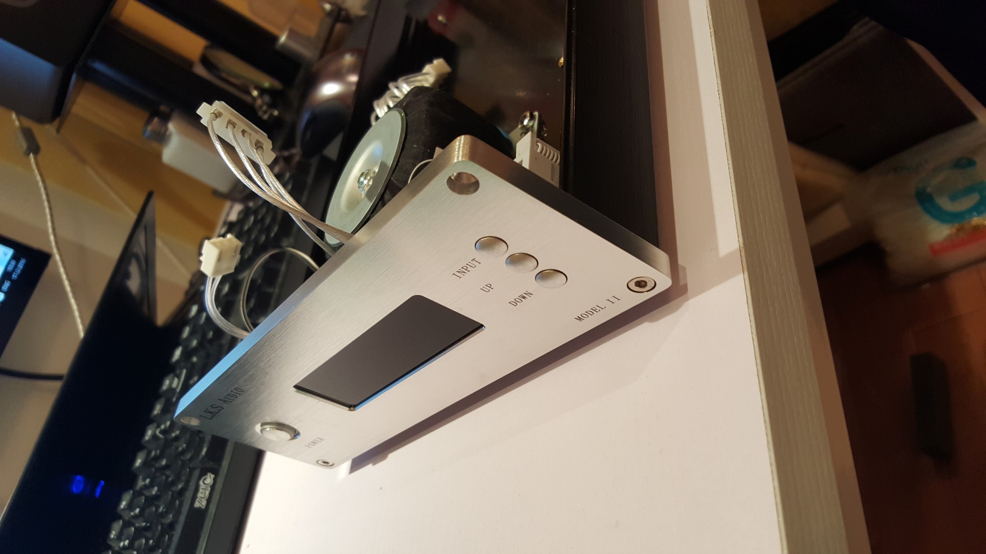

Ok, So i've finished my build.
attachment.php
I did the smoke test and at first it seemed ok and all light were going on and the display responded. But after a brief heat check.. my fingers almost got fried on the LM317 voltage regulator above the opamps. It's going into the analog circuit. I've checked the 470uf Elna cap behind it and resoldered and cleaned the surroundings. Something is pulling a lot of current through it.. It stinks and it's WAY hotter than the other ones. The seller of the parts and the board agrees that it's not normal. I can not put my finger on the heatsink. Not even for a second.
If some one has any idea where to start looking I would be really grateful.
DC offset is already adjusted to 0 volt with the trimpots.
Oh and BTW, can someone say something about the WEIRD ELNA for Audio caps I've got in there? They are not gold but orange and have black cap instead of metal with the sword.. they look fake to me..
The board itself is looking well made so it's a pity that something's not right.
The current has to go somewhere so there should be a part generating a lot of heat except the LM317 of course.
Or is it the supposedly fake Elna caps? Check the resistance across them, maybe you have close to a short there...
I pulled the 'fake' Elna for Audio PSU caps out. They are fake for sure. Not even going to bother with their performance.
For now I put the Nover 5600uf caps in.. which are probably fake too haha. I've got some genuine Nichicon KG type 2 4700uf 35V caps on the way for the time being until I've found some good Elna's or something else nice and genuine.
The other Elna Silmic caps must be real.. even though their gold color is a bit more towards the Nichicon gold color than the somewat greenish gold of the silmics I'm used to. The silmics I have come from 2012.. I also have some 2015 caps. One of these Silmics was showing shorting. So I pulled it out and it wasn't the cap. The cap is exactly 470uf and works fine. It's the circuit..
After some looking around I've found that the heatsink of the LM317 that was overheating big time was making contact with the ground... Yeah.. no wonder so much current went through it. All looks fine now. But I think I'm going to replace the Voltage regulator anyway.. I think it's toasted..
It's late here now. so I won't test tonight but tomorrow will be a fresh day with fresh courage!
Thanks for your response. I found the Elna cap shorting and then I read your post and it confirmed my thoughts and after that I was able to find the real problem 😀
I can confirm that all measures well now. I haven't listened to it yet. I am waiting for some new signal wire tomorrow.

  • I also really like the transformer. It is a big well build transformer and the wiring is well done.

  • The PSU NOVER caps would not be my first choice since I think they are fake too, all coming from the same Chinese counterfeit factory. I will replace them with Nichicon KGs or Elna for Audios.

Then I rolled in the trusted OPA2604APs. Right on the spot. Highs extended a bit more. The soundstage got wider and the instrument separation just got a tat better. But the bass got a bit bloated which was a bit annoying after a while.
But I had another trick up my sleeve. These UFEEL upgrade adapters. They cost about €8,50 each, but are definitely resulting in better sound than biasing with resistors. This solved most of the audio signature problems. The bass got REALLY tight. On Plastikman - Explore I could just raise the volume on my QMS Q5 speakers (which are REALLY good at bass too) and every kick was just so tight and controlled. Much better than with the Sanskrit! The sanskrit is a bit loose in this department on the Low end. Voices got cleaner and more forward and all the instruments in the high range just got more separated.
After these small modifications the sound really changed to the way of my liking. I'm not there yet. I still think the sound can be a bit more airy and cleaner but, so far I'm really impressed.

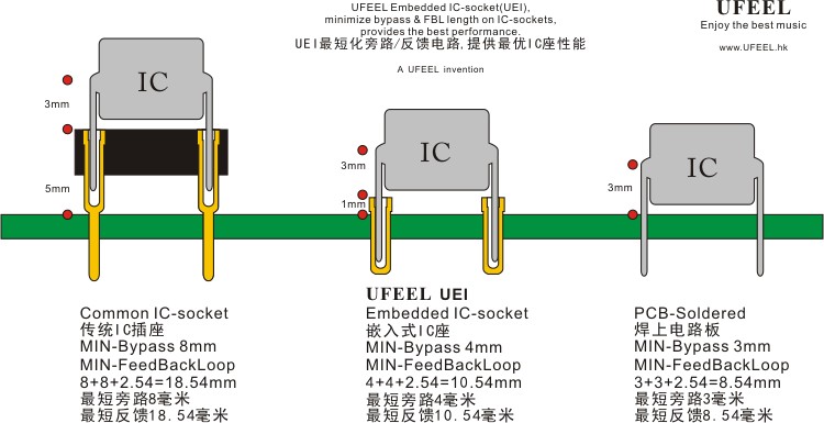

For people that are interested in what adapters I've used for the for the opamps:
attachment.php
attachment.php
attachment.php
attachment.php
It's quite a unique product I think. Can not find a lot of products alike on Taobao at least. The maker of these adapters speaks English really well and is invested in High-End audio like very expensive CD players.
For me.. the adapters work. They have a very positive effect on the sound and make everything less noisy and more in control. So good effect on PRAT and noise

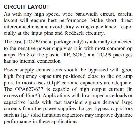

So there is some work left to do. I think the OPA2604AP are a bit to much in the I/V stage. Not very well suited for this circuit here. I have ordered myself some AD797 and AD843 single opamps to play around with. I will also put them in class A with a CCS to see if that helps.
I will rework the analog section around the opamps with smaller caps and bigger resistors.
Also finally ordered myself some Nichicon KG Type 2 4700uf 35V caps. I am pretty sure the 5600uf 63V Novers are fake as ****.. I've have ordered a couple of Elna for audio and BHC caps.. which I all found to be fake and coming from the same factory.. exact same size, shape and materials.. Not original. So I ordered some 100% genuine Nichicon 4700uf 35V and some Vishay BC 4700uf 40V caps which I need for some other project too. Can try both but the Nichicons are intended for the DAC if it doesn't make a big difference. When I'm at it replacing them, I will cut their shared ground and give them dedicated ground wires.
Replaced the 4x NOVER 5600uf 63V caps with 4x Nichicon 4700uf 35V in the PSU. I can almost not explain in words how this improved the sound! These Novers caps (which I already thought to be fakes) were bloating the bass, recessing the mids and putting a lot of noise and distortion in the signal.. placing the Nichicons solved all this. I will also test the Vishay BC 4700uf 40V caps which performed even better in my Lehmann than the KGs by being more musically pleasing and warmer. Curious how they will do in this DAC.
NEVER buy these Nover LA counterfeit c(r)aps!

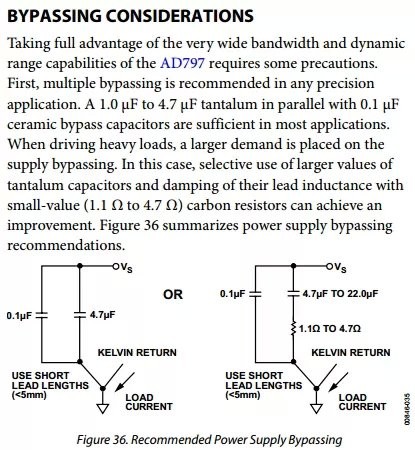

After that placed some AD797ANZ mono opamps in the I/V stage which are a bit more clinical than the OPA204AP but give back more airyness and open sound. Also placed OPA627BPs in the filter to differential stage.
Combined with OPA111VMs or OPA604APs in my Lehmann this creates a nice dynamic sound.
Next incoming are AD843AR, AD843SQ AD828AR and AD828AN. But these probably need some adjustment on the voltage rails to not burn out to quickly.
So far I like the AD797ANZs but they are a bit clinical and missing some dynamics as is. Going to try to tune the surrounding circuit better to let them open up more.

Canged the R80 and R82 resistors on the voltage regulators for the analog section from 2.55k to 1.5k to lower the voltage rail from 15V to somewhere up in the 8V range.
This so I could pop in some AD843SQ (ceramic package) opamps and bias them to class A with 2 jfets. The class A bias really made a a big improvement for sound quality.
Everything got very open and tight. Loads of space and detail.
