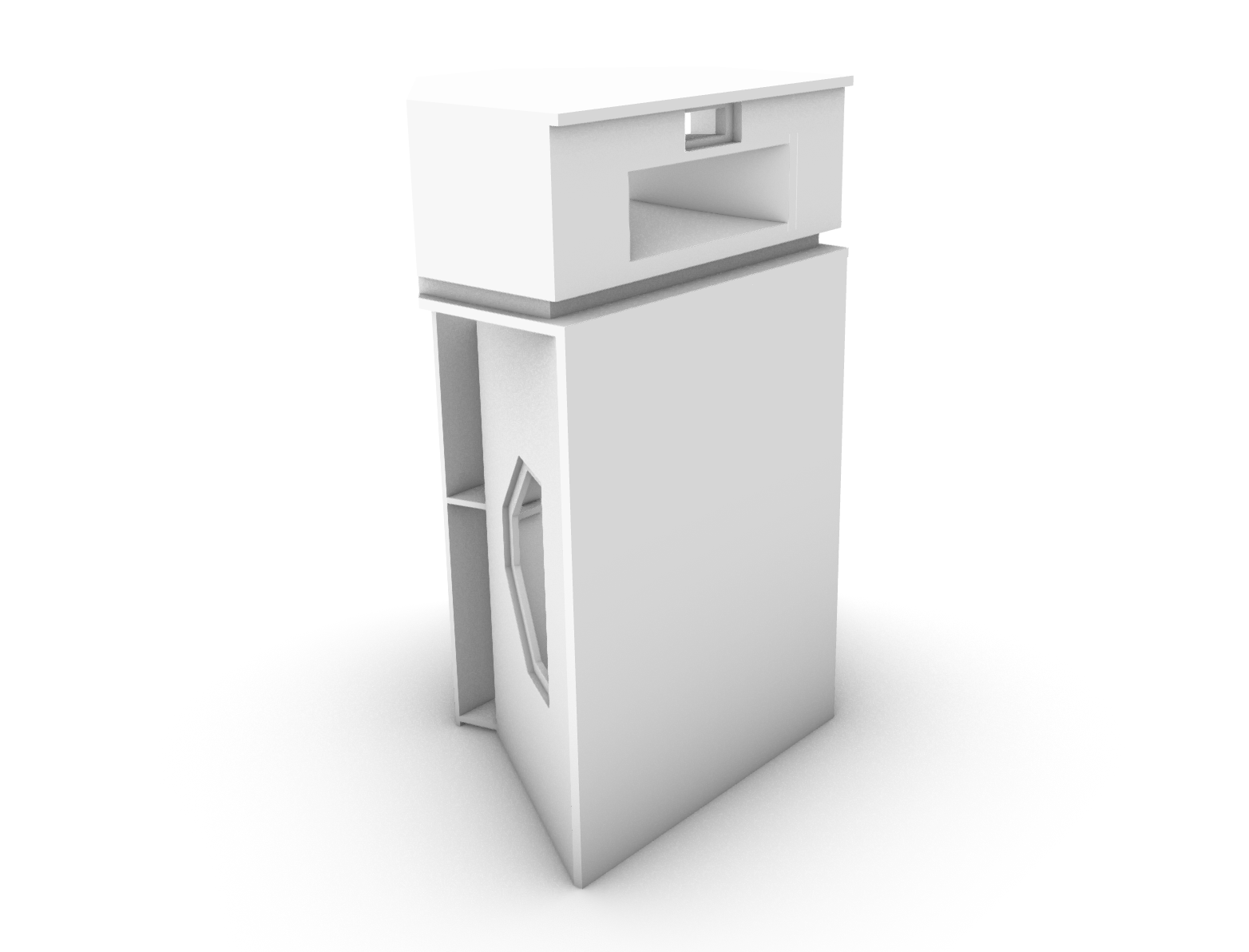

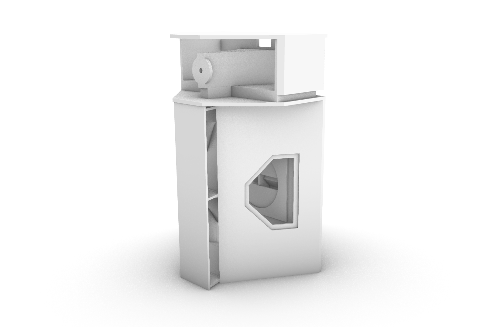

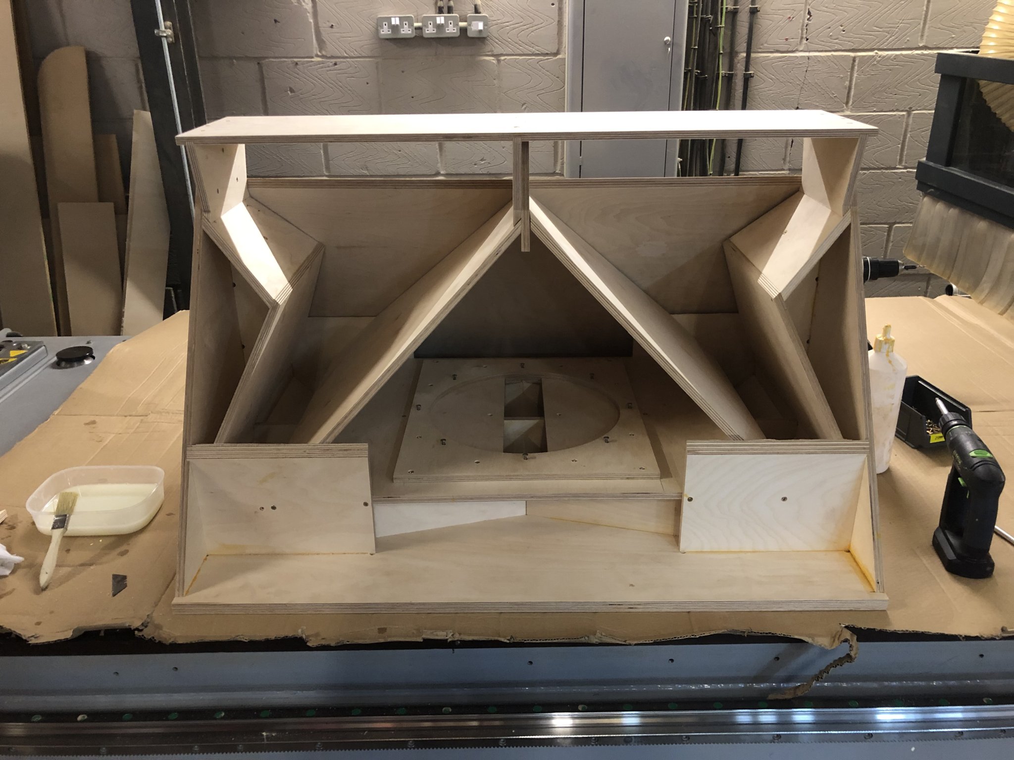

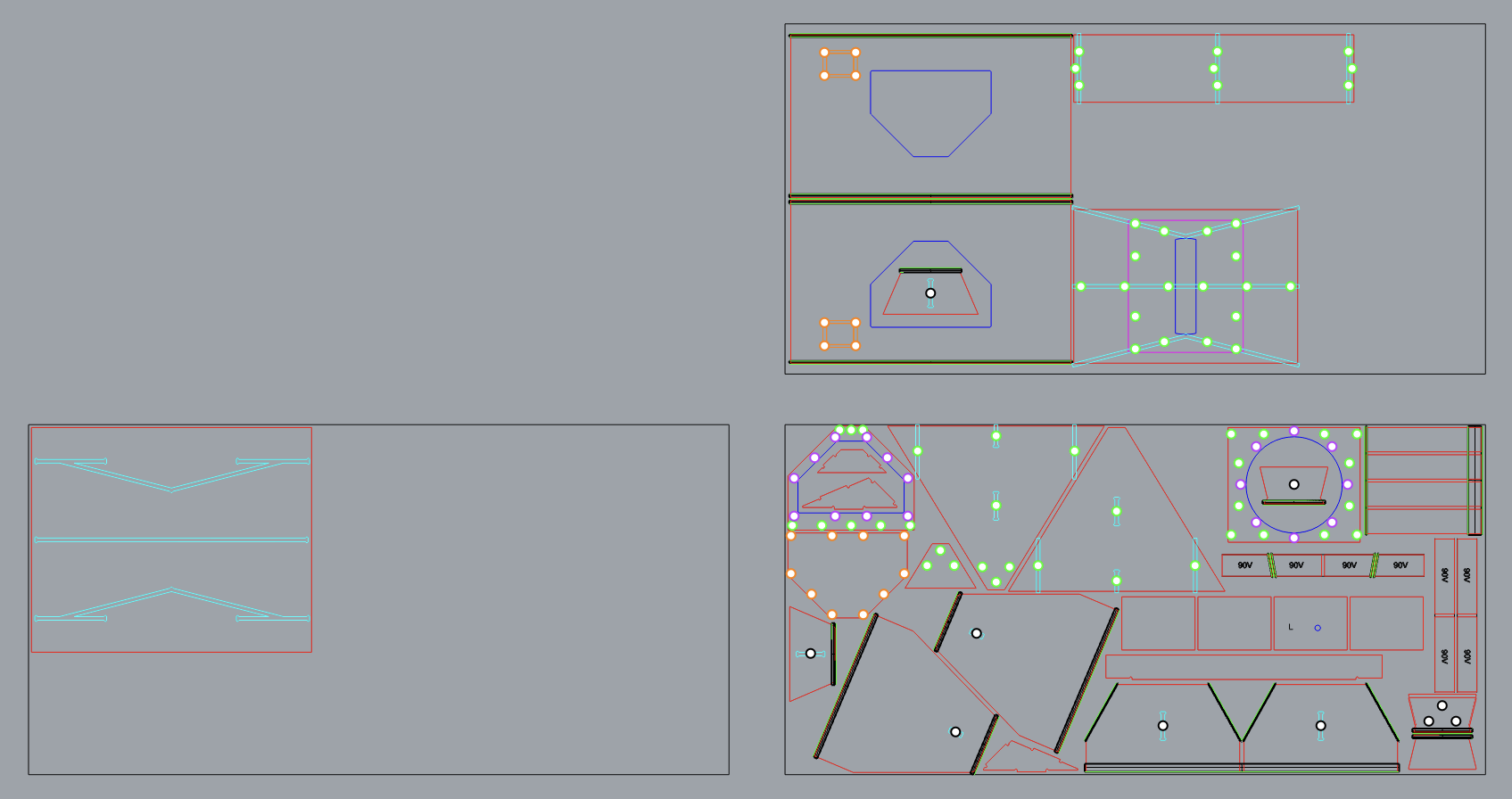

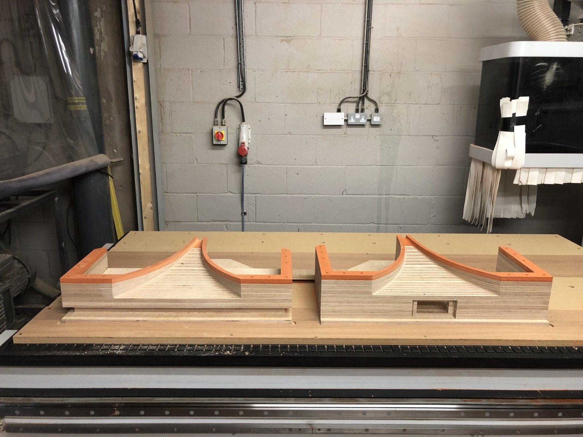

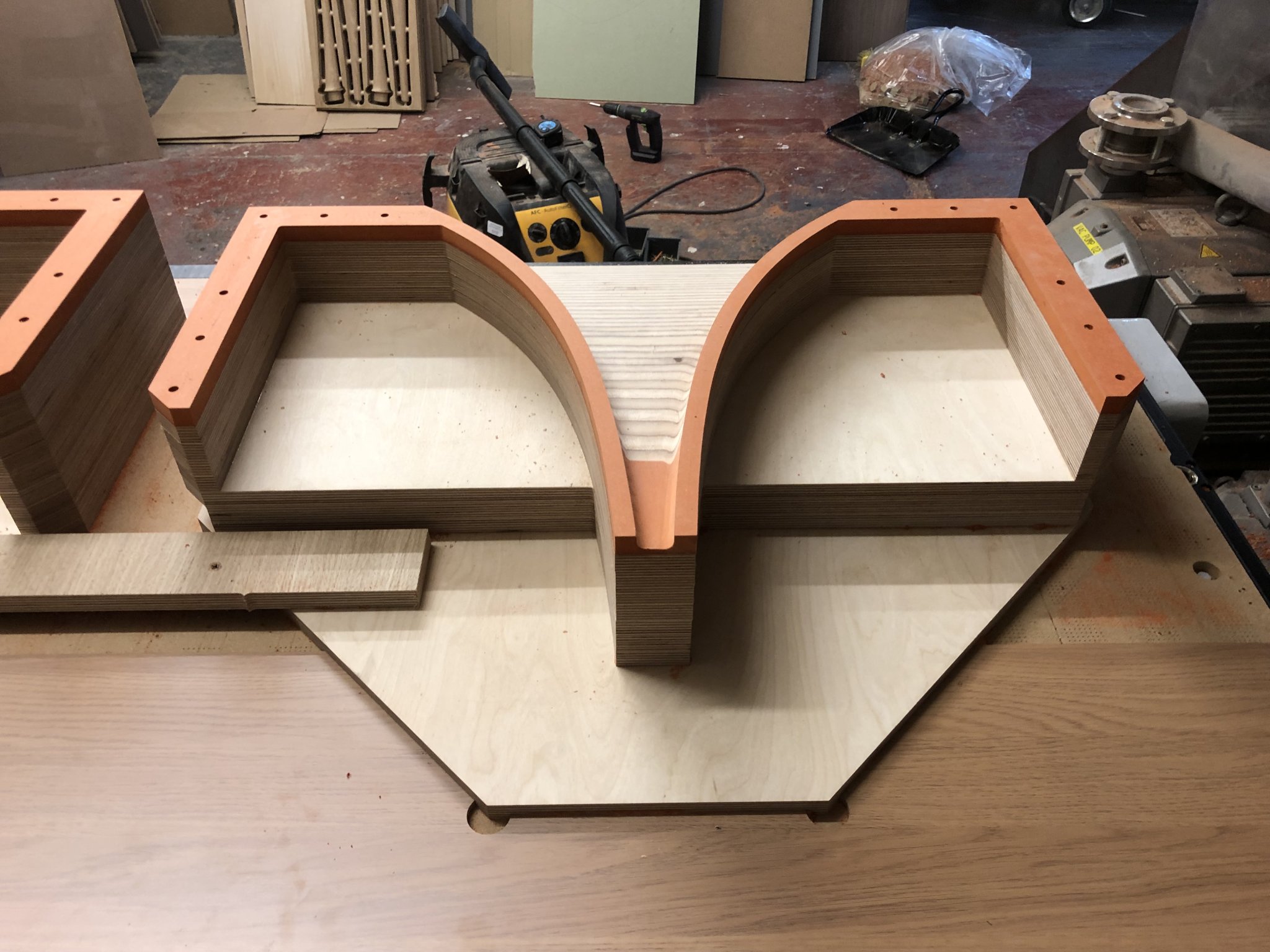

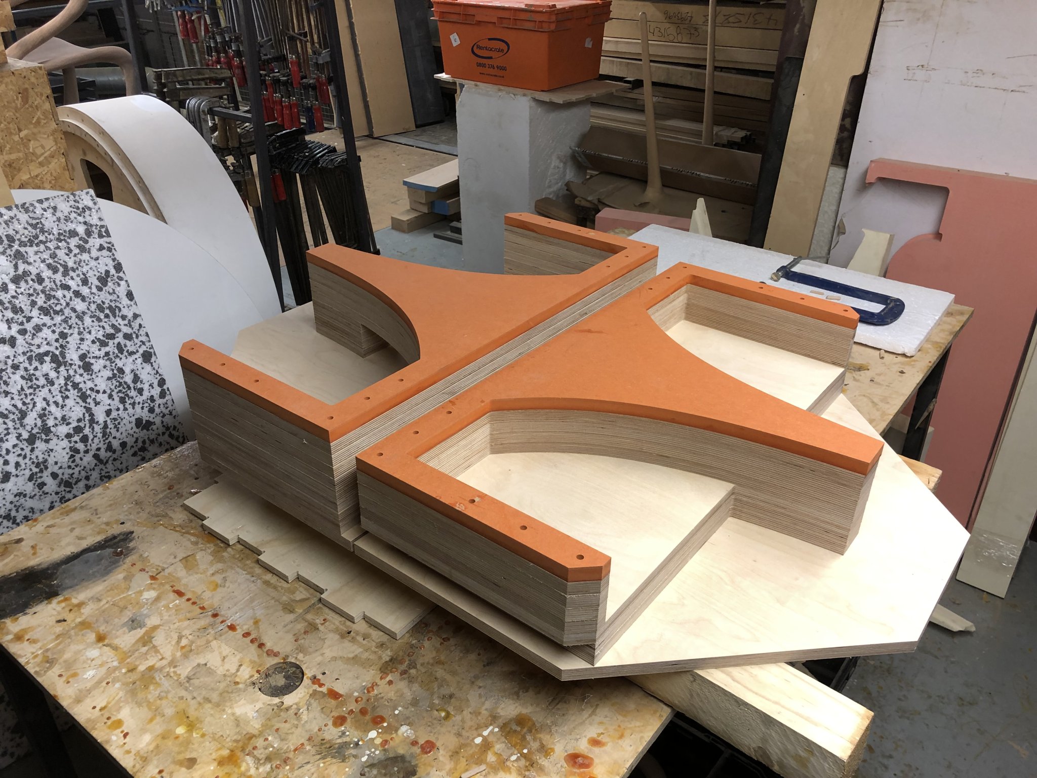

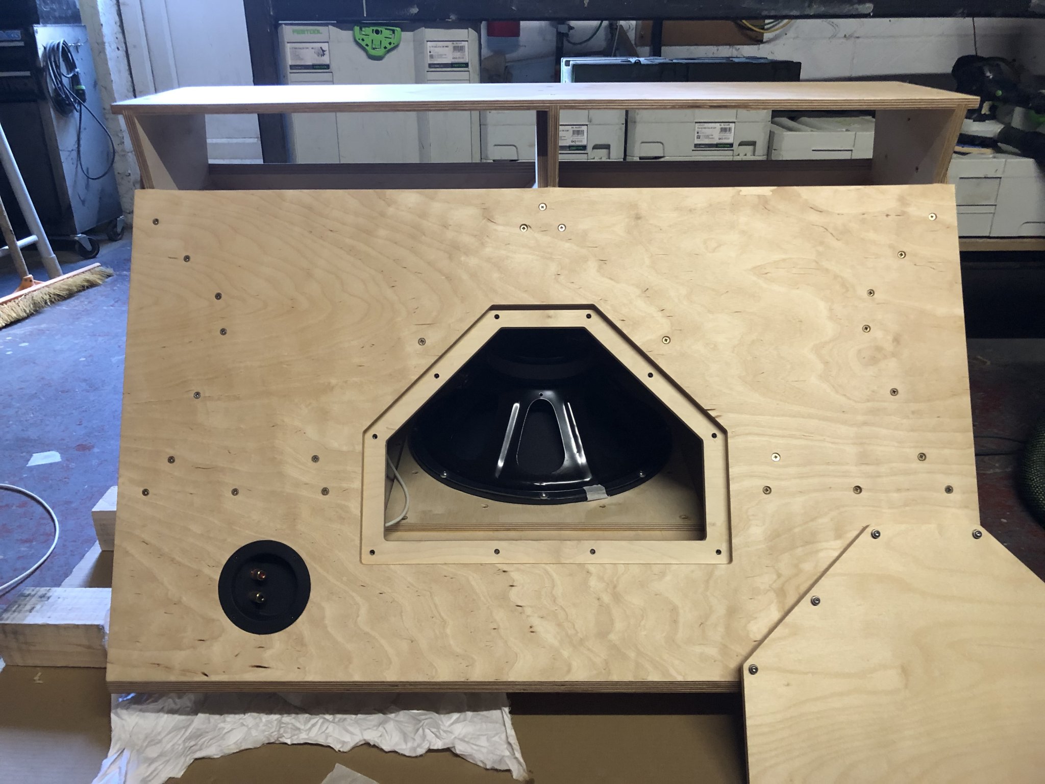

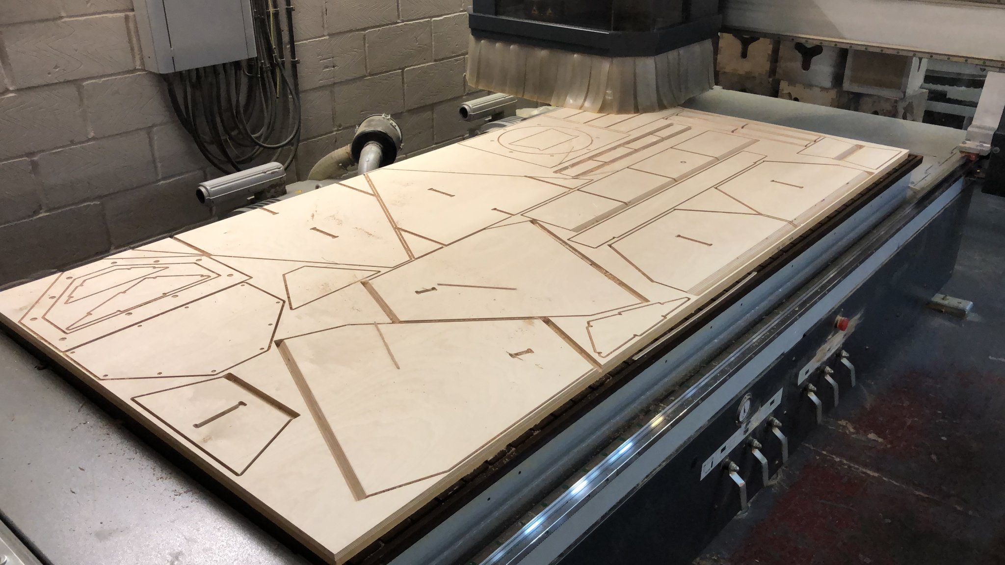

Following a little research I found a number of documents online that helped me to create a 3D model of the Klipschorn in Rhinoceros. I used this 3D model to begin thinking about how I would CNC machine the parts that can be generally split into the 2D components for the bass cabinet and the 3D machined components for the midrange horn. The first set of photos show the 3D model, some of the 2D components laid out onto 8' x 4' sheets ready to be programmed for cutting and what some of the 12mm parts look like on the machine bed. Some components needed to be flipped and put into a jig for machining angles on the reverse side. I added rebates and additional parts to help with assembly and provide additional bracing in a few areas.
3D model
3D Model
2D Drawing & 3D surfaces laid out and ready to be programmed for cutting.
Finished 12mm parts on the machine bed.
Bass cabinet build in progress.

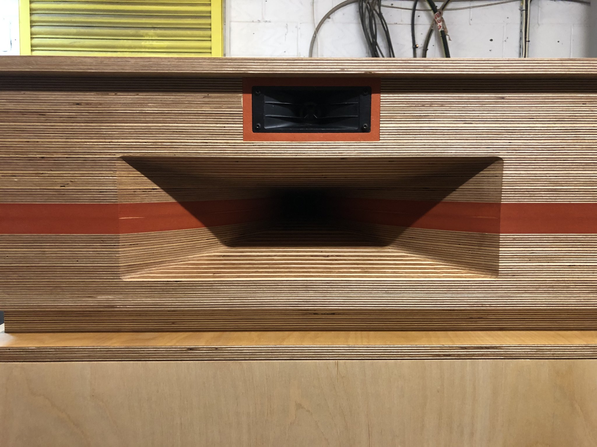

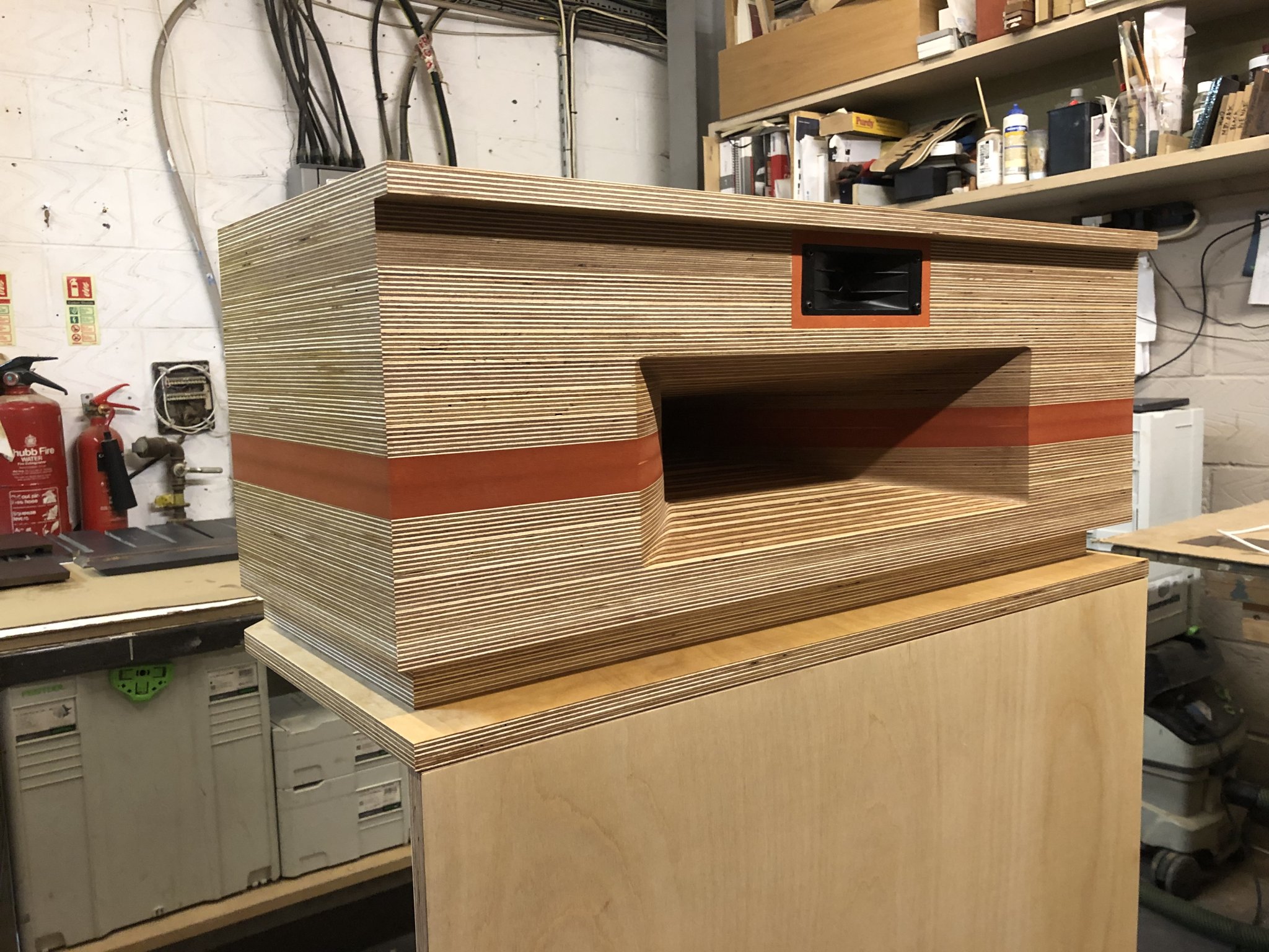

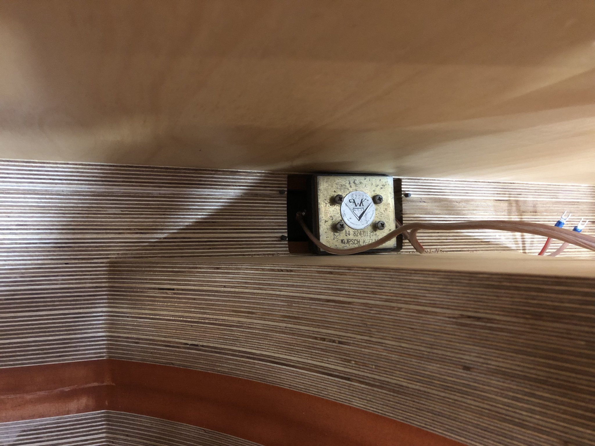

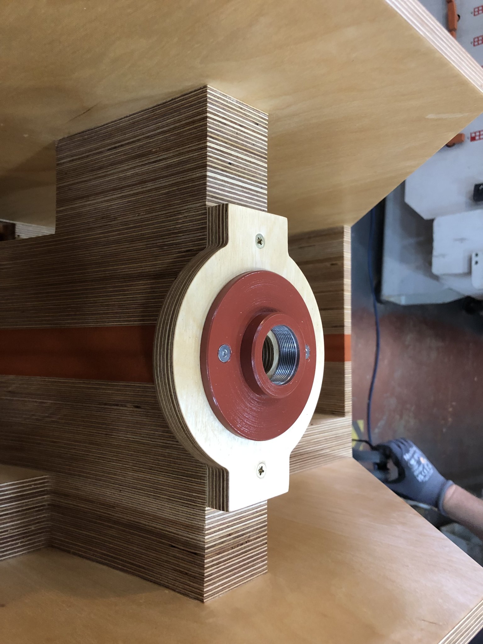

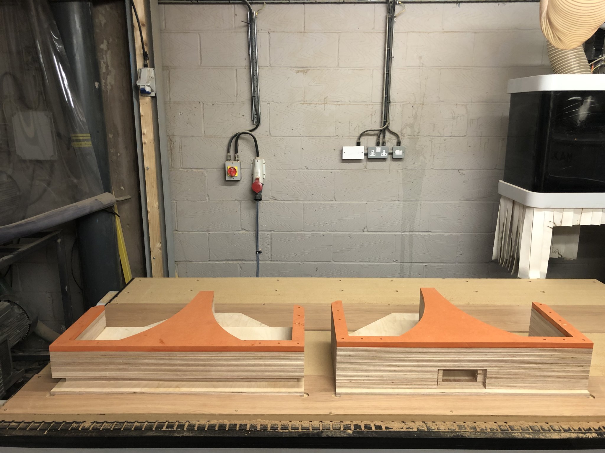

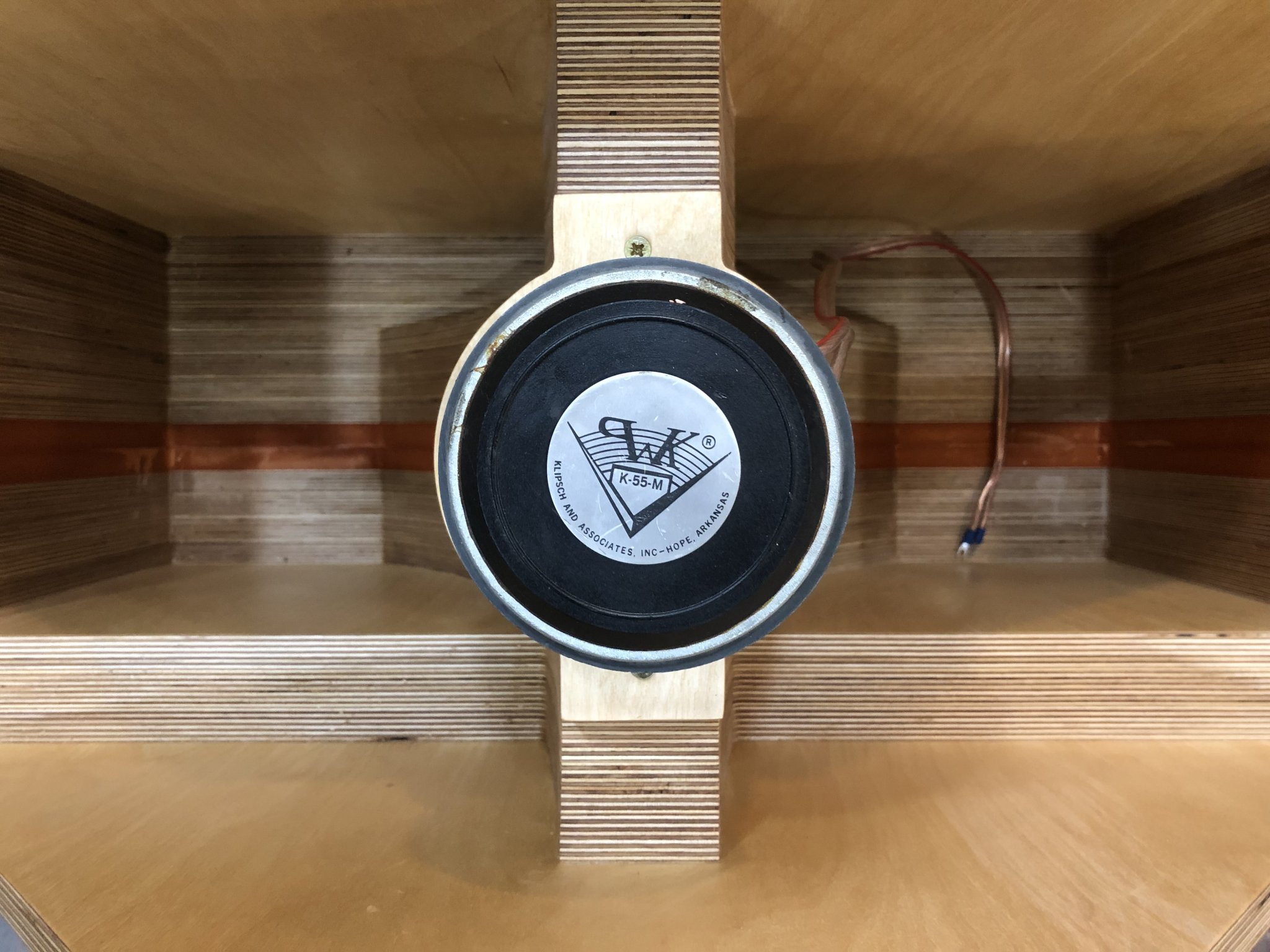

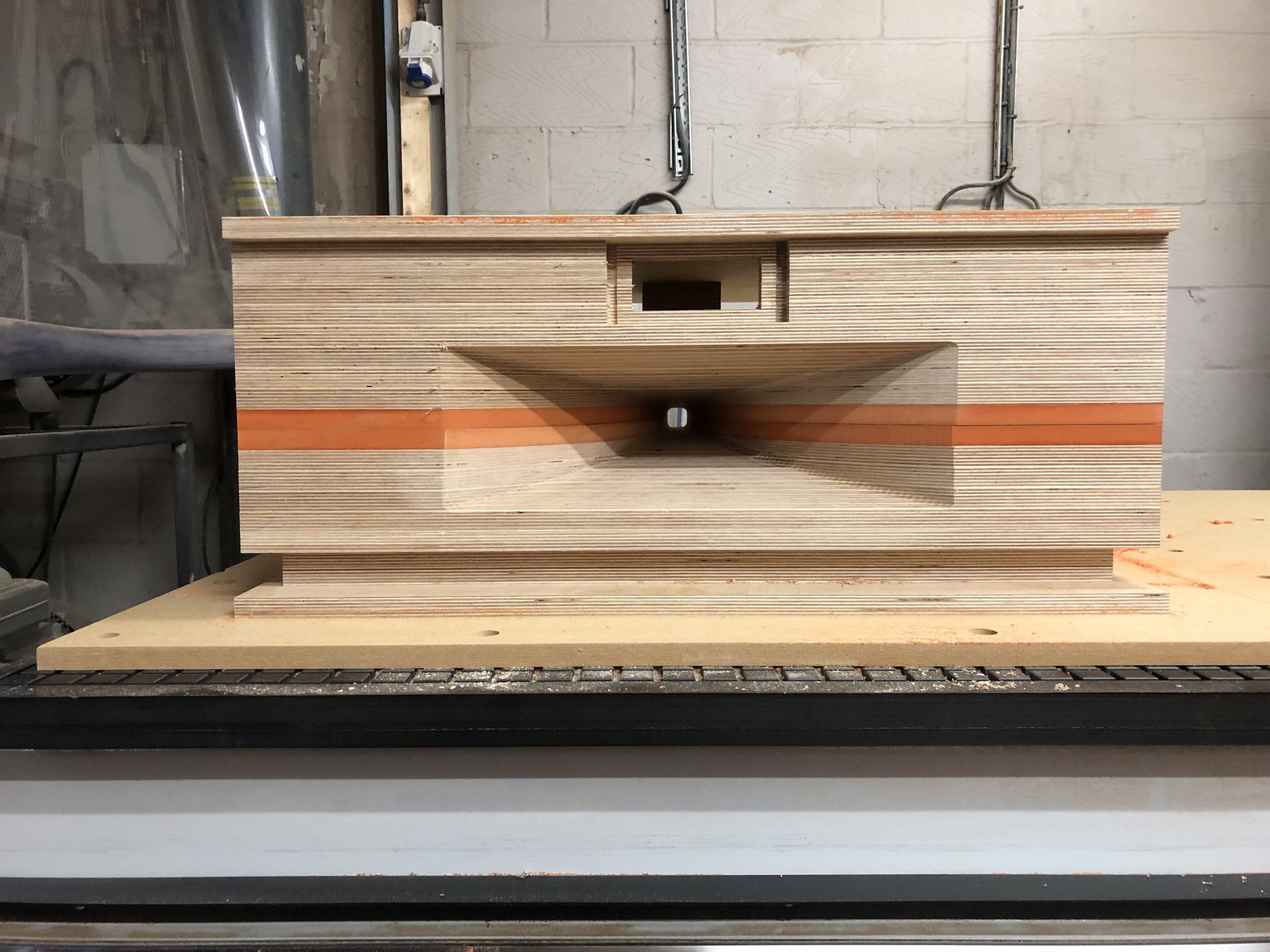

The following photos demonstrate the preparation of the 18mm birch ply stock for the top and the stages of machining.

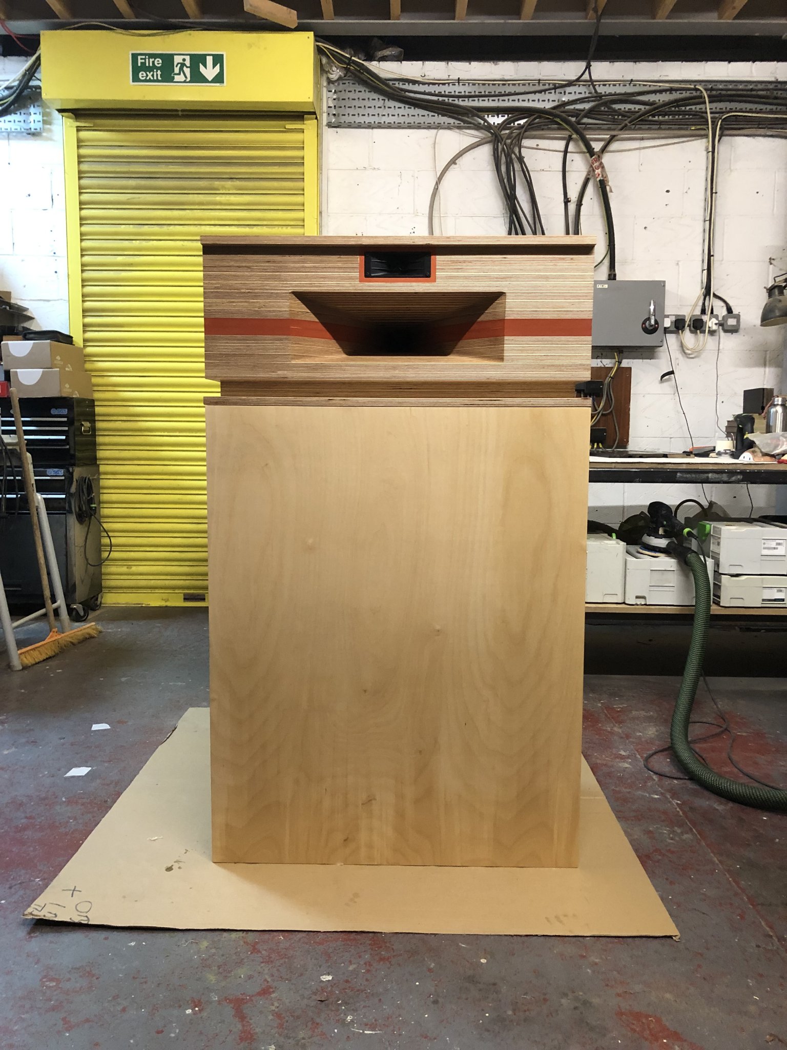

...and finally I'll skip everybody's least favourite part of the process which is the sanding and show you the fully assembled and oiled speaker.
Hopefully that's a good overview of the process without getting into too much detail. Any changes I have made can usually be attributed to making the assembly and machining processes as easy as possible and trying to achieve the best finish. In time I would be happy to answer any questions that anyone has!

No one, not one understood what I was making. "Why are you putting the speaker inside of the cabinet?" Got a lot of that. It has been over 40 years since then, and eventually I got tired of moving them. Seeing this project come to life is the best. I bet that the midrange horn works swell. You may have said, but what finish will be applied and how many coats, etc? These also look to be heavier than the standard issue, no?
Yes, I like the midrange and find it has a warmth to it, even it is a little heavier 😉 To finish the speakers I use Osmo hardwax oil as it's very forgiving and easy to work with. Three coats is ideal and there are other products in their range that can be used for additional protection; but I haven't found this to be necessary. I'm open to other finishes but this has been my favourite to use on birch plywood so far.
Osmo. Yes, I have used it once. Heavy stuff. Seems that I used 1 coat pretty heavy and then waited quite a while to put the next coat on. Stuff like ply does soak up its share of the stuff. Only recently have I turned to shellac and wished that I had tried it before. I was using lacquer because it was quick and dried hard. Varnish was a go to for some time, since back then I lived in the desert and the heat had its privileges. Can you tell that finishing is my least favorite, but most important task in a project?
