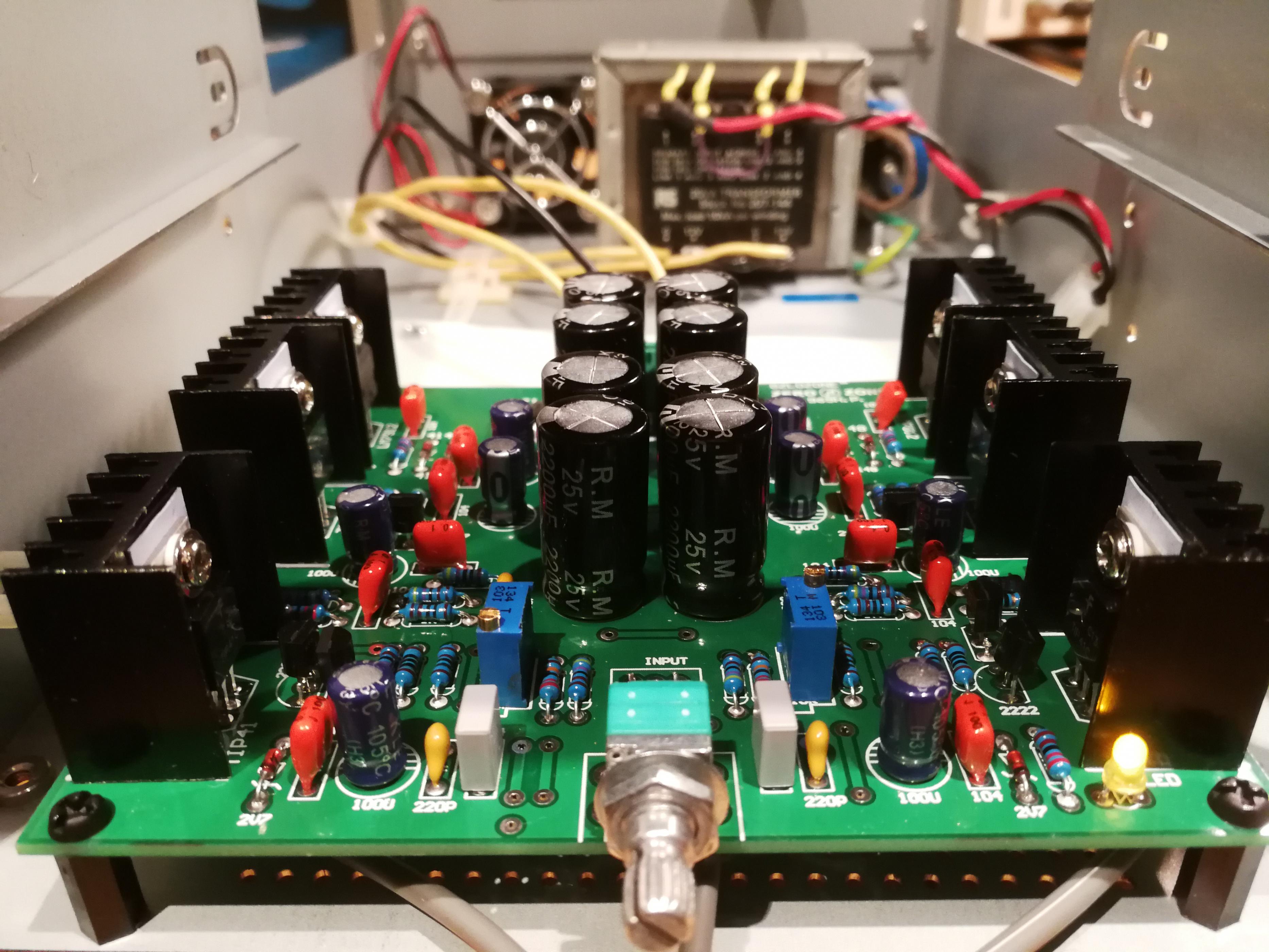

Assembled the Chinese diy kit of jhl hood headphone amp which also carries "zero zone" on PCB. Love the sound. Can't sonically detect anything wrong with it. However one half is running hotter than the other. There are two variable resistors which I measured were both set half way. Any advise on how to fine tune?

Those pots is to set DC offset at the outputs. but it's useless. the offsett is all over the place anyhow. you need a DC servo or AC couple the amp. i just finnished one of these myself. and the offset goes from 900mV to -200mV depending on temperature.
AudioSan, I saw re offset on this forum. Is it DC component of the output? I checked with oscilloscope, as far as I can see when there's no signal both output channels are on the Zero.
At the moment the fact one side is a lot hotter than the other bothers me more. Is it R1 and R2 as per above schematics?

Yes, it really is a JLH design but for reference, it follows a specific headphone amplifier design published in 1979 and subsequently upgraded in 1980. Unfortunately, TCAAS notes don't describe construction or set-up which would probably help with thermal and DC offset issues. The function and dissipation in either power transistor is not the same in these JLH designs so I don't think you could expect the temperatures, given that they are mounted on separate heatsinks, would be the same either.

measure DC voltage across the output. there is a snowballs chance in hell this is 0mV on this amp.

I did, with oscilloscope. They are on the Zero DC. The trace would have jumped up or down, but it stays on the same level as if I touched the ground. Hm... maybe I don't know my oscilloscope - something with "DC / AC coupling" perhaps... OK, will double check. With multimiter too.
The standing current of this amplifier should be 100 m.a. equivalent to a voltage drop of .051 volts across the 5.1 Ohm resistors in each channel. Q1 and Q2 are PNP transistors so if the voltage on the base of these needs to be less positive than the supply rail - the less positive the more current these will conduct.

It would be worth checking the values you have for R3 and R4.
Edit: The original article appeared in Hi Fi News & Record Review January 1979 pp81-85 referring back to this the output stage standing current was specified at 110 m.a. The version presented here will draw more current than this as R9 and R10 have been decreased in value from 3.3k to 2.2k. If heat is worrying then you could fit the original value resistors.

That's the advice I was looking for! 🙂 On resistor colours - I can't read them anyway! I was using the multimeter during soldering. 😉 Will check voltage drops.

For what it is worth the transistors specified for the original design were 2N4922 - 3A devices in a TO-126 package.
Your TIP41's in TOP66 packages are rated at 6A.
One could argue the kit supplier has specified a higher rated part in the interests of component reliability and longevity with a view to the higher output stage standing current.
