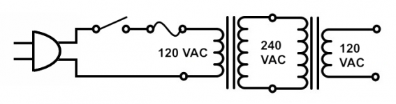

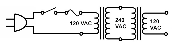

I have an old tube Magnavox record console. It has the line cord directly connected to the chassis and circuit. (No mains transformer.) It seems hard to find a 1:1 transformer. The ones I'm finding are designed for benchtop use with a built-in socket and fuse. I just need a simple transformer. Is there any reason that I can't just wire two of these back to back? It would only be $22. Is there a flaw in my thinking here?

Check the load of your console. 56VA may not be enough.
The link to the isolating transformer shows -
Primary: 115/230V 50/60 Hz (ie connect as required to suit supply).
Secondary: 120 VCT.
56 VA.
Only single transformer required.
I picked up a "Tripp lite" isolation transformer for $5 at a pawn shop. It's rated 3A and built more like it could do 15... Pretty large and heavy. Secondary has two std double AC outlets with film caps right across the AC output secondary plus MOVs in parallel with those. I think you can get one of your own to do this job. Mine looks exactly like this one -
TRIPP-LITE ISOLATOR IS400 Isolation Transformer 3.4A 400 Watt Hospital Grade | eBay
They arent cheap, unfortunately. If you can measure the AC power your little amp takes while running (using something like a "watts up" power meter) that would help you size the VA to come up with something a lot more reasonable in cost. You're headed in the right direction.

My valve amp test PSU is built exactly like that, using two back to back 230/245:110V isolation transformers.
If you figure 80% efficiency per transformer, or something reasonable, and de rate to say 60% VA rating or less.
Caveat: This is me saying it without doing the beermat maths.
