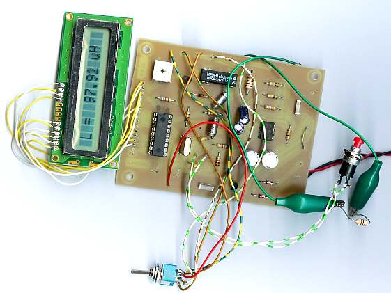

http://translate.google.com/transla...&hl=en&ie=UTF-8&oe=UTF-8&prev=/language_tools
You could build one of these.. I did and it works a charm, measures small caps too...
Nordic,
I had built a LC meter with a PCB made by me. But it didn't worked. Now I will try this one.
Thanks for de link.
Thanks for de link.
