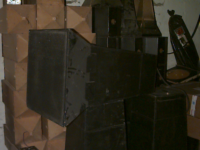

I made some very directional speakers called the Maltese Horn, a cop came by to tell me to turn down a single prototype 10” horn loaded speaker I was testing full range.
He said it had taken a long time for him to locate the source of the music.
As it was July 4 (1992) with firecrackers popping off all over the Minneapolis neighborhood, I was surprised any one had complained. The complaint was from over 1/4 mile away, on the other side of six lanes of interstate freeway.
The cop found me just after I had finished riding my bicycle back from around where the Wendy’s is on Broadway. I could still clearly identify what song was being played through the prototype Maltese horn over the traffic noise, but that was about as far as I figured it safe to ride away from the unattended speaker, power amp and CD player.
The speaker location was 2814 Washington Avenue North, over 3500 feet from North 4th and Broadway, where I turned back from the bike ride. The horn was just sitting on the shop’s parking lot pavement, the amp was hitting only about 100 watt peaks.
With Google Maps you can easily verify the locations.
That's 3500 feet with a single speaker, loaded with an EV10M.

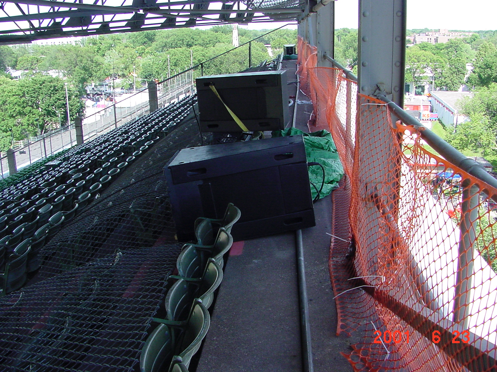

A friend of mine has used four Maltese speakers (horn within horn) for speech and playback at the Minnesota State fairgrounds during hot rod shows. They were placed quite high in the grandstand, but could be heard clearly all over the streets equivalent to around 16 city blocks.
Two amplifiers providing about 100 watts per cone, 50 watts per HF driver were used for that.
I used four of the same speakers with passive crossovers driven off a Yamaha P 2200 at a solar fest in 1994, the meters indicated 10 watt peaks and I could clearly hear the background music as far as I wandered away from my location, around 1000 feet.
Because of the directionality (15 degree HF) you could still carry on a conversation directly below the scaffold they were on.

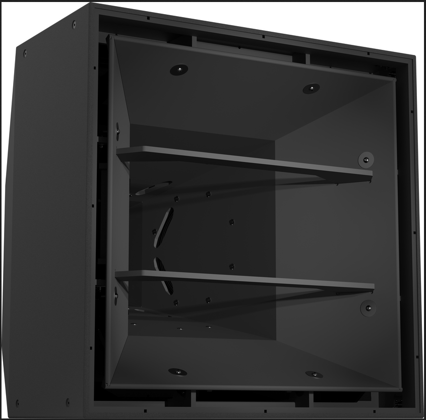

The EV MTS-4153-43FWB is very similar in concept to the 1992 Maltese system, though it uses a MEH (multiple entry horn) rather than "nested" (horn within horn) approach. The 43FWB has a wider pattern, so a pair provide 80x30 degree coverage, while almost 10 Maltese would be required for the same HF pattern ;^)
https://products.electrovoice.com/b..._40x30_FW_blk_Datasheet_51_en_86281757451.pdf

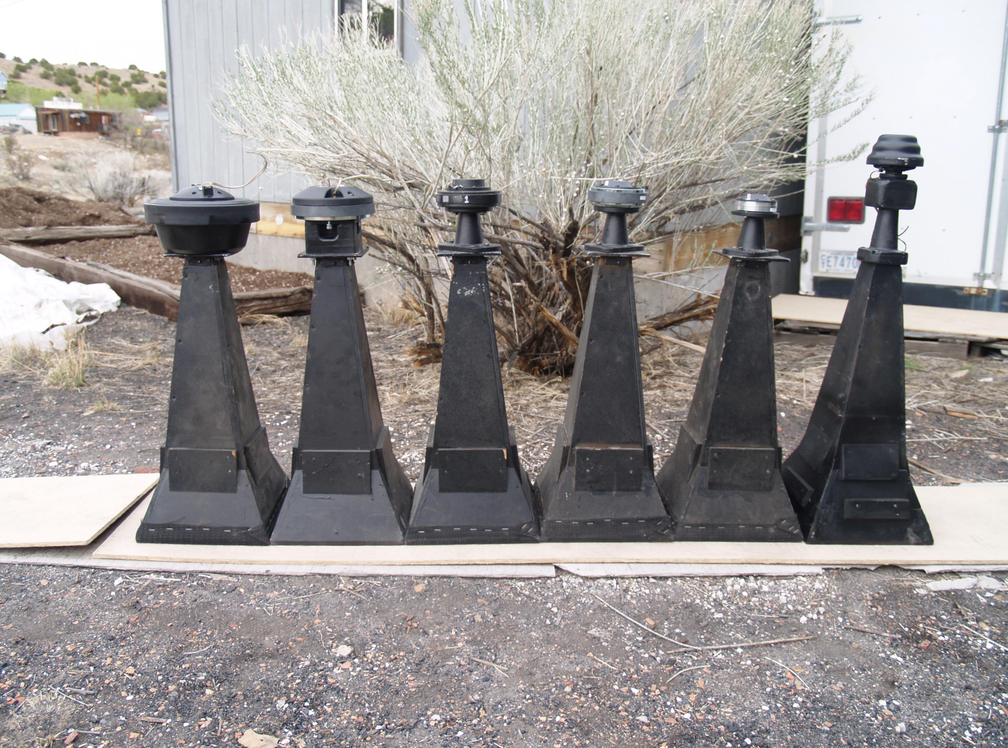

Some photos of the Maltese in the Minnesota State fairgrounds grandstand,A friend of mine has used four Maltese speakers (horn within horn) for speech and playback at the Minnesota State fairgrounds during hot rod shows. They were placed quite high in the grandstand, but could be heard clearly all over the streets equivalent to around 16 city blocks.
and another of the pyramid-shaped "phase plug" that surrounded the HF horn inside.
Art

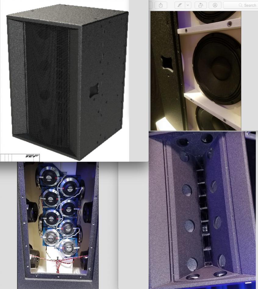

Hyperbolic or parabolic projectors do offer the best "ultra long throw" potential, but the very narrow "plane wave" pattern would require too many units for most applications, horizontal HF dispersion is under 10 degrees.
Rather than the Maltese "nested horn" approach, I'd opt for a 3-way MEH more similar to the EV MTS-4153-43FWB, though for a more cost-effective version would use 4" to 8" cone midrange drivers and standard 2" to 4" diaphragm high frequency drivers, rather than co-axial mid-high drivers.
The DSL J7-95 is a great example of a 3-way MEH cabinet design that would be possible to "DIY" using relatively inexpensive components and standard cabinet construction techniques, yet have loads of output potential.
That said, I'd go for lighter form factor than either of the above two MEH examples, 😉.

The machined metal lens / throat adapters for the HF combined with the sheer amount of thick wood needed for the LF section would put a DIY J7-95 quite far down my list, personally. If you've ever tried to lift one, you'd perhaps also reconsider - that box is great, but I'm fairly sure the only thing more dense is a neutron star 😀
