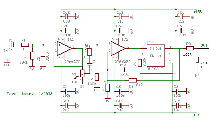

Hello!
I followed up some links provided by PMA.
I was gladly surprised by the stuff I found.
Very nice Amplifier Circuits - REAL DIY HIGH END 😉
I hope our Tjeckish members can fill in with more info
about good Audio Schematics in Ceské Republiky.
😎 Some very good stuff:
RoyalSound - Schematics
Macura AudioPage (PMA at DIYaudio)
Macura has some very low distortion Amplifier Systems.
It is based on local feedback in Voltage Amp
and a Power Buffer.
There are design both MOSFET and BIPOLAR.
Below is just a sample-schematic from Macura AudioPage.
Regards to Czeckia!

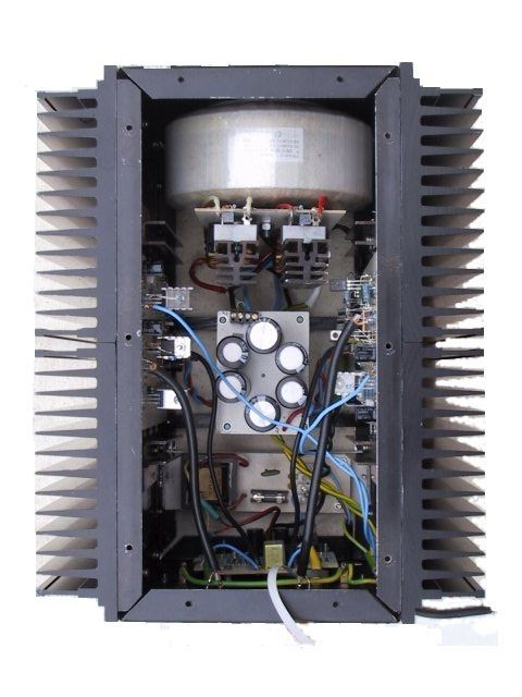

i am glad that someone noticed diy activity in our country, especially pavel's work. his a true specialist, as far as i know hi makes his earning by designing industrial measuring systems where low noise amplification is a must. At Rod Elliot's pages can be found also his simple power mosfet follower A amp.
i think, that dyi lives here, but in form of replication, not self design. i've seen many pictures of homebrew alephs, but i sense, that buying an comercial product in studio is more common case. A Pity. A lot of diy is based on IC design and i don't count that.

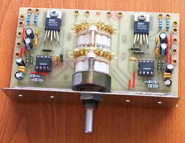

First schematic looks like a headphone amplifier.
I once build something similar and it works really well.
Only the parts are a little expensive.
Especially the BUF634 is a nice buffer for audio use.
On the last picture you sent there is a BUF634 in TO220 case.
I think it´s used for the output stage but can also serve well as a railsplitter where it´s needed. The TO220-version can output 250mA.

BUF634T
This is really a remarkable circuit. Please have a look at http://www.pha.inecnet.cz/macura/buffer_en.html
I can guarantee that in case you build that circuit and insert it into your CD player you will get 2 class higher - no kidding. And do not forget the R12 resistor (current load).
