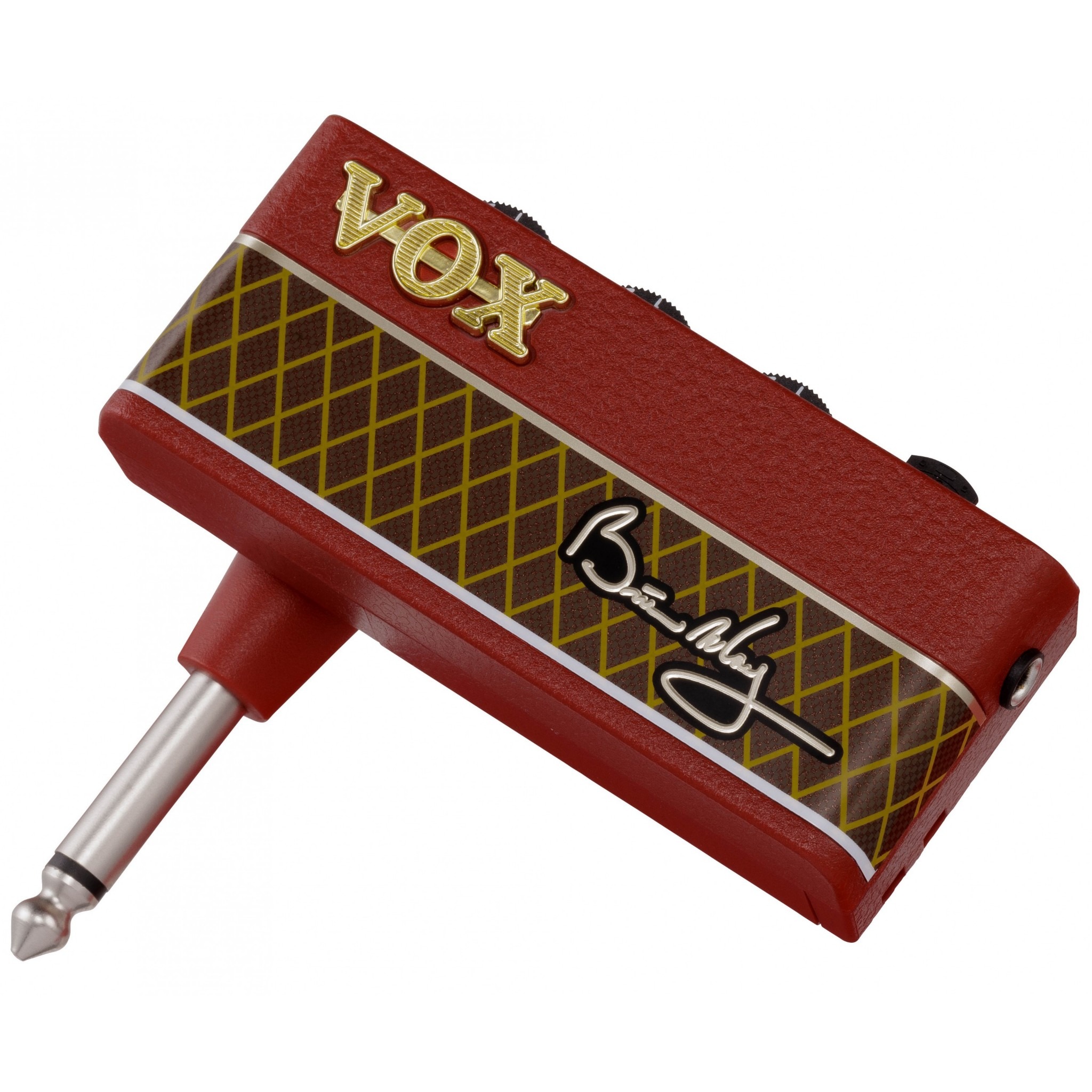

I have a Vox amPlug 2 (Brian May version) guitar headphone amplifier. In normal use, you plug it into a 6.35mm electric guitar input and jam a 3.5mm to headphones in the headphone output. Boom, instant rock star, no need to wake the neighbors.

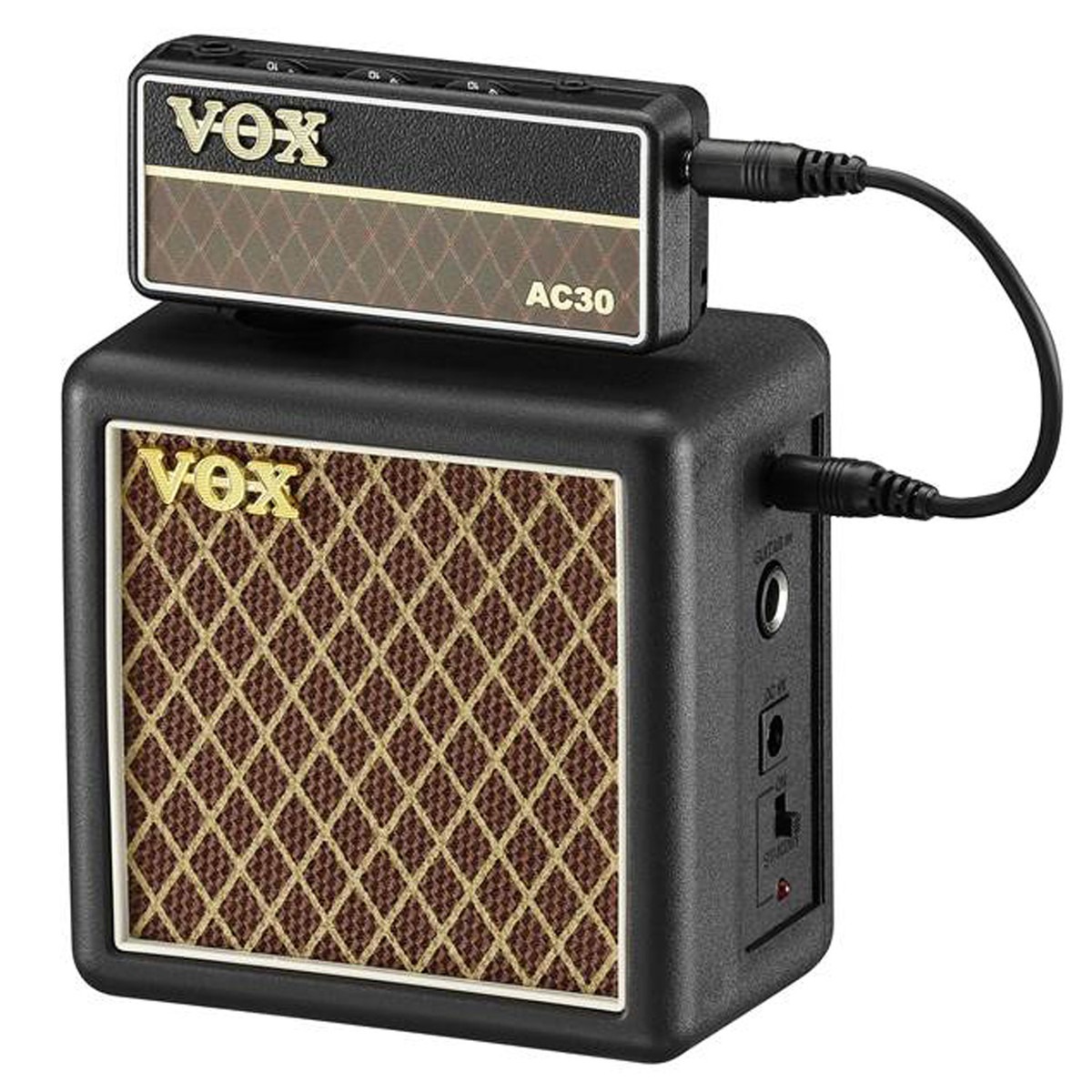

Also available is the the Vox amPlug 2 Cabinet Powered Speaker Cabinet, a 2-watt beast with a massive 3" speaker, with 6.35mm guitar input and 3.5mm aux input, running on 9V or 9V DC power supply. So, according to the manual, you simply run a 3.5mm from the amPlug (instead of going to headphones) out to the aux in on the cabinet.
Ultimately, I want a replication or estimation of this cabinet. I don't need the guitar input necessarily, and I have various sized speakers (2", 3", 6", and a pair of Sony bookshelf speakers).... I just don't know if I would need a preamp or a power amp or just a buffer. Should I see if the amPlug itself will drive a speaker first? This would be a consumer line level signal from amPlug to the cabinet, correct? Would that signal be too great for an LM386 build? Is it as simple as that?

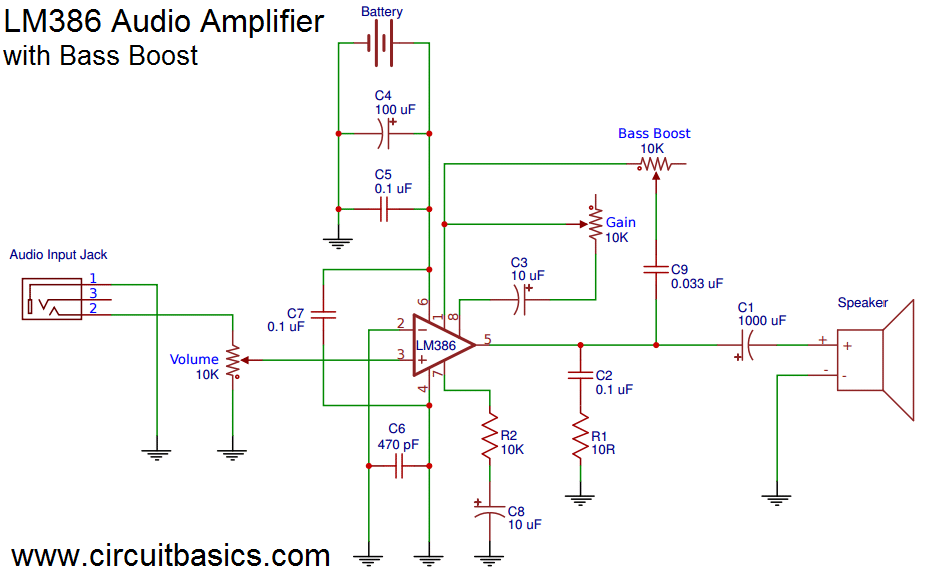

So I found this circuit below surfing the world wide web. I don't know if it's an exact copy but it looks a lot like the schematic in the LM386 datasheet.....I think my regular use of a 1/4-watt, 2.5" speaker while testing circuits may have had me thinking I was doing something wrong when building. I tried a couple different speakers today - that's what it's SUPPOSED to sound like!!!
