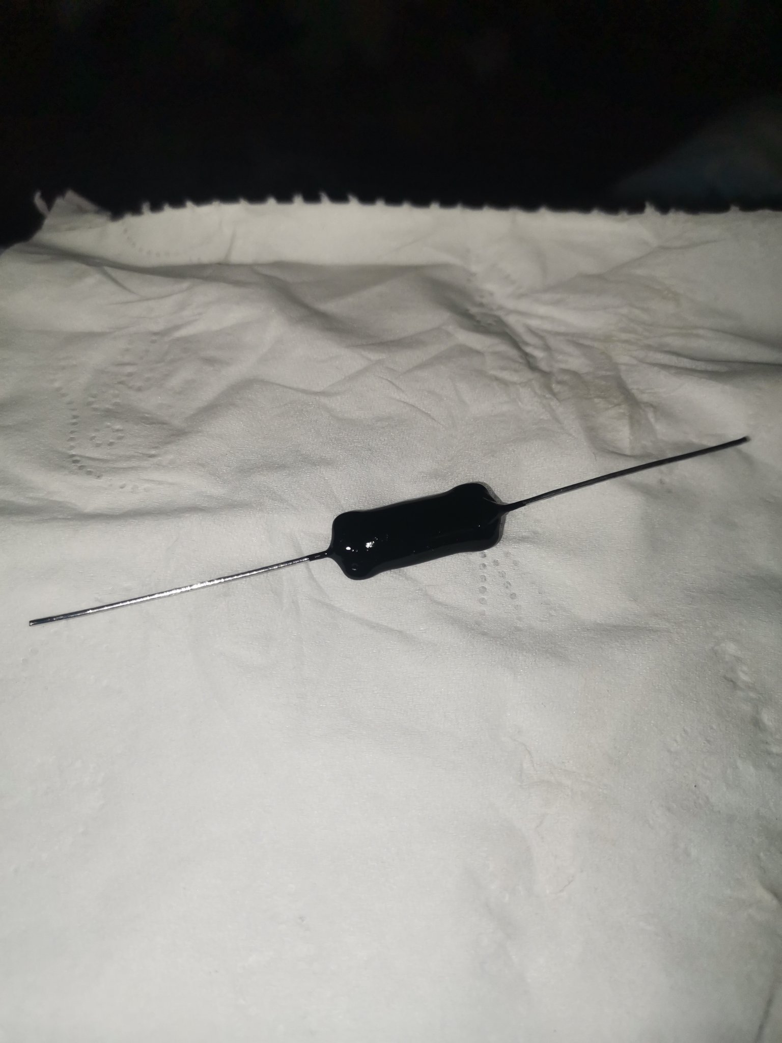

The manufactured resistance sample is encapsulated by epoxy resin and sprayed with black paint.

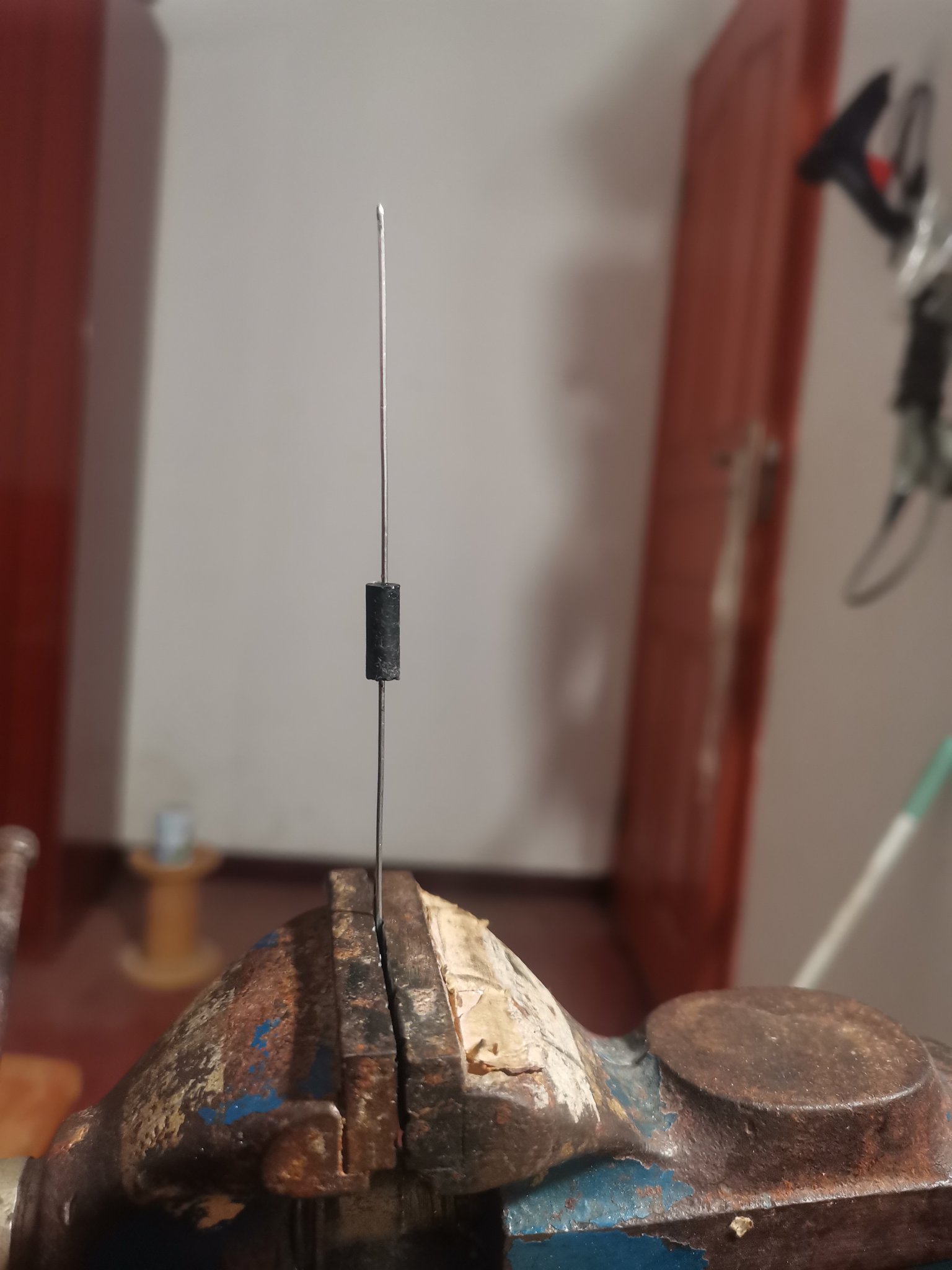

Because ethyl cyanoacrylate glue has water absorption characteristics and poor temperature resistance, I did some experiments in the later stage to mix amorphous carbon powder with epoxy resin, hoping to get a conductive plastic with good fixing performance for carbon powder, but unfortunately the experiment failed-even if I increased the weight ratio of carbon powder to epoxy resin to 1:1 or even higher, epoxy resin could still effectively separate amorphous carbon powder and insulate the whole resin. I have done a lot of experiments, but I can't measure the effective conductive resistance. These experiments were carried out from October to November, 2024. At the last time, I even made a little thing like the carbon core of AB carbon resistor-it was mixed with 60% carbon and 40% epoxy resin, and it was almost impossible for me to get into more proportion before it solidified because it was sticky like plasticine played by children. Even so, however, it still not conductive.
It looks like ab carbon resistor with its shell removed, but it is not conductive. When I put it on the gas stove and decomposed the epoxy resin into carbon with a torch, it began to conduct electricity, but its mechanical strength was gone.

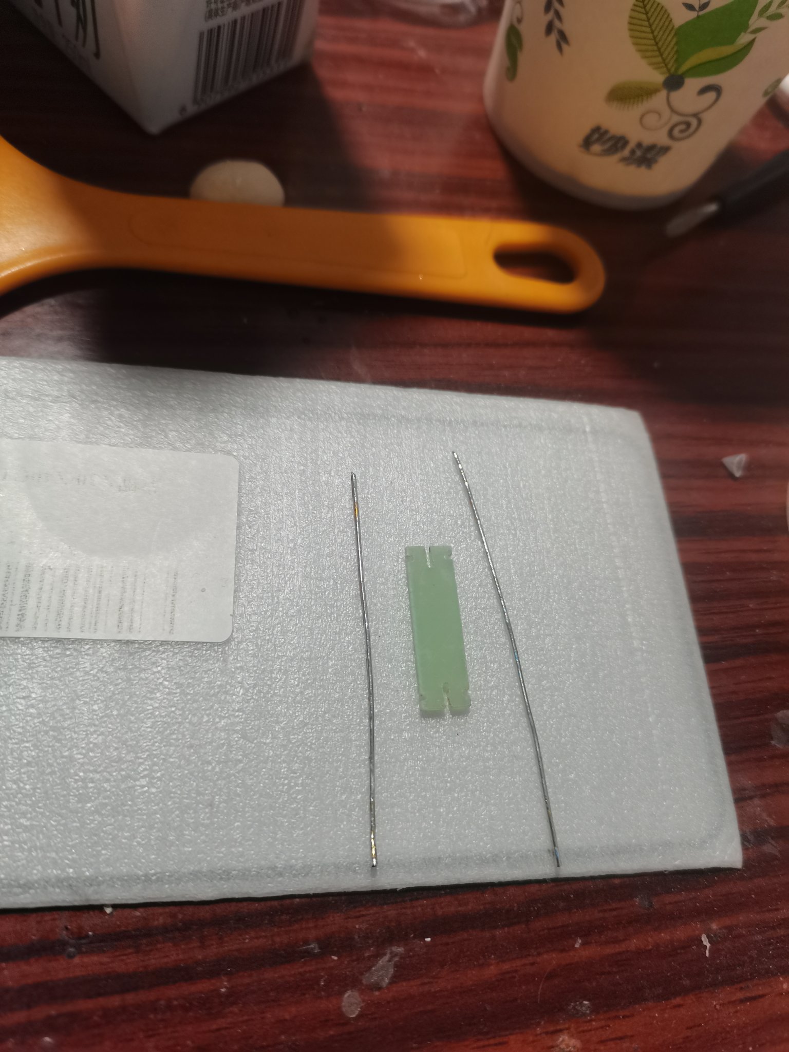

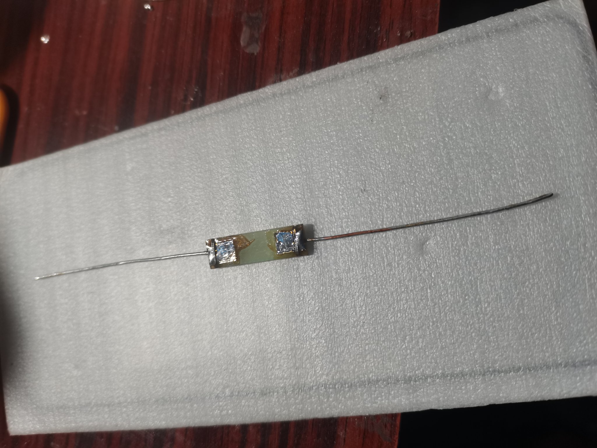

1: Make a skeleton. We choose FR4 as the base material, because the mechanical strength is relatively high and it is easier to process, but be careful of the dust during processing! Please wear a mask to operate. (Based on a well-known global public health incident, I still have enough masks), and this skeleton comes standard with two tin-plated copper pins.
2: Making electrodes. The electrode is made of small thin copper tape, and then it is soldered and tinned with lead solder-lead-free solder will lead to the faster damage of the adhesive on the back of the copper tape, so unfortunately this resistor is not RoHS, and the finished skeleton is not in direct contact with the electrode, but transited through the bundled thin wires, which can reduce the damage caused by stress to this poor resistor.

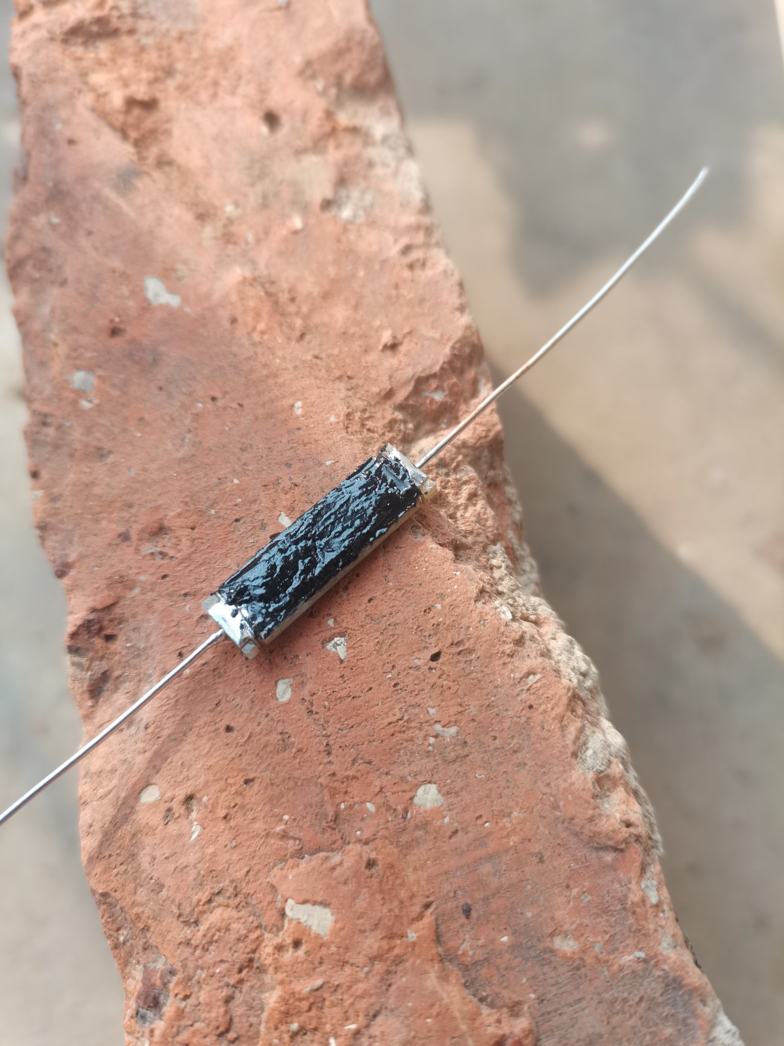

3: Prepare carbon paste, and use hand-made white latex to mix the lamp black collected from the oil lamp (I think the fineness of the lamp black and the crystallinity of graphite particles in it may affect the resistance noise, so maybe olive oil and coconut oil have different sounds? Haha, only God knows. I used rapeseed oil anyway. ), the principle of configuration is to mix a little thinner than plasticine but a little thicker than mud. And then coated on the resistor skeleton.
4: Dry. I may have made a mistake in this step: I used infrared baking in a hurry, and as a result, the surface layer dried too fast, which led to cracking. Maybe it wouldn't crack if it was slower, but I'm not sure whether this idea is correct. When testing its resistance value with a multimeter while drying, it will gradually decay from 22kΩ to 3.46kΩ (this is the result of my work, and 3.46kΩ is probably a stable value after thorough baking). The gradually decaying resistance means that the solvent inside is evaporating.

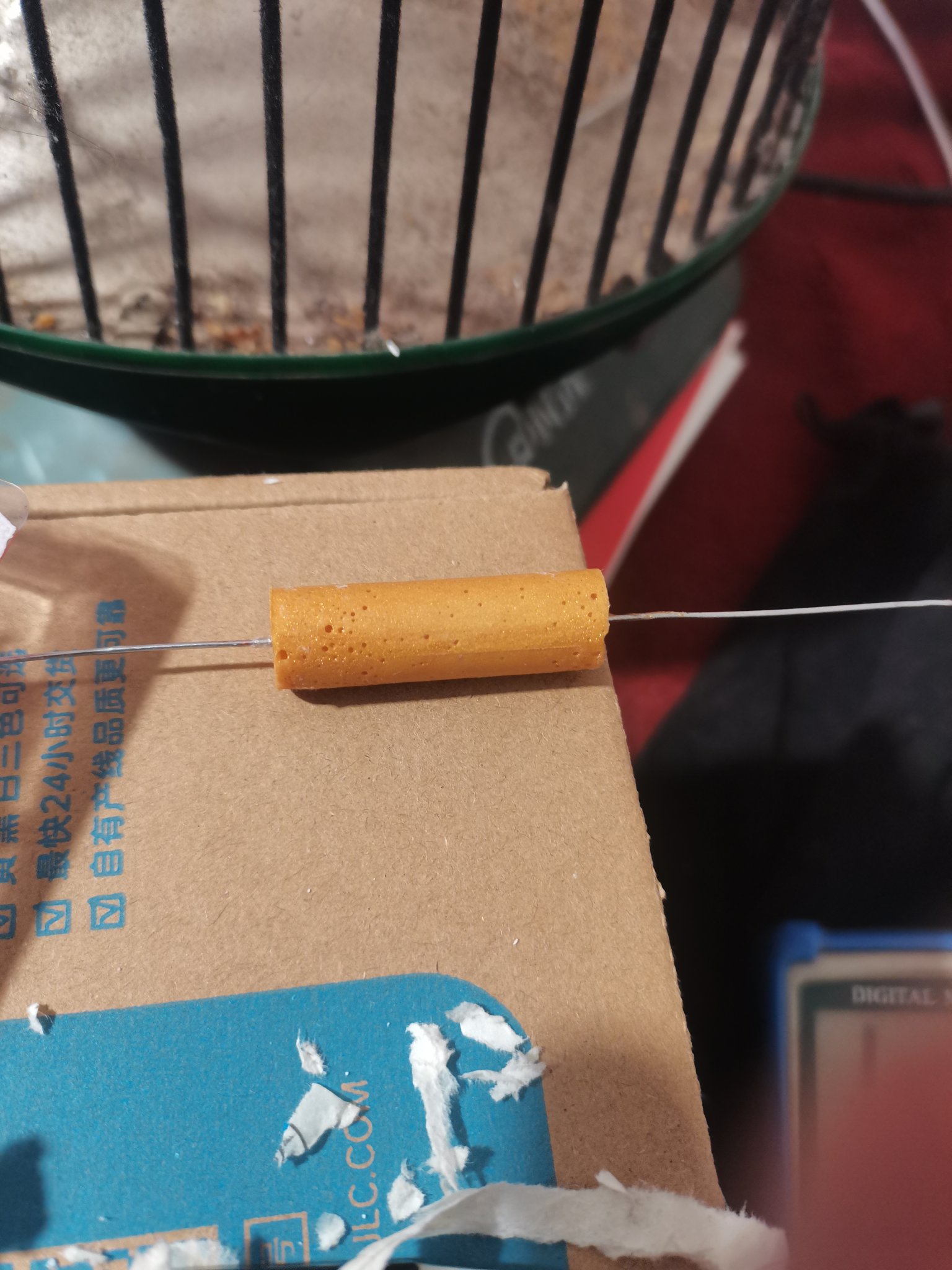

5: Apply 502 glue for curing. Because the dried PVC is an elastic colloid, the dried carbon is not too hard, and the water resistance is very poor. When we apply 502 on the surface, the high-permeability 502 glue will penetrate into the gap and form a more solid plastic structure.

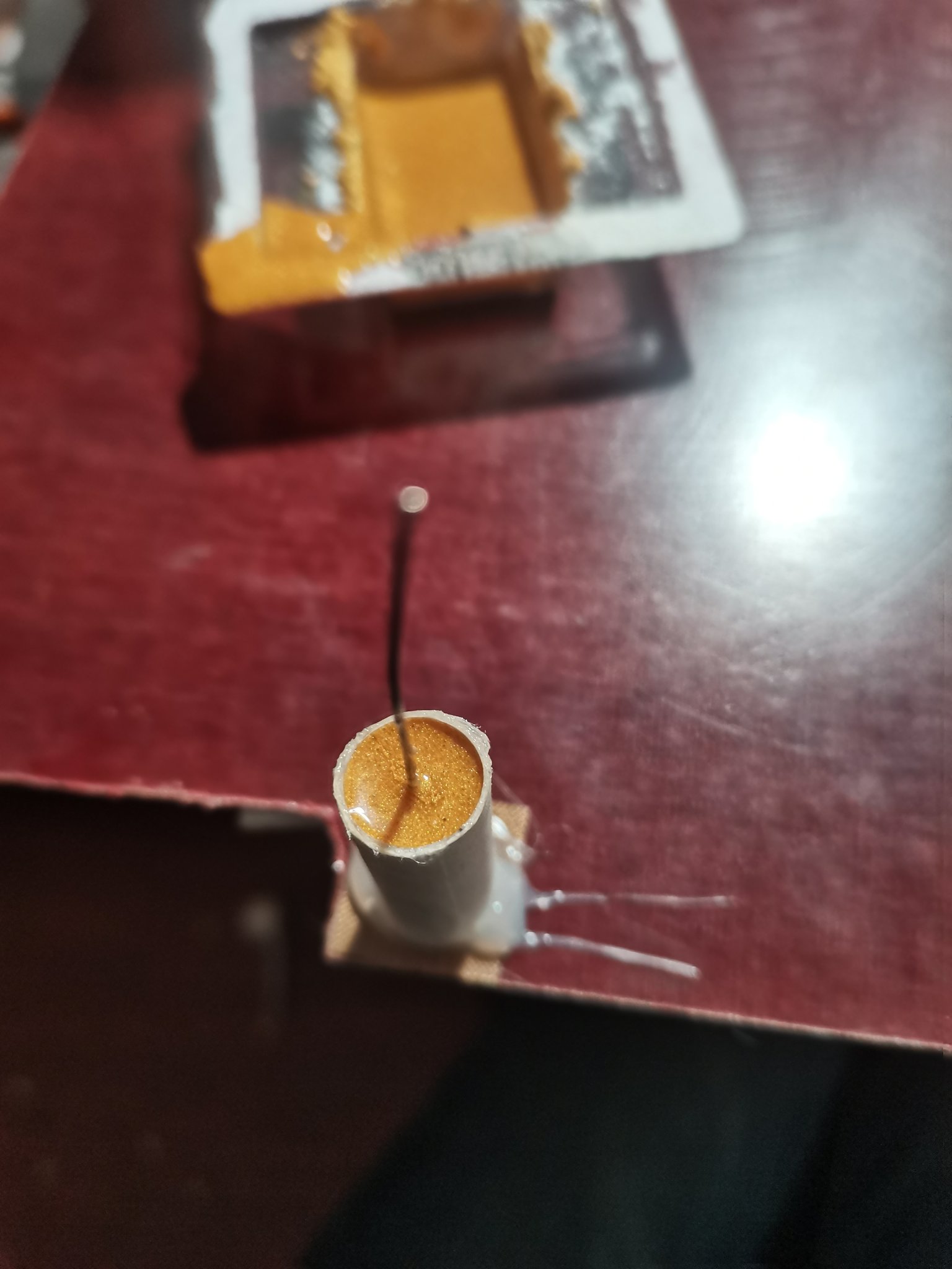

6: Packaging: use transparent epoxy resin, mix silica reinforcement and gold powder dyeing (definitely not Ture gold , because 100g is only RMB three yuan. It's just a special surface-modified micro-powder that can emit golden flash, and it's not conductive.), and then quickly put the heated resistor core into the mold for packaging (the purpose of baking is to drive away moisture, because it is easy to absorb moisture even if it is coated with 502). The shell is made of paper tube, and vaseline is coated inside, so the epoxy resin will not stick to the paper tube.
7: demoulding: after the epoxy resin is dried, the paper shell is torn off, and the complete resistor can be obtained.

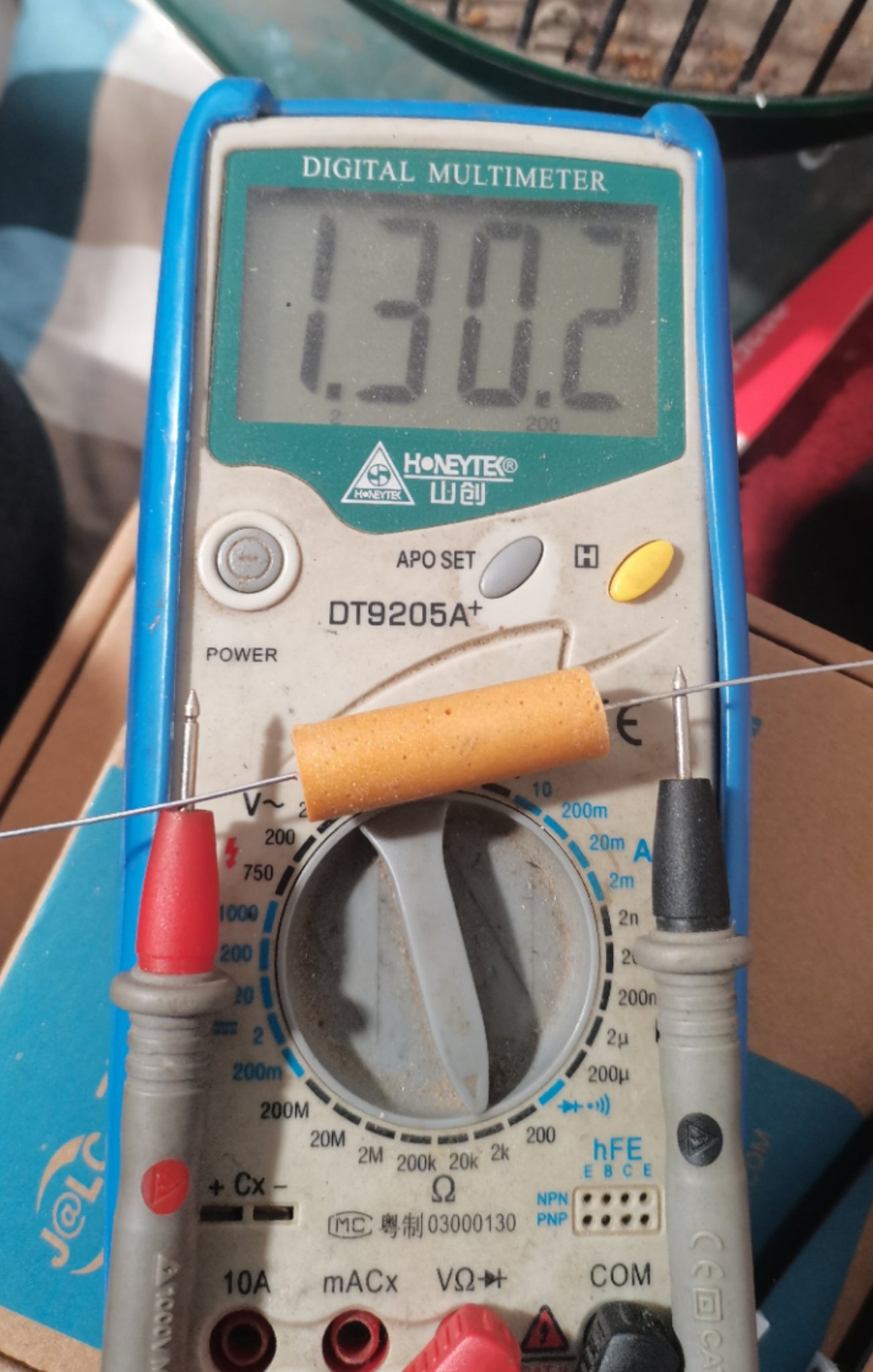

1. Resistance value. The resistance value of the whole resistor changed repeatedly by 100% or even more before the epoxy resin was cured, and it stabilized at about 1302 Ω after the epoxy resin was cured-but I'm not sure that this resistance value has been stable all the time, so I need to test the resistance value and make a test report after storing this resistor for a longer time.
2: Size and power. The size of the package is about D12*L40mm, which is only the plastic part of epoxy resin and not included in the pin. The power is about 0.2W. Based on this resistance has high thermal resistance and low tempture work of organic materials inside.
3: Voltage coefficient. Different from the voltage coefficient of the general resistor in ppm level, the voltage coefficient of this resistor is very outrageous-it can reach thousands of ppm or more, which can bring extremely rich coloring to your audio (if you really need these coloring).
4: Noise, you can hear the noise directly by connecting a 1.5 volt battery in series through this resistor and headphones.

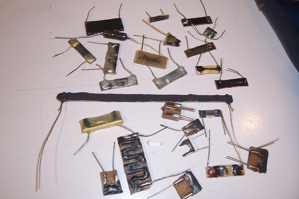

I have tried myself to build resistors from scratch, mainly using low-temp processes, but I have had little success. I sometimes managed to get a half-decent result (reasonably stable values, acceptable tempco and tolerable voltage coefficient), but it was hit and miss with lots of rejects and a result widely inferior compared to industrial types.
Basically, this kind of construction is carbon composition in one form or another, and it comes with its inherent weaknesses. I have tried to replace the carbon with other materials, like tin oxide, with varied results.
I have also tried to coat a ceramic substrate using a chemical solution to leave a resistive film, but it was also hit and miss.
Finally, I used the plasma generated by a Tesla coil to "bake" a quasi-insulating mix of an organic binder and carbon powder, to make it resistive, again with semi-random results.
Tomorrow, I'll try to post pictures of my attempts.
In the end I managed to make a good one that I used in my ion-chamber project, but that was a lot of work for a meagre result.
Without vacuum technology, high temperature ovens, ion sputtering equipments etc., it is difficult to arrive at a usable result.

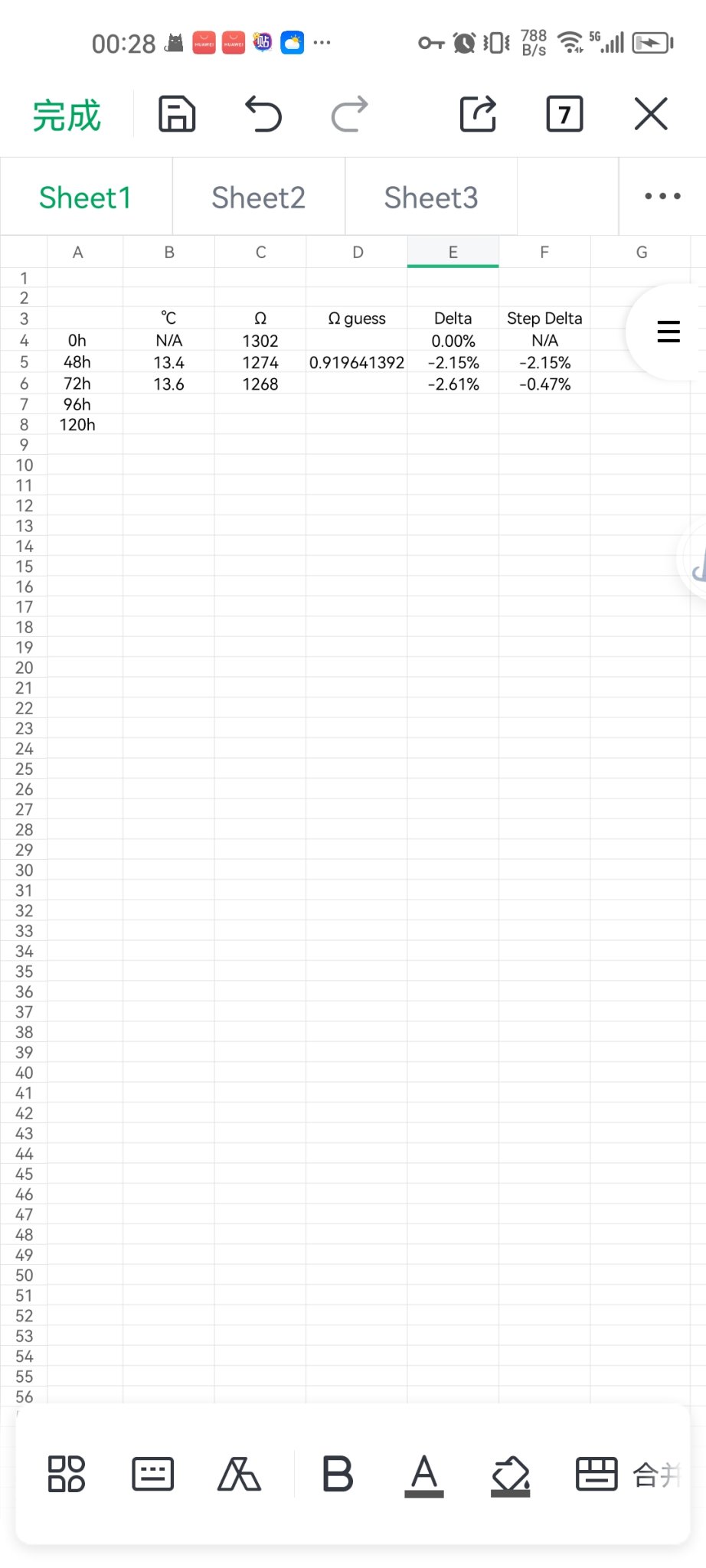

48 hours and 72 hours after the production, I tested his resistance respectively, and the obvious resistance value decrease which can not be by of multimeter error. I suspect that it is caused by the epoxy resin polymerization shrinkage force pressed for the organic carbon cured product with low strength. After 48 hours, the resistance decreased by 2.14%, and after 24 hours, it decreased by 0.47% on the basis of the above, reaching -2.61%.
I think that the added silica micropowder and shiny mica microplate pearlescent gold powder have played a role in controlling the thermal expansion rate of epoxy resin, and the temperature difference between the two tests is not big (the temperature was not recorded for the first time, and the temperature for the next two times was read by a precision mercury thermometer that can be vaguely read to 0.01 degrees), so it is more likely to come from the release of stress in the later period after shrinkage.
With reference to the standards for resistors such as MIL-STD-202, MIL-PRF-55342, GB/T-5729, JIS-C-5202, it maybe possible to keep this resistor in “cold, normal temperature and hot” cycles for many times, which will make it aging and stable faster. At present, I am doing this project-put it in a dry bottle and put it in the refrigerator for 12 hours (the purpose of putting it in the bottle is to avoid the harm of condensed water later), then take it out and store it at room temperature for 3 hours, then bake it in the oven to 50 degrees, and keep 1h,end for one cycle, and repeat it for 5 cycles or more, hoping that it can age quickly-the aged resistance will be relatively more stable than it is now, so it may have real practical significance to marked for it in that time.
