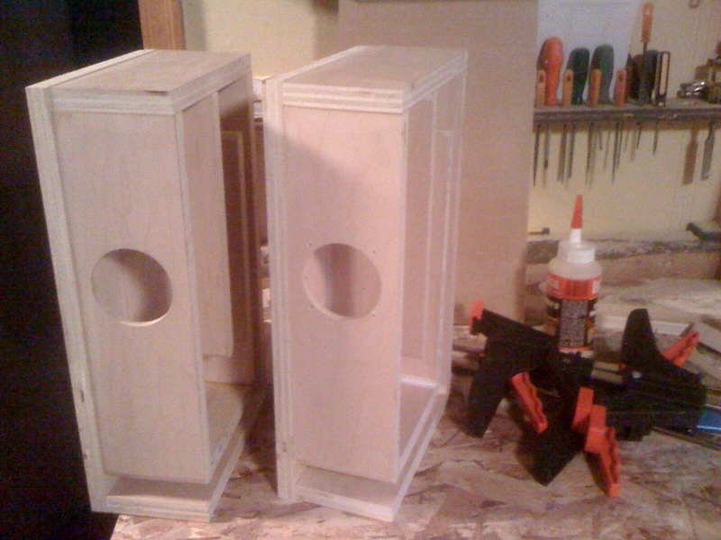

Dave,
A little influence 😉
Its a 35 litre with the usual irrational number use.
The 3 ports are 4" long.
Also the driver is mounted 7-5/8" from the top (internal).
I was looking at the Fostex recommended BR, the port seems very long.
Josh
Josh
