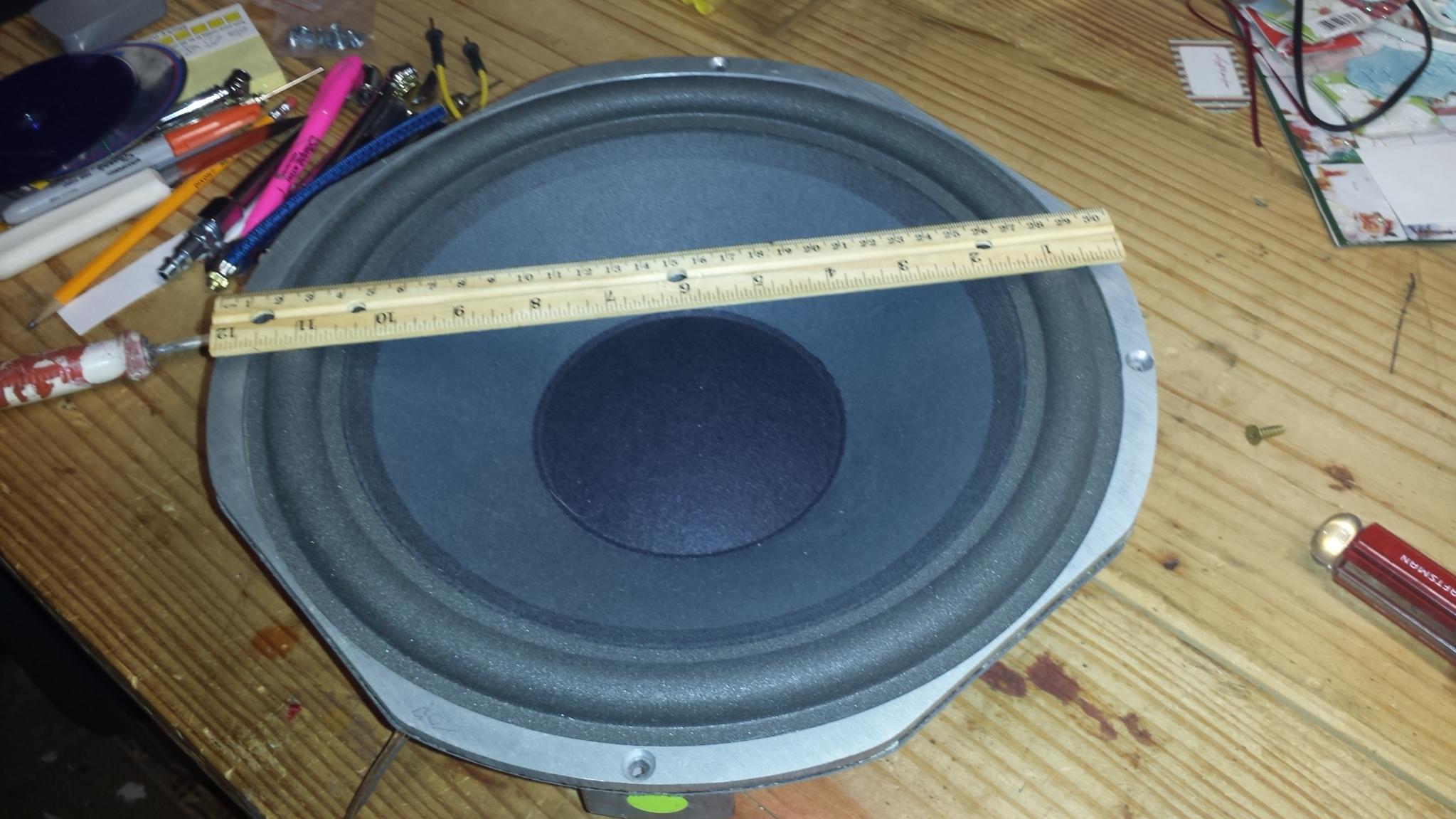

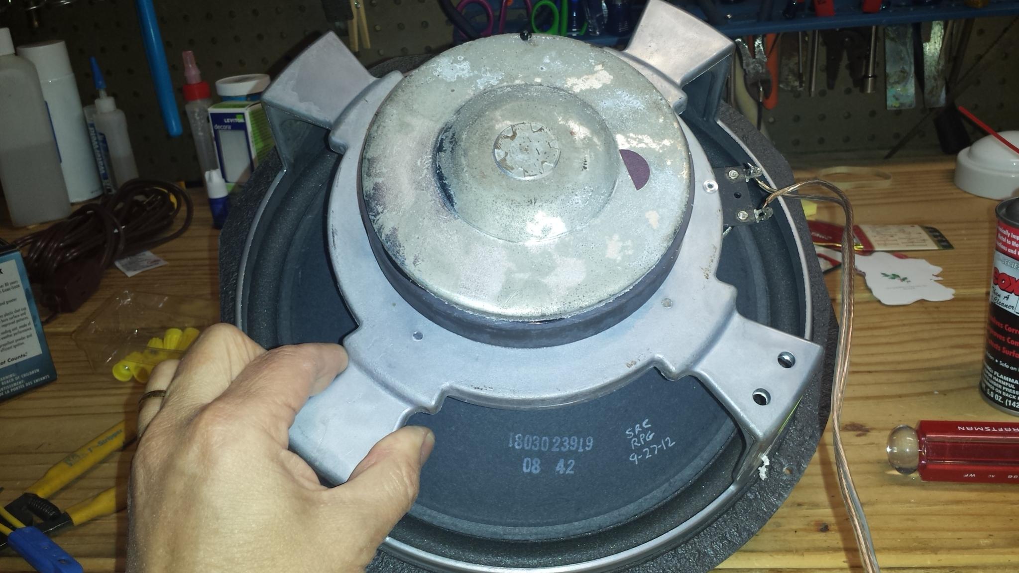

sorry - was not able to get photos last night - the drivers are clearly 12" and recently had them re-foamed - parts express did it - sent the crossover to ess in California to be refurbished - which they did- can get photo of that too

Great news, you have the 12". So it's not from the ESS AMT-1, but from a model similar to the ESS AMT-1b/ESS AMT-1e or any other (posterior?) that I'm not aware of.
What material was used in the new surrounds, foam/originals or more recent rubber ones?
They didn't measure the T/S parameters did they?! 🙂

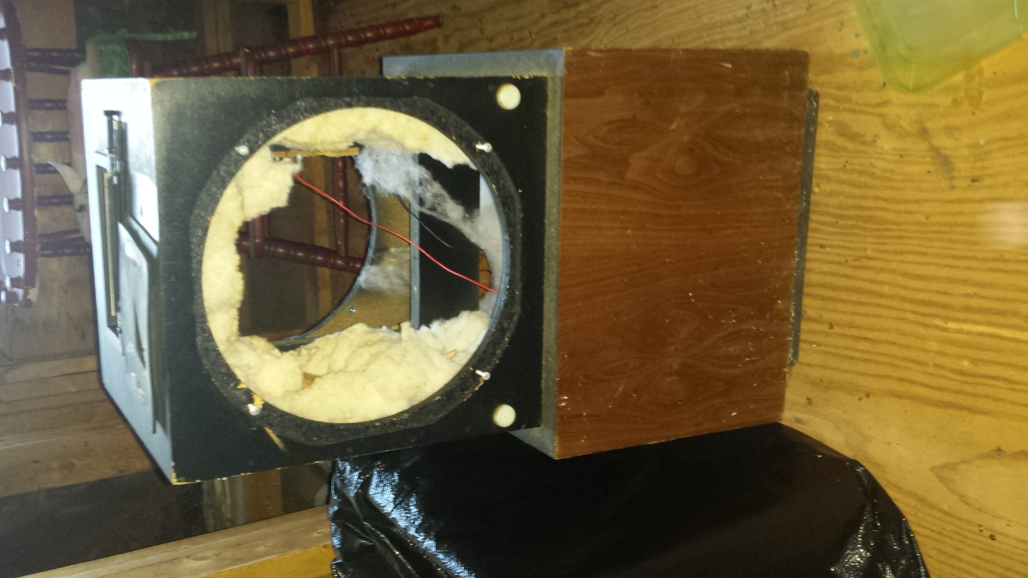

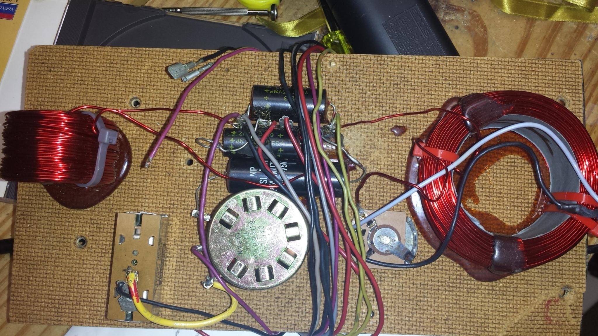

ok - here are the photos - btw both woofers are solid at 4 ohms - one tweeter is 3.7ohms and the other is 3.5
the crossover claims that they are ESS AMT 1a's - they did have the passive radiators - I dont have them
I am tempted to try to restore the old cabinets and buy new passive radiators which I don't have - I just like the idea of "repurpose and improve' rather than restore.

ESS AMT 1a
ESS AMT 1a | Owners/Service Manuals, Schematics, Free Download, Reviews | HiFi Engine
