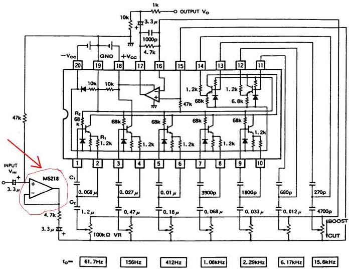

Ok, so I'll go with this circuit.
But I still don't understand two things.
1. Does one have to use all the seven bands, or does it work ok if you just hook 2 band upp and leave 5 floating?
2. What is that amplifier circuit in the diagram(arrow)? and do you really need it. I can't find that circuit M5218 anywhere!! Can I use something else maybe or just skip it?

That is an opamp in a unity gain configuration (an input buffer). It is there for stability. I personally wouldn't leave it out, but the Opamp (M5218) could be substituted for a better sounding one (such as an Analogue Devices / Burr Brown item)
Edit:
I do not believe you could leave the bands floating as they seem to be set frequencies. The bands are far too narrow for just bass/treble. You could leave the central 5 set at 'zero' but I'm not sure it'd sound as you might expect!
Hope this helps,
Gaz
Thanks for the great answers!! I'll do as you say and use resistors as substitute for the the pots.
Now there's only one thing in this schematic that is troubling me, the op-amp. I can't get that specific component, but if you'd know about some other op-amp, preferbly from this list :
http://www.elfa.se/elfa-bin/lt.pl?sort=&pics=&1860017&1860019&1860063
it would be great cause then I could get started building!🙂)
Or, the very simplest thing for me to do would be to entirely leave it out, even though the results probably wouldn't be that great🙁

You can infact use not all seven bands. Each band consist only of a emitter follower and I don't see why you only just exlude 5 of the bands but then I think make a traditional tone control is better (sounding).
LF356 is an ancient opamp, works though but somewhat noisy.
If you deside to make a traditional tone control, use an OPA134 OPA2134.
