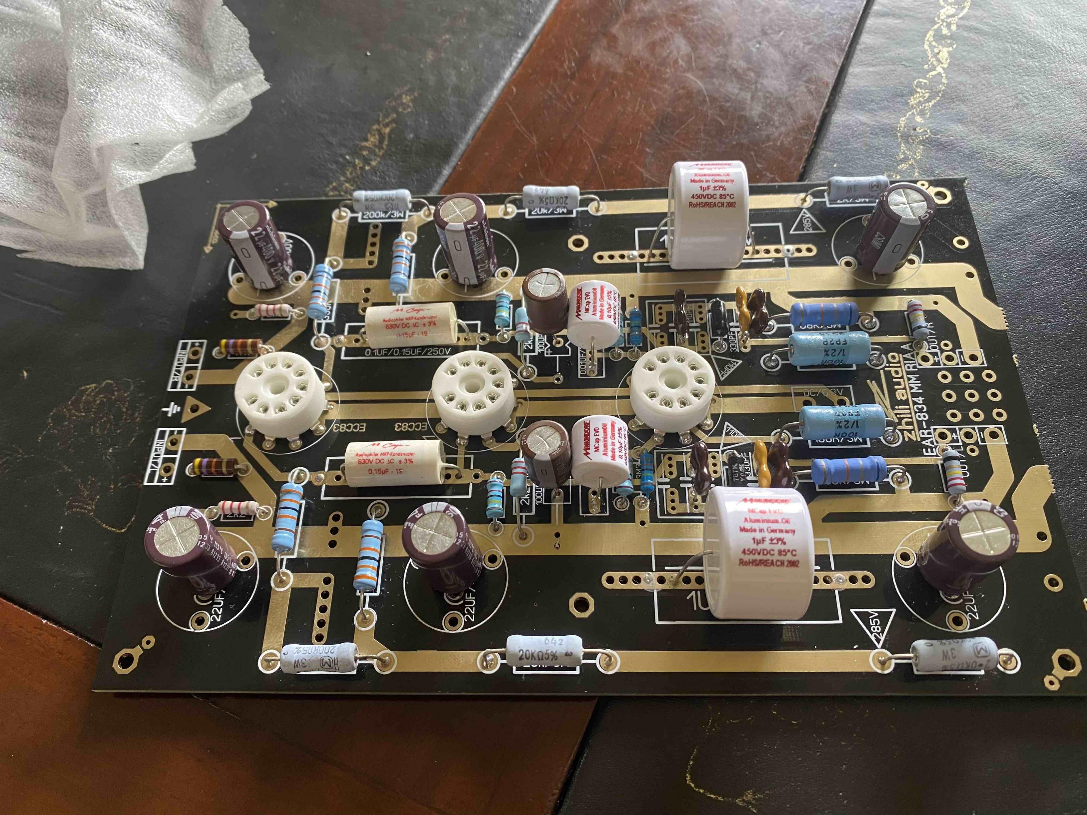

I have one of these PCBs on hand, leftover from a custom build for someone else that fell through. I don’t recall there being a choke on the BOM. Is that a part you sourced yourself?
No. I watched some of your videos in hopes that you mentioned the part number of the power tx and choke by name but I don’t think you ever did (note: I have not watched 100% of the videos). So I went to your website and read the choke model # off a picture you provided where it was discernible. Otherwise, I am using the BOM provided here, which agrees with your choke selection: https://www.lencoheaven.net/forum/index.php?topic=26658.0
