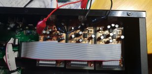

Other things in the box are the power supply and header breakout for the ADC and DACS...
Not a lot to say here, supplies power and stops cables getting too out of control. Again I sent this PCB off to the fab, as I tend to do a bunch of audio stuff from the PIC, eg my signal generator uses this, as does my PC based distortion meter.
The ADC plugs onto the power supply PCB. Samples data rns across the ribbon cable (every second wire earth) to the power supply board, then back to the PIC.
The PIc sends SPI / I2S to the DACS, two of them in this case, again via the power supply PCB.

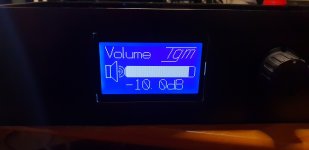

The user interface is on a 128 by 64 LCD, and is about as pretty as an engineer is likely to make it...
Volume control, with bar graph. In this case I am doing volume digitally. The tests I did against analogue volume chips showed that a CS4398 generates less distortion (if you can measure either of them). Its not that the analog chips are bad, but that the CS4398 is really good!
If you look on the right you might see the unloaded spot for the volume chips...
Save,Load config, Set up crossover, PArametrics.

As you can see those boards are home made - the input and output op amps are either NE5532 or LM4562, which in this implementation I cannot tell the difference between even using fancy test gear.
All up this is probably $200 of stuff from my shelves, and a ton of time.

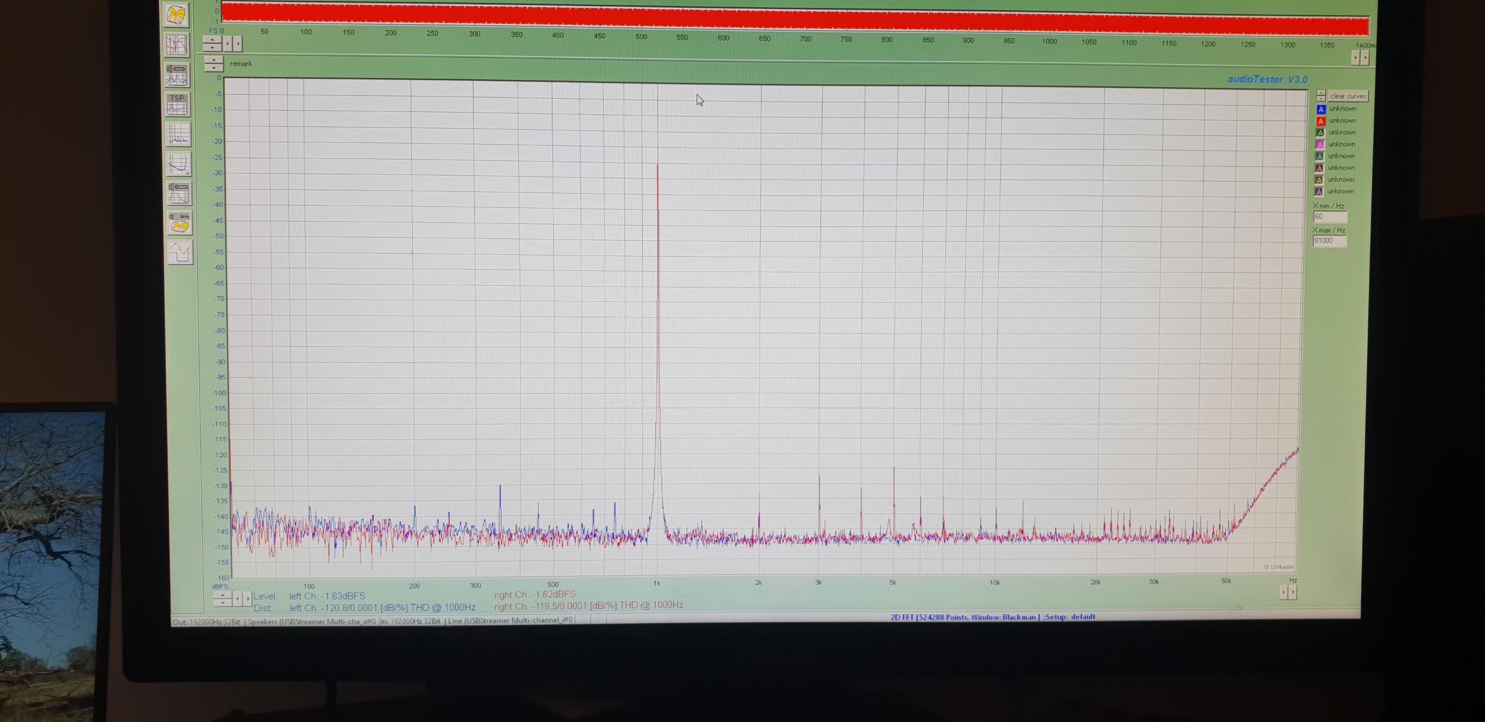

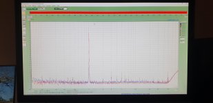

Some brief measurements.
I have not tried to optimise the levels etc here, other than using a level that gets good loopback on the distortion meter.
The optimal level for the DSP is likely different, but this will give a pretty good idea of what happens when you throw it into the test setup.
-1- Loopback
-2- With DSP XO in the loop
-3- How the connections were made.
Loopback perfromance of the distortion meter
With DSP XO dropped in (blue channel is out, red in.)
And the connections
Comment:
Moving the ground reference of the measurement channel from the input (ADC) to the output (DAC) card makes a 10dB shift in H2.
These measurements exclude noise.
There would likely be improvements with fiddling with levels, but I see it like: you dont get that choice in real life so how much difference does it make?
At 0.000X percent distortion I am pretty comfortable this will be OK.

Kaffimann,
I am not planning or even really expecting to get anything useful with really low THD. It is more of an intellectual pursuit than anything.
on PSRR....
- power ampplifiers, at least those designed by sane people, use negative feedback to reduce the impact of this. It works, at least in the audible spectrum.
- Preamps - it is as you note pretty straight forward to maintain decent rail integrity here, and that combined with decent layout and NFB should do the trick.
The issue I see in measurements is earthing and the current paths you get if you connect inputs and outputs with multiple earths. The concept of the "earth" being a single reference plane is not true, and if you connect things such that currents flow through paths other than those you designed it for, spurs jump up everywhere.
So the simple act of connecting a distortion meter with an output (and earth associated with the DAC in the signal generator chain) and an input (AC with associated "ground reference") means you have lost control of where the two notionally "the same" but in fact different "earth" reference points connect.
By using balanced inputs on the ADC chain of the distortion meter this reduces the earth connection to a single point.
Even then though, where on the DSP you connect the earth reference balanced input maters.
Remember that -120dB relative to one volt is 1 microvolt.
If the device is driving say 10K at a volt, this is 0.1mA. You can generate 1 microvolt across 0.001 Ohms at 0.1mA... Now throw into the mix op aps and ADC / DACs with all manner of funny currents flowing... Reference points become critical.

Emilvv
Sure I can share the files. I will need to package them up, and remember this is not for the faint hearted!
- The PIC32MZ is a simple board. PCBCART made these and I imagine you could get more for a few bucks. It does use SMD.
- The PSU board is really simple. Again PCBCART has this.
- The ADC and DAC again use SMD. I dont think the latest version of these went to PCBCART, as the ones I pulled off my shelf were made at home. I have done the ADCs and DACs with PCBCART before, but these have lower THD.
- The LCD is standard off the shelf.
Fundamentally you could use the PIC32MZ and PSU and "bring your own" ADC or DACs. I designed the ADC and DAC boards to have a simple interface with:
- Power
- I2S (MCLK, LRCLK, BCLK, Data)
- SPI for the volume control (not used here)
- lots of ground.
I have built ADCs and DACs using both CS and AKM parts using this boarf form factor and interface allowing me to swap them in and out of gear, looking for "better" performance. (though this was in my distortion meter!).
So pretty much ANY ADC / DAC you can set up to work at about 48Ksp would work fine.
If I were doing this as a "project" to kit up, I would be sorely tempted to integrate the ADC and DACs onto one board, and put the PIC on the PSU board...
- Power
- lots of ground.
