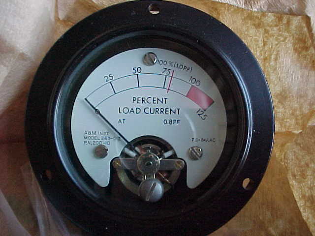

You need to determine the characteristics of the meter. Has it a built in shunt or series resistor that needs removing.
You can either do active or passive. Passive is easy, but not so sensitive. Active as expected uses some additional powered circuitry such as,
Peak Reading Audio Level Meter
Passive and active here,
VU And PPM Audio Metering
