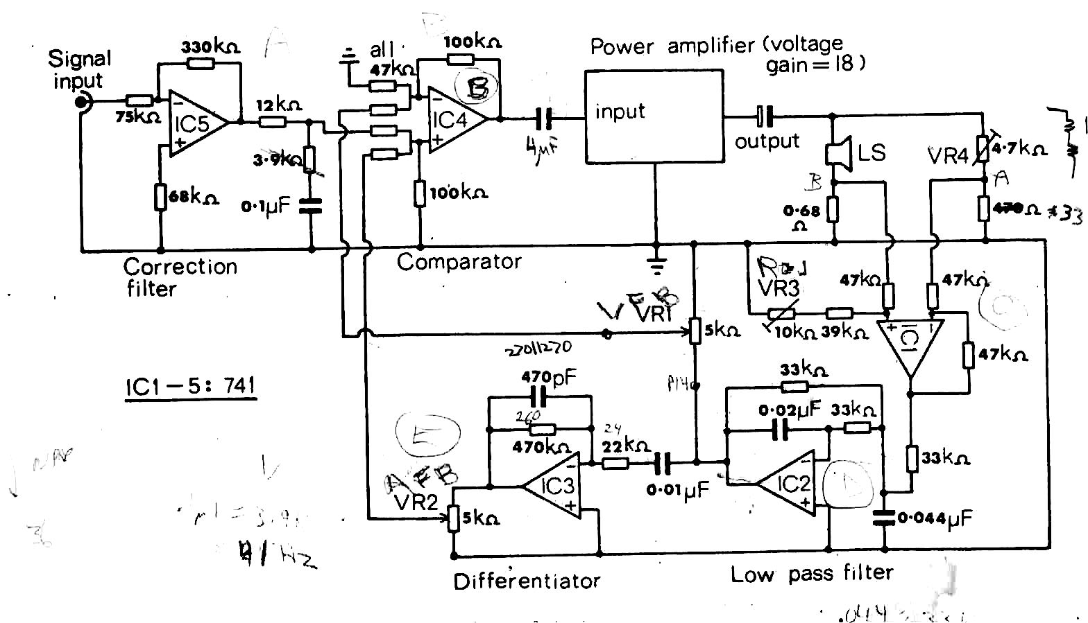

Bentoronto, would you happen to have any examples of circuit diagrams for the current feedback circuit? How hard would it be to tailor it to a particular amp/driver combination?

Bentoronto, would you happen to have any examples of circuit diagrams for the current feedback circuit? How hard would it be to tailor it to a particular amp/driver combination?...
No special amp or driver needed. Some folks also think any kind of box (or no box) will also work fine. Amp does need good low freq output (phase and power) and maybe 25 dB voltage gain, so even tube amps work nicely (and won't destroy your driver, see below). You must become bi-amped of course.
Sorry, no circuits close at my hands this moment but several out there. Nothing but a .5 Ohm resistor, (or less if 4 Ohm driver) an op-amp, and a 6 dB/8ave bass boost. If you need too much more info than that, you may not know enough to keep from destroying your driver with the power of erroneous feedback (please don't take that "personally").

Attached is a schematic for a variant using a Wheatstone Bridge. Not sure bridge adds anything to ordinary current feedback but helps get articles published in journals. The "differentiator" is just EQ and better handled in your DSP/XO. Not sure you need anything but the first IC and a pot.
I built it pretty much identically, worked fine for a few decades.
Like I said, you can use any ordinary driver and any ordinary amp.
Reference: C J Adams and R. Yorke, Motional feedback in loudspeaker systems. Monitor - Proceedings of IREE, March, 1976. Article says it all and more.
