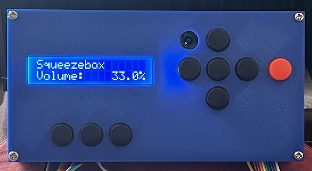

So I've had a go at building my own controller, to achieve all of these features. Hypex technical support have been enormously helpful, and furnished me with schematics for the original controller and the DLCP (for the RJ45 pinouts), as well as a description of the data protocol between the controller and the DLCP. I set about breadboarding a full controller replacement, with the following design goals:
1) All buttons to have a fixed function - e.g. up/down for volume, left/right for channel selection, centre for mute - and the display should always show both the selected input and the volume. This inevitably means that the 'setup' options in the original controller won't be implemented.

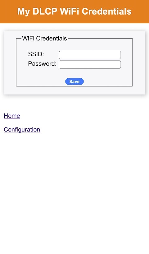

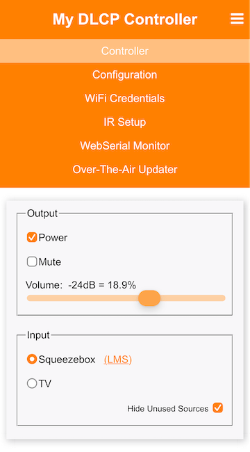

2) A wifi enabled processor, running a websocket application so that any connected clients will always see the up-to-date status of the amplifier.

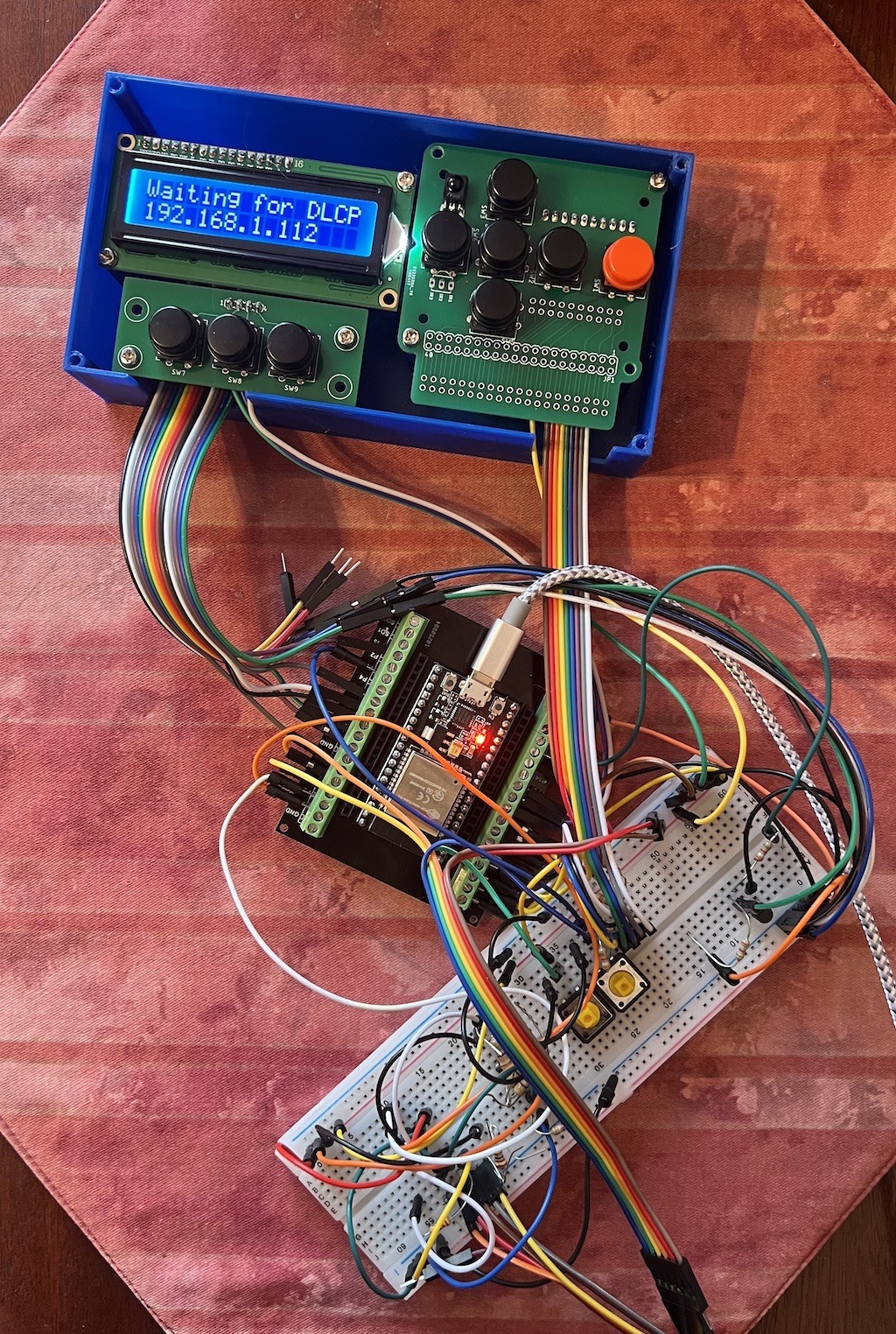

My proof-of-concept breadboard system uses an ESP32 development board, and an awful lot of jumper wires to implement all the necessary circuitry. I had a button board PCB that I'd developed previously (for a my piCorePlayer) to mirror the layout of the DLCP controller buttons, and I bought a 16x2 display to match the original. I also had a 3-button add-on board that I'd made for use with the piCorePlayer (for preset playlists etc). The controller uses MIDI to speak to the DLCP, so to get me started I bought a couple of MIDI CHIPs (from Roxxxtar Productions: https://www.roxxxtar.com/badassmidi-midi-chip), but once I was up and running I replaced the MIDI CHIP with discrete components. These parts together have allowed me to develop the ESP32 software to a point where I'm happy that all the design goals can be achieved.

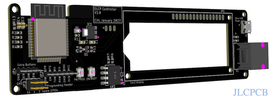

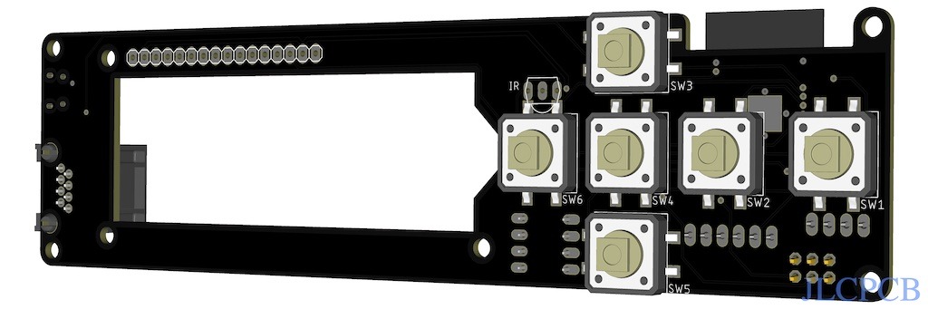

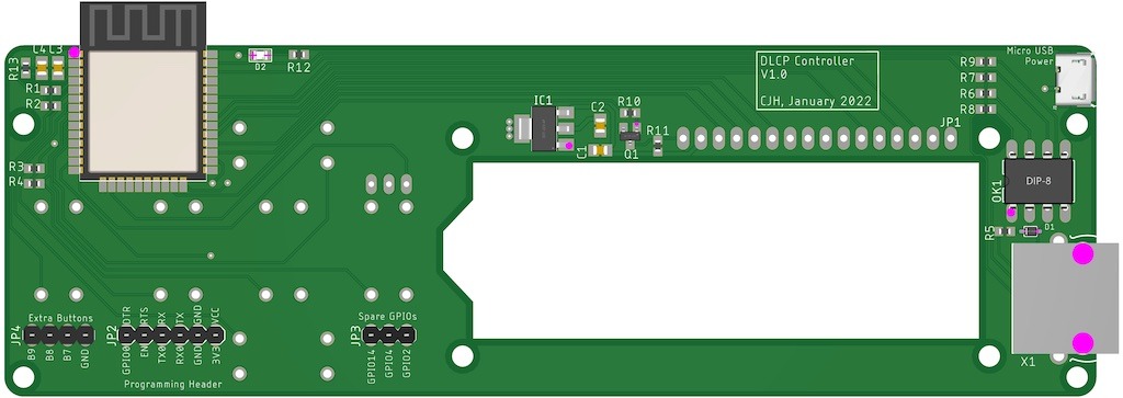

I've now designed a PCB to replace the rat's nest of jumper wires and integrate everything into something that will use the same mounting holes as the original controller. For my first version, a couple of issues prevented the PCB having exactly the same footprint as the original. Firstly, the ESP32 module is not quite as compact as the processor that Hypex used, so the PCB had to grow in height by approx 8mm, and the ESP32 antenna sits a further 8mm above that. In my amplifier's encolsure, there is room to accommodate the necessary extra 16mm of height. Secondly, the ESP32 draws a bit more current than Hypex's original processor - more than the 100mA available on the RJ45 connection from the DLCP - so this has required me to provide an additional power connection. I've used a microUSB connection for ease of use, and I plan to feed that from the 5V supply I included in my amplifier build to power my Raspberry pi 4B - it's rated at 2.3A, so there should be enough spare capacity. Other than that it should match the original: mounting holes, LCD display location, buttons and IR receiver. The first version of the PCB has been ordered from JLCPCB - It should be here in a week or so, and will require very little assembly when it arrives. I've requested them to do all the SMD soldering, so I'll only have the push buttons and IR receiver to solder in, plus the 16x2 display. Unfortunately I made a bit of a blunder with the display, and didn't make sure to keep all other components out of the way of the display PCB, so for this first version the display will be mounted in front of the PCB, rather than behind, so will protrude a little further forward than the original. Not a show-stopper for this prototype though.
When version 1 arrives I'll figure out what else I did wrong and incorporate any necessary changes into version 2. I already have a work-in-progress V2.0 design under way. I've changed the through-hole push buttons to SMD, which has given me a lot more flexibility over component placement on the reverse. This has allowed me to reduce the PCB size to exactly match Hypex's original, and I've moved the ESP32 antenna within the overall footprint by clearing out a section of the PCB around the antenna. I've also added a couple of miniature push buttons to help with programming the ESP32 - not strictly necessary with a fully wired serial adapter, but there was room. I have no idea how well the ESP32 antenna will work inside the metal case of my amplifier. As noted, mine currently has a wooden front, so reception should be ok, but ultimately this will be replaced by a machined metal front. I do have the option to specify an ESP32 module that uses an external antenna, and I've even read of a hack that's possible to fit an external antenna to a module that includes a built-in antenna.

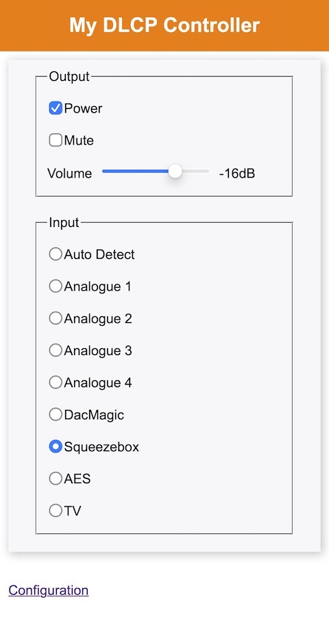

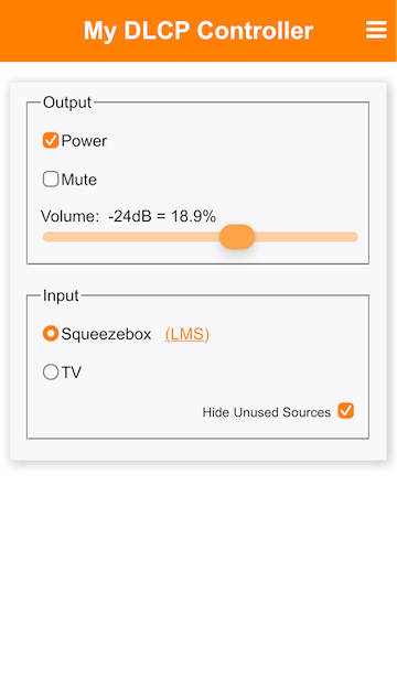

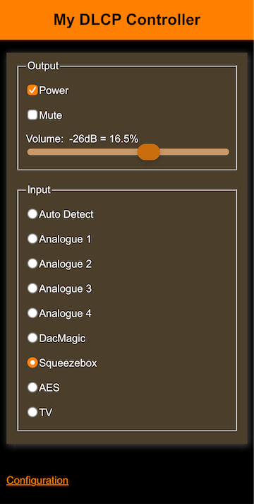

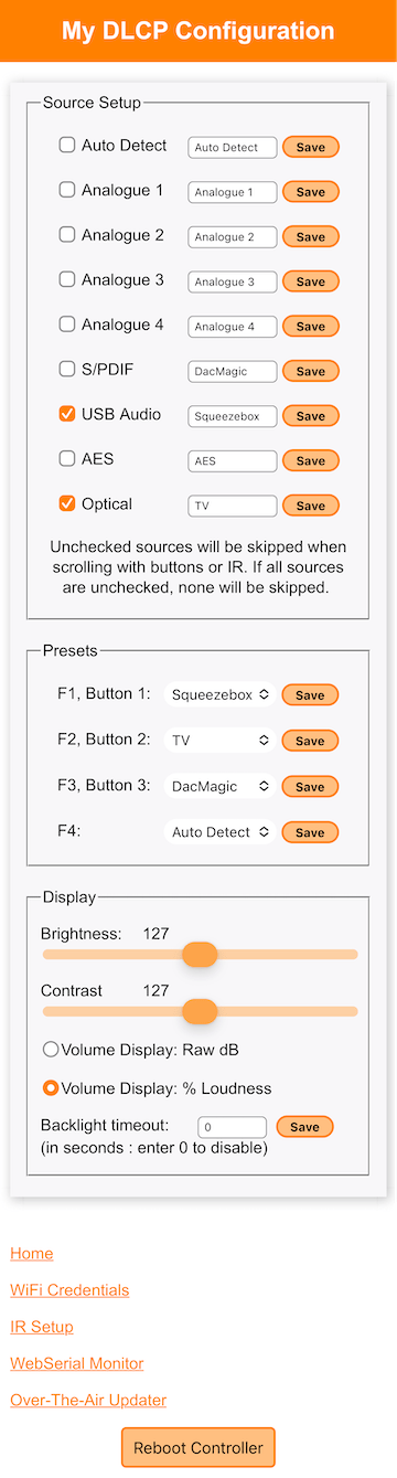

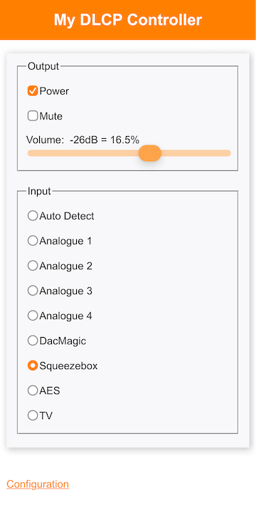

The software is 90% complete, and fully functional. The following screenshots show the software capabilities. The beauty of having my own software is that I can add extra features that weren't part of the original design goals - I've included a configuration page to rename the input channels for instance (so that the USB input becomes 'Squeezebox', and the optical input becomes 'TV'), and to configure the additional 'preset' buttons to select any of the given inputs. My PCB also includes circuitry to adjust the display brightness and contrast via PWM GPIOs, so this is configurable in the software. And I implemented an alternative volume display (a 'loudness' percentage scale, rather than dB), because the dB display is a little unintuitive for casual users. Finally there is a page to specify wifi credentials - if the ESP32 doesn't find a configured access point within 10 seconds of boot, it launches its own access point so that you can connect to it and tell it your wifi details.

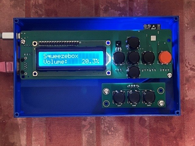

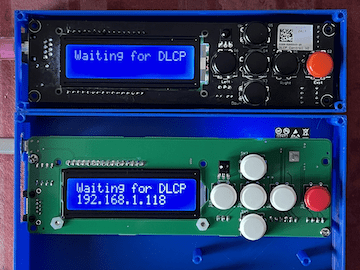

My V1 PCBs arrived today and I'm happy to say that they work as expected. Apart from the previously noted blunder with the display mounting area, which has required me to mount the display on the 'wrong' side of the PCB, everything else seems to be working properly.
I'm almost ready to order V2. It's virtually as pictured in the first post - i.e. with surface mount buttons to reduce the PCB size to match the original - with a few minor changes. I added a filter circuit for the IR receiver, as suggested in the data sheet. It had the effect of pulling the selected pin high at boot, and it just so happens that I'd selected a (the!) pin which causes a boot failure of the ESP32 if pulled high. So I moved it to a different pin, which meant a bit of shuffling of the other pins.
I'll give this one a couple of days in regular use to make sure there's nothing else I've overlooked, then I'll place the order.

I wasn't happy with the quality of the LCD display I used in my V1 PCB above, so I delayed ordering V2 while I spent a bit of time finding a better display. I think I've now found one that matches the original for quality and appearance. I had to use a file to open up the aperture in the PCB for this display, so I'll adjust the PCB shape before ordering V2.

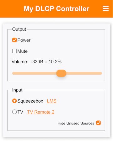

I've worked on the web interface a little bit too. I've increased the slider sizes so that they're easier to 'touch' on my phone, I've added a configurable backlight timeout, and I've tidied up the colour scheme so that everything matches - I've gone for a couple of shades of orange everywhere to suit the Hypex look. I've even added a 'dark mode' which comes in according to my phone's setting.
I've added a couple more features that I think improve usability. I can now 'uncheck' any sources that aren't connected to anything, so that they're skipped when scrolling through the sources with the buttons or the remote.

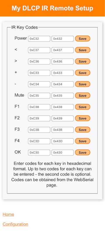

And I've added an option to change the IR codes so that a different remote can be used.

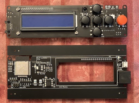

My V2 PCB arrived.
This version has the surface mount buttons on the front, which meant it became a double sided assembly at JLCPCB, so it came with added edge rails. They snapped off very easily though, and the only soldering I had to do myself was the IR receiver and the display screen.
Even though my V1 PCB had worked perfectly, it's always possible to introduce an error into a revision, so I tested what I could before potentially 'wasting' a display and an IR receiver. Once I'd determined that loading firmware, pressing buttons, and controlling the DLCP all worked, I soldered those bits on and I'm happy to say it all works perfectly.
Here's a comparison shot: Original Hypex controller in the middle, my first attempt above and my second attempt below. This second version is a really good match for the original. It's exactly the same size, with the same mounting holes, and the buttons, display and IR receiver all in exactly the same places. None of that was particularly important, since my front plate isn't machined yet, but I was quite keen on making this a drop-in replacement - just for the challenge! The only thing that prevents it being a drop-in replacement is the fact that it needs a separate 5V micro-usb power supply, but the current draw is within the capabilities of a USB port on the Raspberry Pi I have next to the controller inside my amplifier.
I'm much happier with the display in my second version too - much better quality than the one I used in my first version.
So unless I uncover some sort of fault while using this version in the next few days, I think this little project is finished 🙂

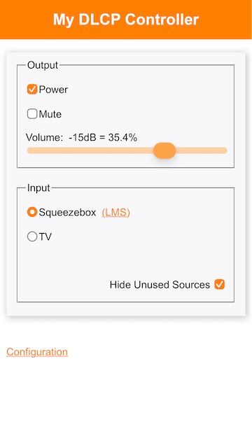

I added a couple of things to improve usability: I can now hide unused (unchecked) sources on the home screen, and I added a link to my Logitech Media Server next to the Squeezebox source. The link takes me to the Material Skin, which works beautifully on my phone - I already have a homescreen link to the same place, but this just saves me having to exit the browser and find that link. I haven't bothered to code this as a configurable link, since my LMS is at a fixed address.

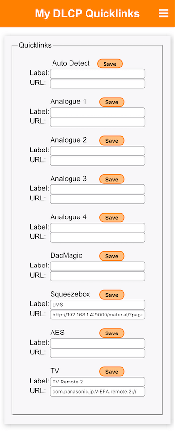

I decided to add a configuration page for the shortcut to LMS after all, so that I can change the link, and perhaps add other useful links, without having to recompile. I also discovered how to launch an IOS app using its URL scheme, so I found a use for a link next the 'TV' source as well.

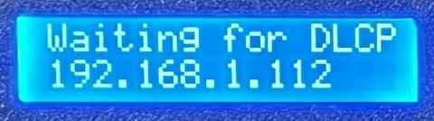

Wow a bit late to the party but an amazing project. The reason I am even in this thread is because im investigating an alternative or a replacement for my control board which is acting up.
It just to freezeS with "waiting for DLCP" In the display and then no response until I disconnect/connect the connector. Would there be a possibility to purchase a kit or complete product from you? Hypex is out of stock of control boards 😢
