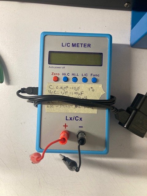

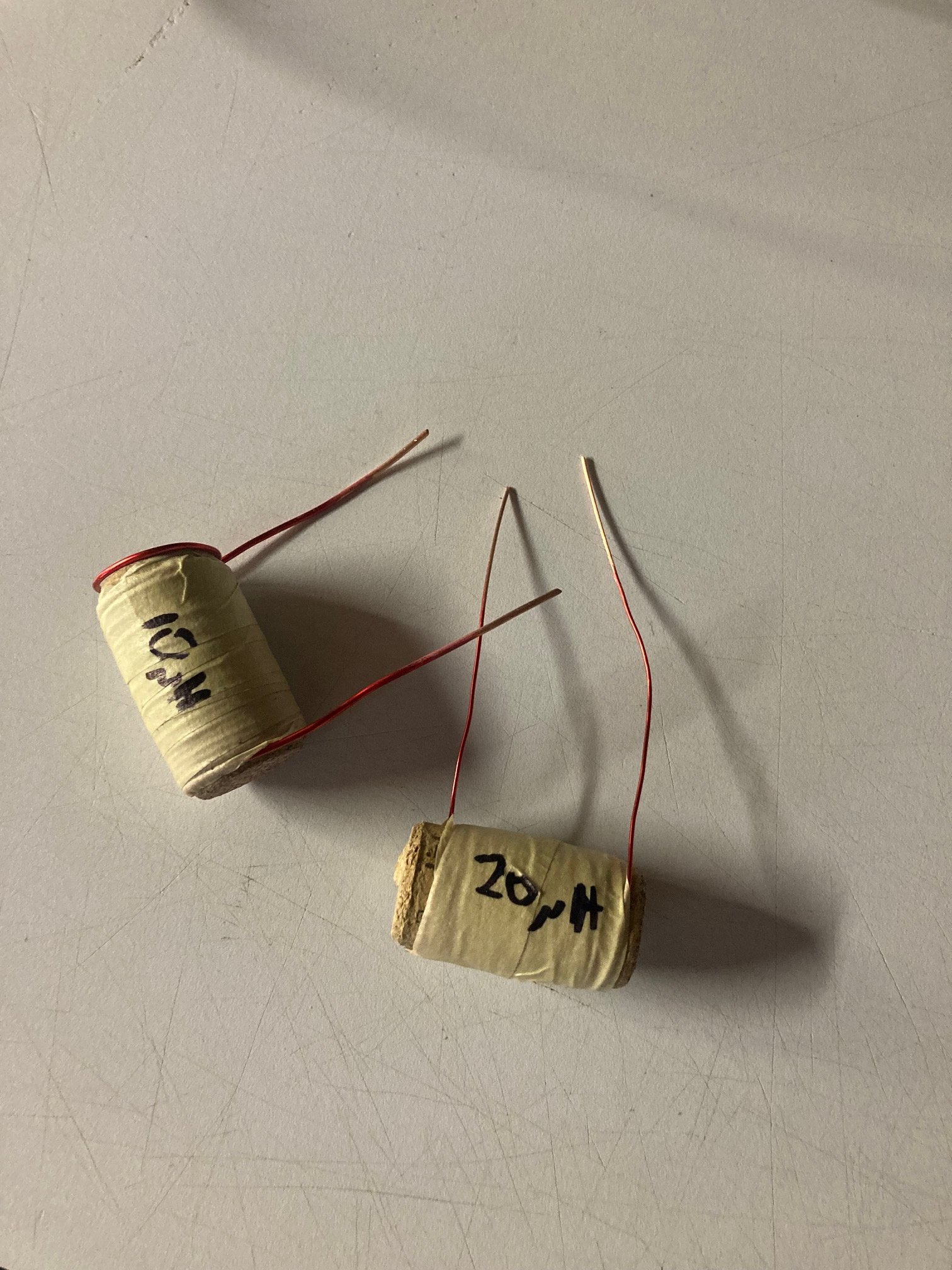

Here's a worked example. I needed a pair of 0.05mH coils for a crossover I was designing, so I used an online calculator to estimate that I needed 32 turns of 1mm wire over a 24mm diameter air core. I had scraps of 16 AWG and 20 AWG magnet wire laying around, and some corks, so I gave it a go. This is what I got, with inductances measured using a cheap LC meter, which I believe systematically underestimates the inductance, but idk by how much. I ended up buying a pair of 0.05mH coils from Madisound for $2.30 apiece plus shipping.
If you mean some Chinese clone of the AVR transistortester then I have the same and using Solen air core inductors as guide it seems pretty consistently underestimating inductance by roughly one E24 step which is around 6%. Thanks for confirming that it is not just me, if that's also what you are using to measure the inductance. Inductors I ordered straight from China rated +/-5% would measure around 6-11% less. Solen did not seem to specify the tolerance. I don't know if I should blame it on the cheap meter or on copper being expensive.
