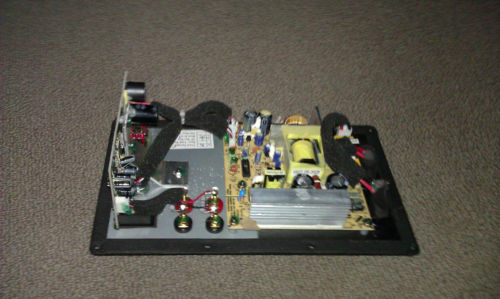

Here is a picture of the amp and power supply.

I measured the voltages. The main output is 48VDC with a +-9V secondary supply. The current is im guessing around 4-8A(150-350W). Expected speaker Z 4-8ohms. I am not sure what mode the SMPS runs in there is no feedback that I can easily see. The output is 5 wires. +42V GND -9V GND +9V. It may have some sort of current sensing, I'd have to look up the data sheets on the controller IC's.

The 2 Sub-12 plate amps I have are in pretty bad shape and not fixable the way they are. I am in the process of making a schematic and PCB. They run in class G with a linear full bridge amp.
48V marked and 42.5V measured loaded and unloaded. The SMPS boards are rather nice compact and covered in component glue. I would prefer to not modify them at the expense of having a more complicated chip amp. More challenge=more fun.
The SW-350 amps with these smps's are full digital chip amps. They use an a/d converter digital filtering and amplification. Down the road that might be a fun project to venture into but as my first real amp build I will stick with analog for now.

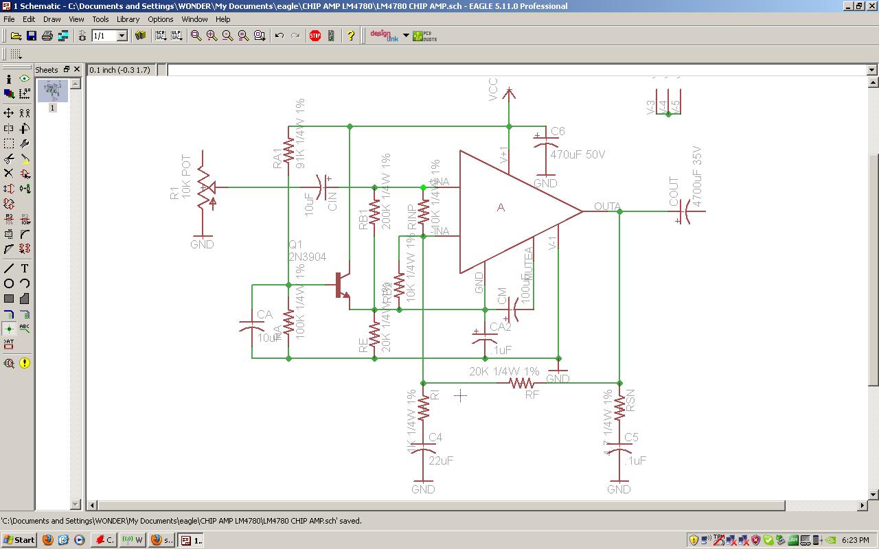

The chip I have selected to use is the LM 4780 basically the 2 channel version of the LM 3886.....Let the fun begin!
WOW!! You weren't joking about single supply being a pain. Bridged is out of the question for right now. I made my first schematic of this setup following the data sheet. Have a look and let me know if any of my values are no good. The data sheets states to use poly film caps in the signal path for better response.
Since you adapted all values from the datasheet, you can assume that it will work OK like that.
And yes, you should use film caps in the signal path, where possible and affordable. For Cout that is clearly out of the question, although a small film cap in parallel to it will be an improvement. That leaves Cin and C4. Cin's 10 µF make it already quite expensive, and C4 is usually an electrolytic due to its size anyhow. In both cases you could achieve the values by paralleling cheap big electrolytics with small and affordable film caps.
Why such a large cap on the output. Does running a single supply add that much DC into the signal? I should have v1 of the pcb finished later tonight.

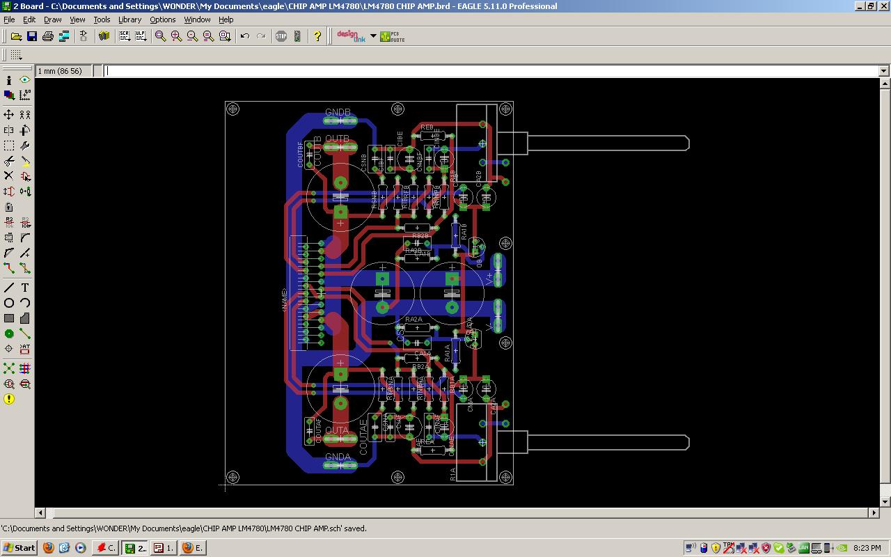

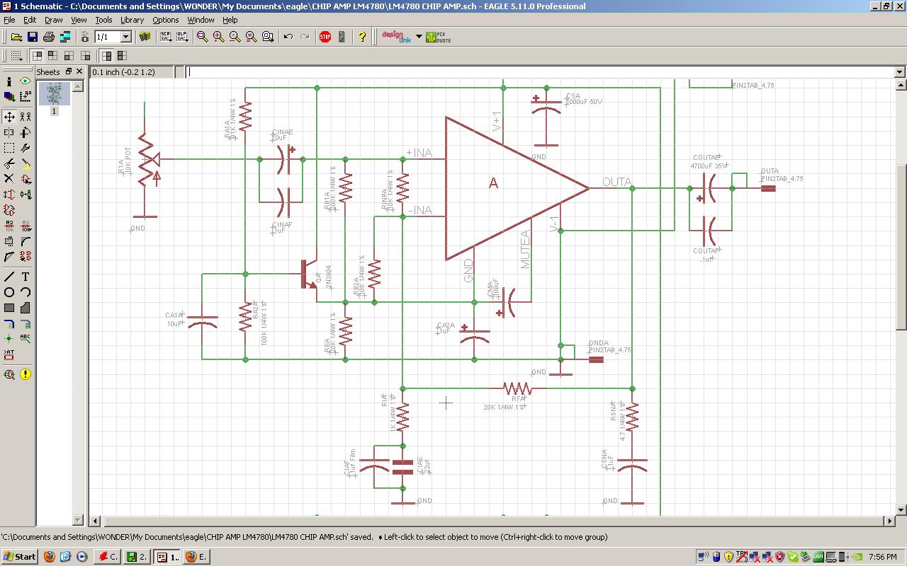

I updated the schematic and cleaned up the names and some other small stuff. I also completed v1 of the pcb. I added a .1uf film cap in parallel to Cin Cout and Ci. Higher values are much larger in size. If this is not sufficient changes can be made. For the electrolytics, mainly Cin and Cout are these meant to be polarized as seen in the data sheet or bi-polar?
I am sure the component placement could be stuffed in a little tighter but as it is this is a relatively compact design and I really like the symmetry of the board.
Once the design is ready I will edit the silkscreen on the pcb and make it pretty.
In a single supply amp the output is at half the rail voltage, e.g. for 42 V rails at 21 V. The size of the cap is due to its filter function. It forms a high-pass filter with the load, according to f = 1 / (2*PI*C*R), where R is the speaker impedance. A smaller capacitor could audibly cut the bass, depending on the speaker.Why such a large cap on the output. Does running a single supply add that much DC into the signal?
It is advisable to route power supply and output traces as far away as possible from the input to avoid crosstalk and (worst case) oscillation. Where you cannot avoid that they cross, they should do so at right angles. Take a look at the reference design in the datasheet to see how it is done.I also completed v1 of the pcb.
Watch that the big electrolytics are placed in a way that still allows you to reach the LM4780 with a screwdriver. Otherwise it will be difficult to fix it to the heatsink.
It is OK to connect the two mute pins in parallel and only use one capacitor and resistor for both channels. By the way the mute resistor seems to be missing in your design.
You should also add a 100nF ceramic cap next to the power supply pin and another 10 µF electrolytic no too far away from that. See chapter Supply Bypassing for that.

Polarized.For the electrolytics, mainly Cin and Cout are these meant to be polarized as seen in the data sheet or bi-polar?
I updated the schematic and pcb adding in the capacitors for te Supply Bypassing. I dont plant to use any mute switch so the resistor and switch was left out of the design. I am going to build this board as a prototype and testing platform while I rework the PCB. Are there any final changes that I should make?
You need the resistor, because current must flow to unmute the amp. Without the resistor the amp remains silent.
