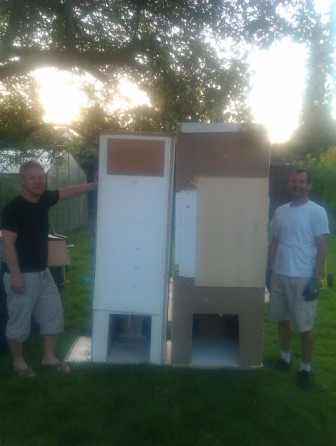

I had some big tapped horns on hand and I wanted some horns to play along.
Little sub has 2x 15" subs and Big sub has 4x 15" sub. They were made for garden parties, and have been parked in the garage for the winter. So why not make more horns for a complete system.
Here is the total system...

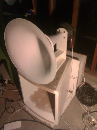

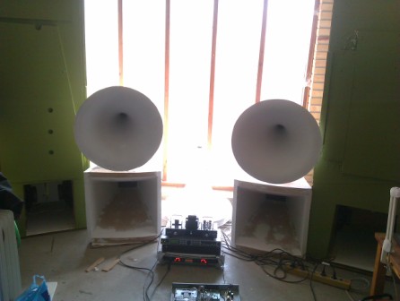

A 25w tubeamp is on the paperhorn.
And old british ITL (B&W) amp is playing the midbass and an Inuke 1000 on the subs. DCX 2494 for x-over and EQ to taste.
Total system price down to the last bolt, inc. amps and DCX2496, is 1500$😀
This bugedwise small system is kicking butt. The most realistic and "they are here" (the musician) I have heard so far. No box speaker can macth the dynamics, transient response and realism, IMHO. It´s like hearing with a microscope and I constanly find new details in recordings I thought I new.

My limited experience with paper was very good. It seems to be a wonderful material for horns.

Thanx Pano, yes the paper horn works very well indeed, the right amount of give and without the beaming effect. Relaxed and natural sounding.Very nice!

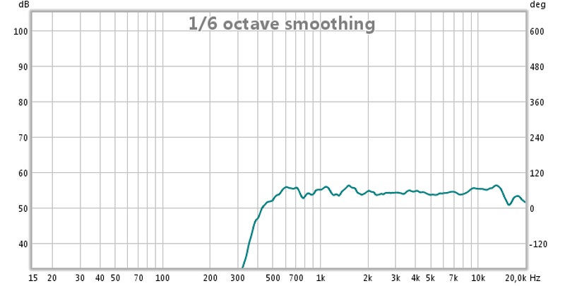

Hi JoshK, the box volume is 10 liters. Throat area ca. 300 cm2, mouth ca. 2500cm2, lenght from throat to mouth 62cm. 15" unit from PAudio. I used hornresp.schlager, I am interested in more details of your midbass horn if you are willing to share.
