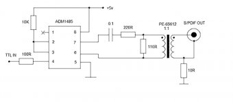

2. How to get the SPDIF output of the CD-ROM to talk to an external DAC. I read that the 3 pin SDIF connector on the back of the CDRM unit puts out SPDIF at TTL level - 5v, whereas normal SPDIF works at 0.5v, so some circuitry is required to transform the 5v SPDIF? Then what else is needed to implement either a coaxial or TOSlink output to interface to a DAC?
