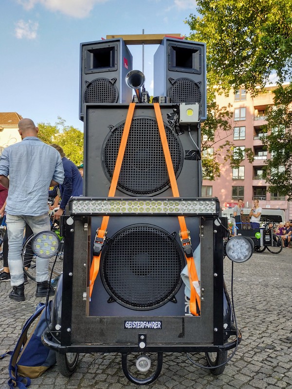

I'd go for 1-2x 15LB075-UW4, available at Thomann:
the box 15LB075-UW4 Speaker 15" – Musikhaus Thomann
I use this in my bike PA in 90L at 17kg per speaker.
attachment.php
Not a beauty, but a workhorse.
