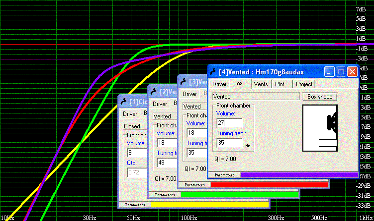

i have 1 pair of audax HM170G8 and 1 pair of audax TW034XO tweeter.i interest for building 2 way loudspeaker,anyone have suggest about box size and crossover schematic for this configuration?

I only know the HM170G8, and this woofer works perfectly in an 18 - 22 liter cabinet. With a F3 of about 50 hz. A simple first or second order x-over suffices.

I used 10ohm + 10 uF zobel on the woofer. And a 18 liter enclouser tuned to 50hz.

how about inductor value for this HM170G8?assume use 18 litre box in 50hz.
