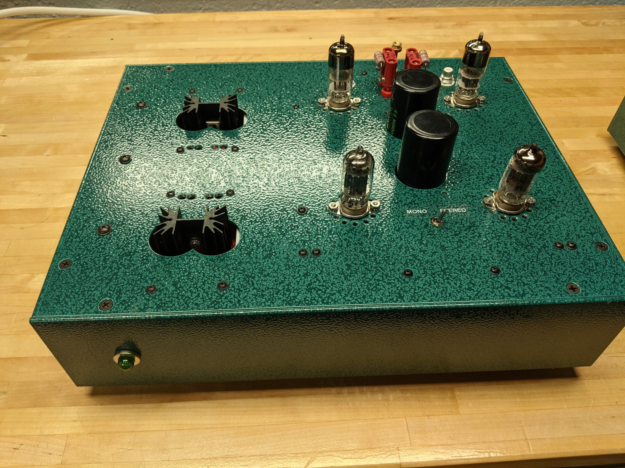

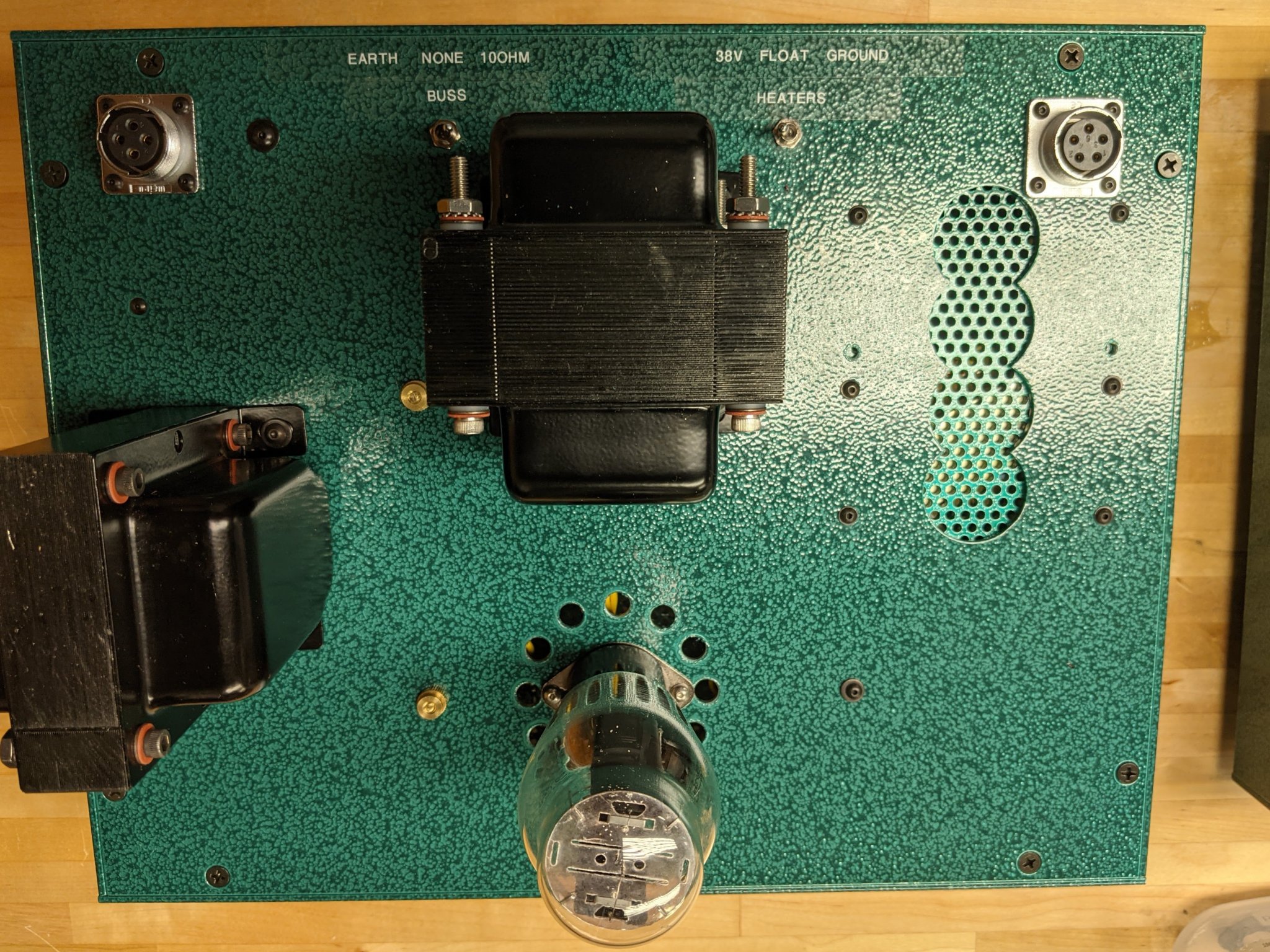

Having built a few valve amps over the years one of the most difficult parts of amp build is labeling. In the past I've used Letraset which is a rub on transfer but they are now no longer made, the only option being to buy part used sheets on Ebay. Aside from the fact that some of these sheets are decades old and past their best it's a fiddly job and tricky to get a good result. I've looked at professional panel services but price is an issue. Anyhoo, in my eternal search for a solution I found these the other day, see - https://www.radiodaze.com/generic-amplifier-decal-set-dcl-amp3/ they look to be a nifty solution.
Has anyone used these and what do think of them, second, is anyone in the UK interested in chipping in on a group buy to reduce shipping costs? Shipping is $18.46, the labels $12 something, I don't think there's any customs charges as a potential order is under £135.

Not to derail your post but I use a P-Touch machine with clear labels. Can grt white or black lettering. Looks much better in person as the camera seems to highlight the clear tape a bit.

There are a few "grades" of tape available in clear I believe. I've been using the laminated tape for over ten years without it peeling, curling or yellowing. I just use it in areas that don't get particularly hot. On the chassis near a tube seems fine but I wouldn't label a tube with it.

Yes, labelling machines like Dymo, Brother, etc have two separate ribbons for the base and the characters: you can opt for a transparent base, and any color for the characters: Black, white, red, etc.Not to derail your post but I use a P-Touch machine with clear labels. Can grt white or black lettering. Looks much better in person as the camera seems to highlight the clear tape a bit.

A good HP laser printer with clear adhesive vinyl paper gives you the most flexibility for typography and graphics, even things like potentiometer tics is easy. just print up sections or the whole face plate, border them so you have cut lines for xacto knife and straight edge to cut. Clean the surface with alcohol, stick on the sections, and even clear coat the whole thing is an option. Ink jet just doesn't have the quality of a laser printer, but will work too.
