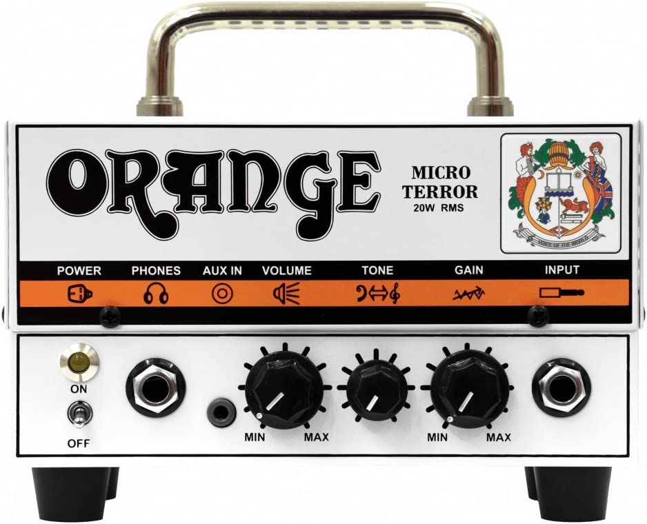

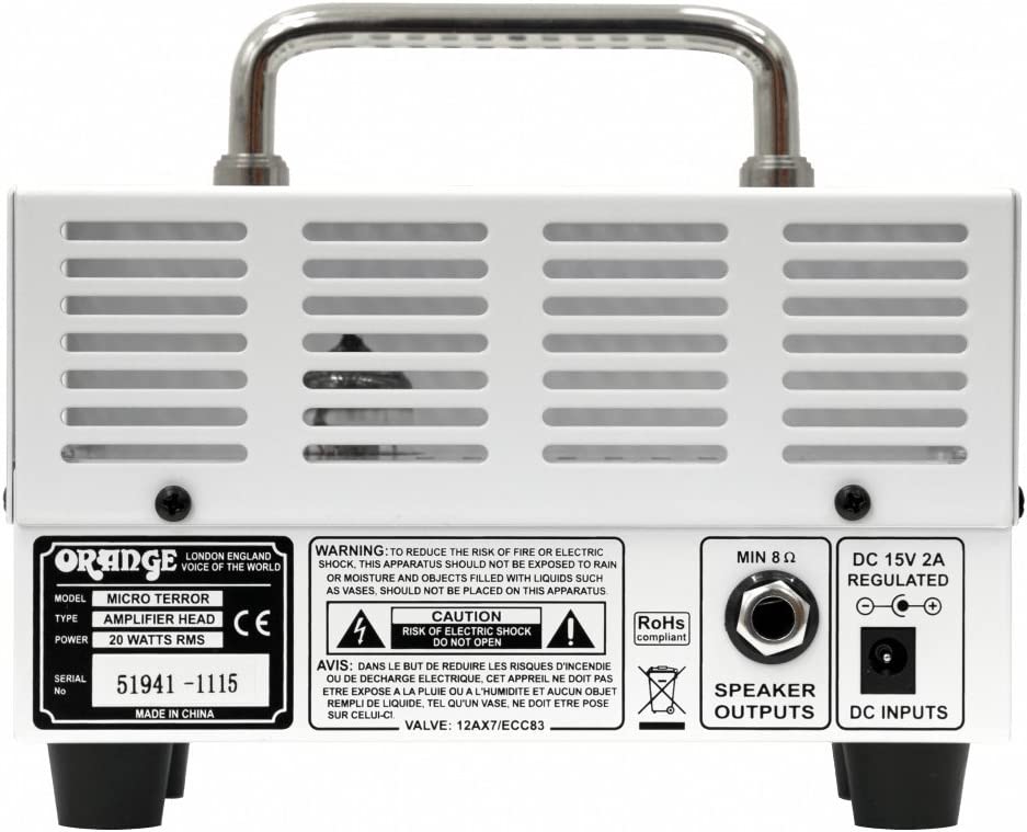

Tons of small Guitar amps are powered by laptop bricks and put out some 20W RMS.
Orange Micro Terror:
Notice the power connector:

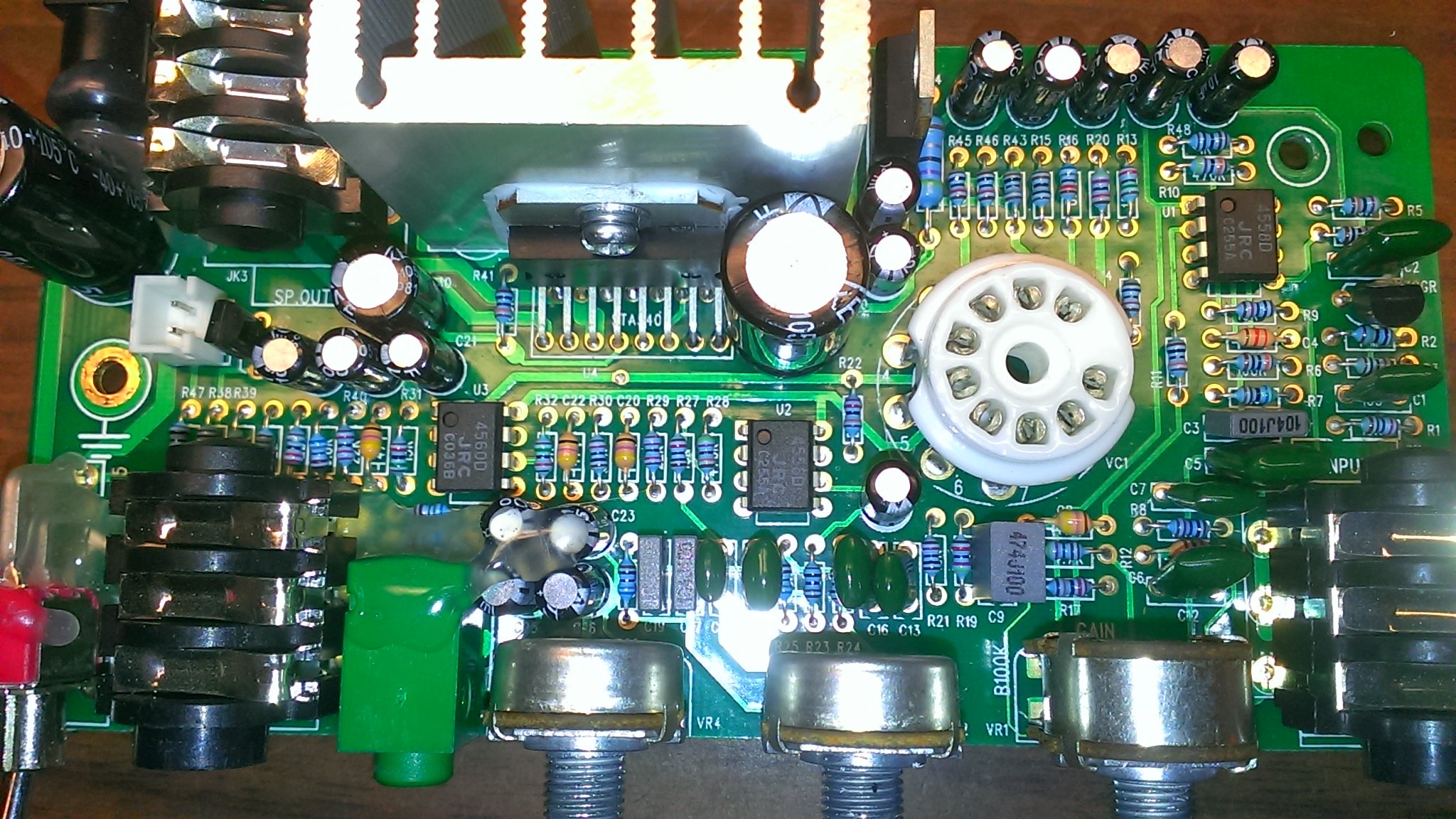

The power amp is half an STA540. You can use boh halves for a 20+20W Stereo.
