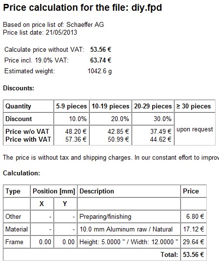

Also, does anyone know the approximate cost for a front panel from frontpanelexpress? Say 12"x5"x10mm thick. Or if anyone has a link to where the pricing is calculated that would be great.
Thanks.

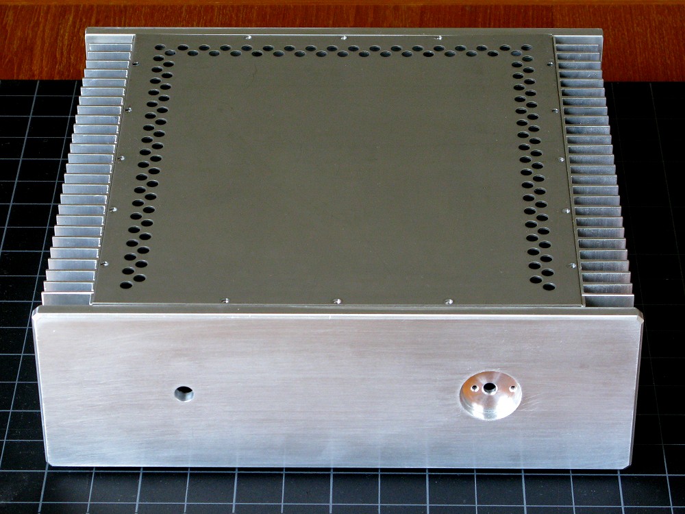

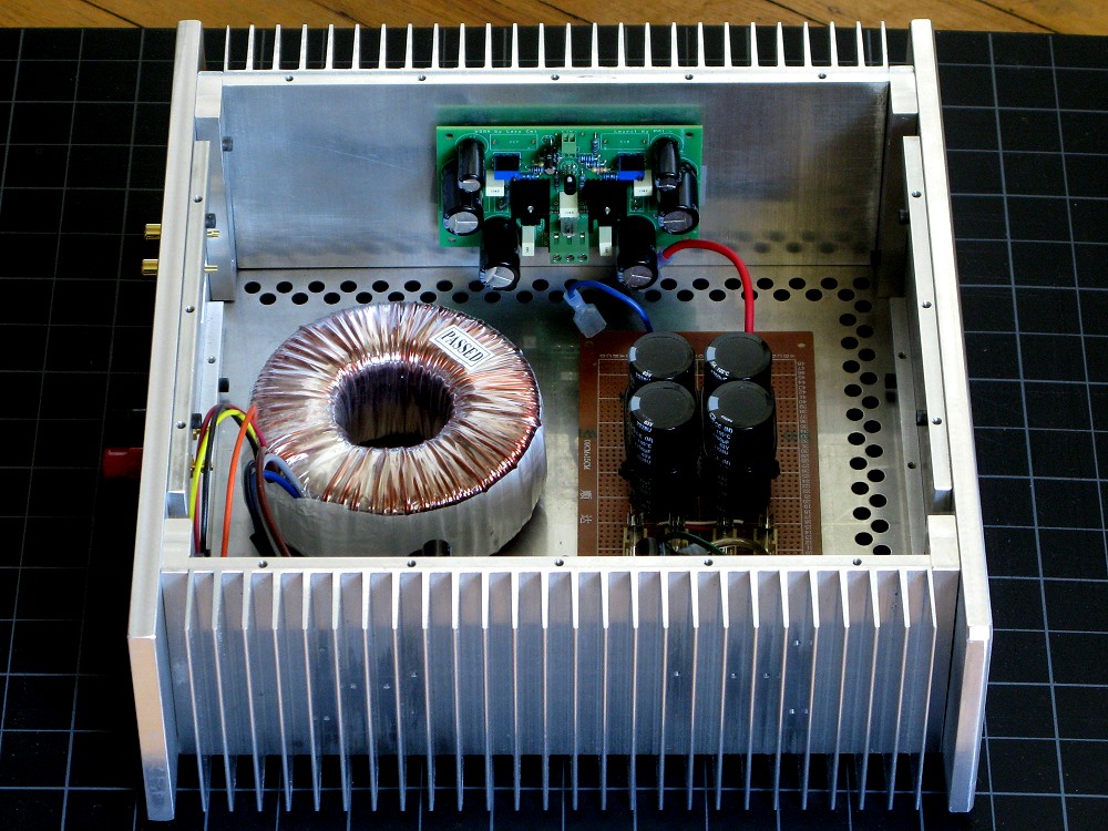

Here is an example, still a work in progress, but starting to come together.
Front panel is 12" x 4", and you could easily make it higher if you like that general approach. Just large enough for a 4.5~5" diameter transformer, and power supply board that fits into a 5x9" space, allowing some room for wiring. The chassis is built around the heatsinks.
I can post more info, and you can also see my post here:
http://www.diyaudio.com/forums/solid-state/231662-peeceebee-53.html#post3512021
All of the pieces are flat, no bending. any piece can be removed individually.

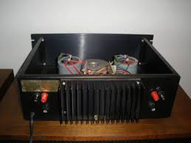

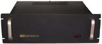

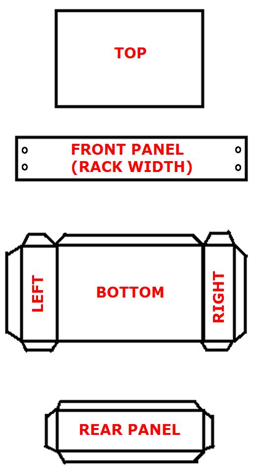

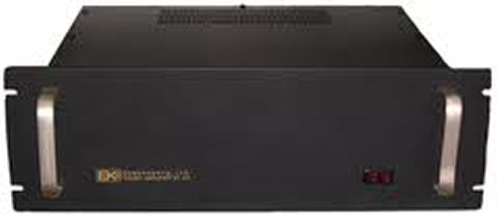

I opened up a storebought B&K ST-140 power amplifier last weekend, to see how the chassis was made. It is a very simple affair: 2 pieces of bent sheetmetal (the bottom+sides, and the rear panel), 1 piece of unbent sheetmetal (the top), and 1 piece of thick, unbent, brushed aluminum: the front panel.
Here's a diagram of the chassis parts, plus a couple of low-res photos I grabbed from Google Images.
