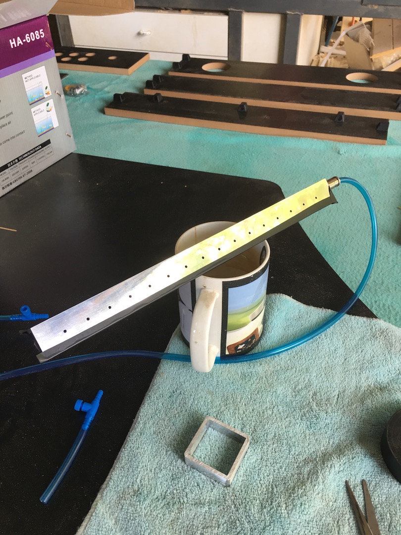

I am in the early throes of building an air bearing tonearm similar to the terminator design.
So far I have made a prototype using aluminium angle and flat bar. I have tested using a hi flow aquarium air pump.
The terminator design only uses a 285 L/hr pump to achieve lift. Mine is using a lot more than that and is only just doing the job! Admittedly I have only taped the parts together so far and would bond all parts together th make an air tight seal.
I have fed air in from one end as per photo and I get a constant hiss of air coming out of the holes. I thought I might be able to reduce this by countersinking the holes from inside but this has not helped much.
I have also made a triangular section that fits inside the aluminium with two grooves machined down the length adjacent to the holes. Basically i have reduced the volume of air inside the chamber to be more directed to the holes. Not a great deal of change there!
I see on a lot of the threads that pressure of between 50 and 70 odd psi is used in other setups.
I would appreciate any advice/feedback with this as I am keen to get the carriage floating properly.[/ATTACH][/ATTACH]

Much smaller holes! 0.7mm and closer spacing. If you cant drill so small holes then use tape on the back side and perforate the tape with a small needle.

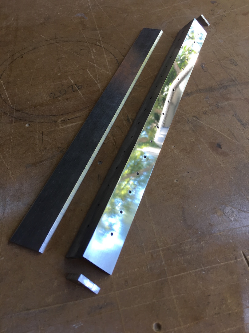

I have now made another one with 0.3mm holes at the same spacing and it seems to work ok. I have to make the cartridge arm, counter weight etc now to give it a proper test. I also used 32 x 32mm instead of the 25 x 25mm.
Just as a point of reference I use a Terminator Tonearm and the Rena 400 pump is way more than one needs in practice. I have a needle valve control on the feed line and it floats fine at as low as 0.6-1.0 PSI. I have mine set at 0.8 PSI. I think you are on the right track with the needle holes.
What I have wondered is how you seal the ends and edges? Do you epoxy a strip of metal between the top and bottom and a cut off section of angle for the ends?
It seems that the air is trapped by the length and width of the floating aluminum angle piece. No seal is used.
The first one I made I made a box section glueing all the parts with a 2 part epoxy. I think there were two reasons why it was unsuccessful 1. the holes were way too big and the air chamber was too big also.
The second one I made is like the Terminator where I sandwiched to pieces of angle together and sealed the edges with epoxy. The holes are now 0.3mm and the air chamber has been drastically reduced.

I would use the grit that is used to polish telescope mirrors. 25 micron grit mixed with oil would work well.
There are also sellers on ebay who sell various grit size polishing paste.
Im not sure that I would anodize the angles though. You would be adding a coating to the interface of the two pieces of metal.
Oh, drill first before lapping. Drilling will deform the metal slightly and the lapping will solve that.
