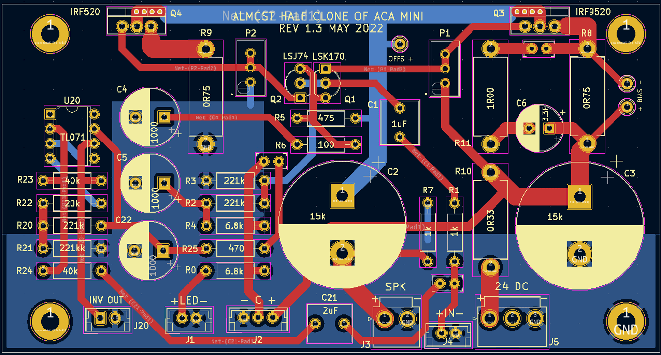

Does anyone out there want to cooperate on this, i.e. check the schematic and layout and provide suggestions or blessings? I'll probably get 10 boards made (again) so would share pairs at cost. BTW, these are mono boards with JST connectors (or soldered wires could be used) designed to go in a chassis and use conventional heat sinks. Is anyone interested in helping with an engineering review to be sure these turn out as they should? Let me know. I'd like to order the next round of boards soon. Thanks. BTW, I'd be happy to share the schematic and layout for review. Please PM me if interested.

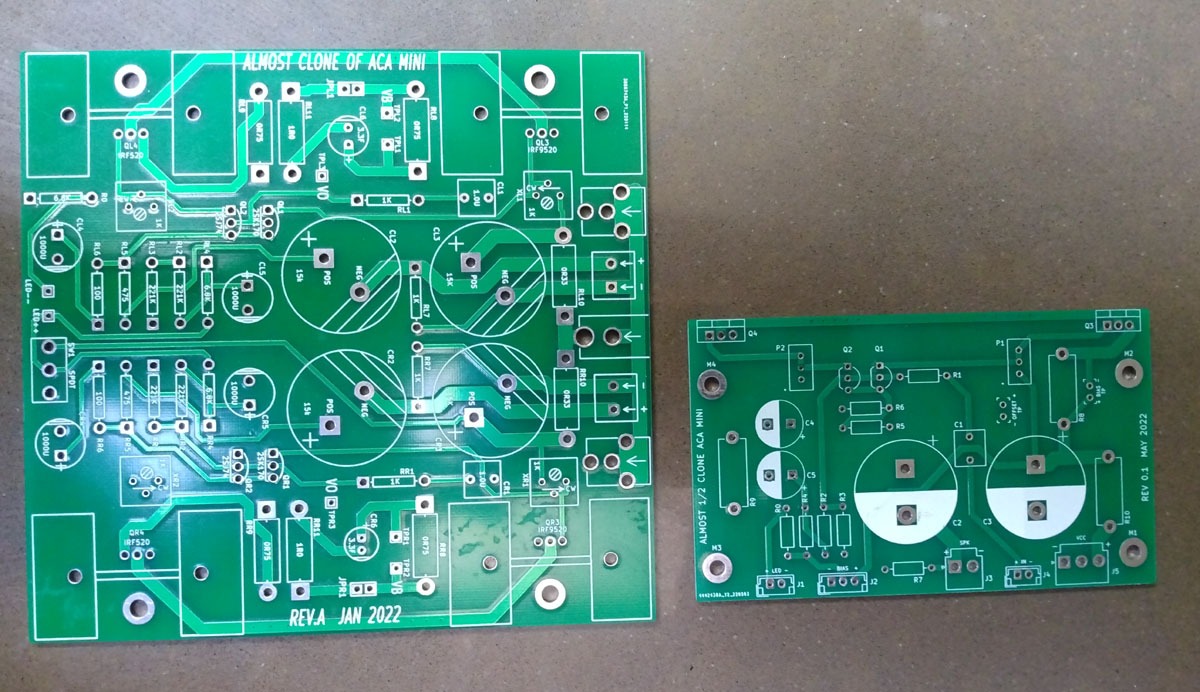

This is what the single channel Almost 1/2 Clone mono board looks like next to an Almost Clone Stereo board. Again, if anyone could help review the design before I go out for the next rev I'd appreciate it. Thanks!

A few suggestions;
1. I would move P1 and P2 closer to the output MOSFET.
2. Not sure you need the 2 mounting holes near the MOSFET. You could leave the mounting holes there and move your MOSFET closer to each other. If you can try to follow a UMS pattern.
3. I would add some extra pads and move 1-2 components near C1 so a better quality input cap could be used.
4. I normally add a nice polypropylene cap (about 2uF) across the big output cap.

By getting rid of the mounting holes I assume you mean use the MOSFETs bolted to the heatsinks as the mounts on that side of the board.?
Also, the new version is not a big board. Layout attached. 4500 mils (4.5") wide. I don't think I should move the MOSFETs any closer together so they are well placed to dissipate heat on a single heat sink about 150~200 mm long. If you think otherwise please let me know why that would be. I'm not well versed in these things. Thanks again.
Yep, that’s what I meant with the mounting holes. I haven’t verified the layout but adding the option to create a bridge mono configuration via the inverter is a great idea.
Nobody can verify your layout vs schematic, I believe you didn’t share your schematic yet.

Thanks for looking at this. BTW, I did change the trim pots to be much closer to the output MOSFETS.
And I'll have a look at UMS compliance next.

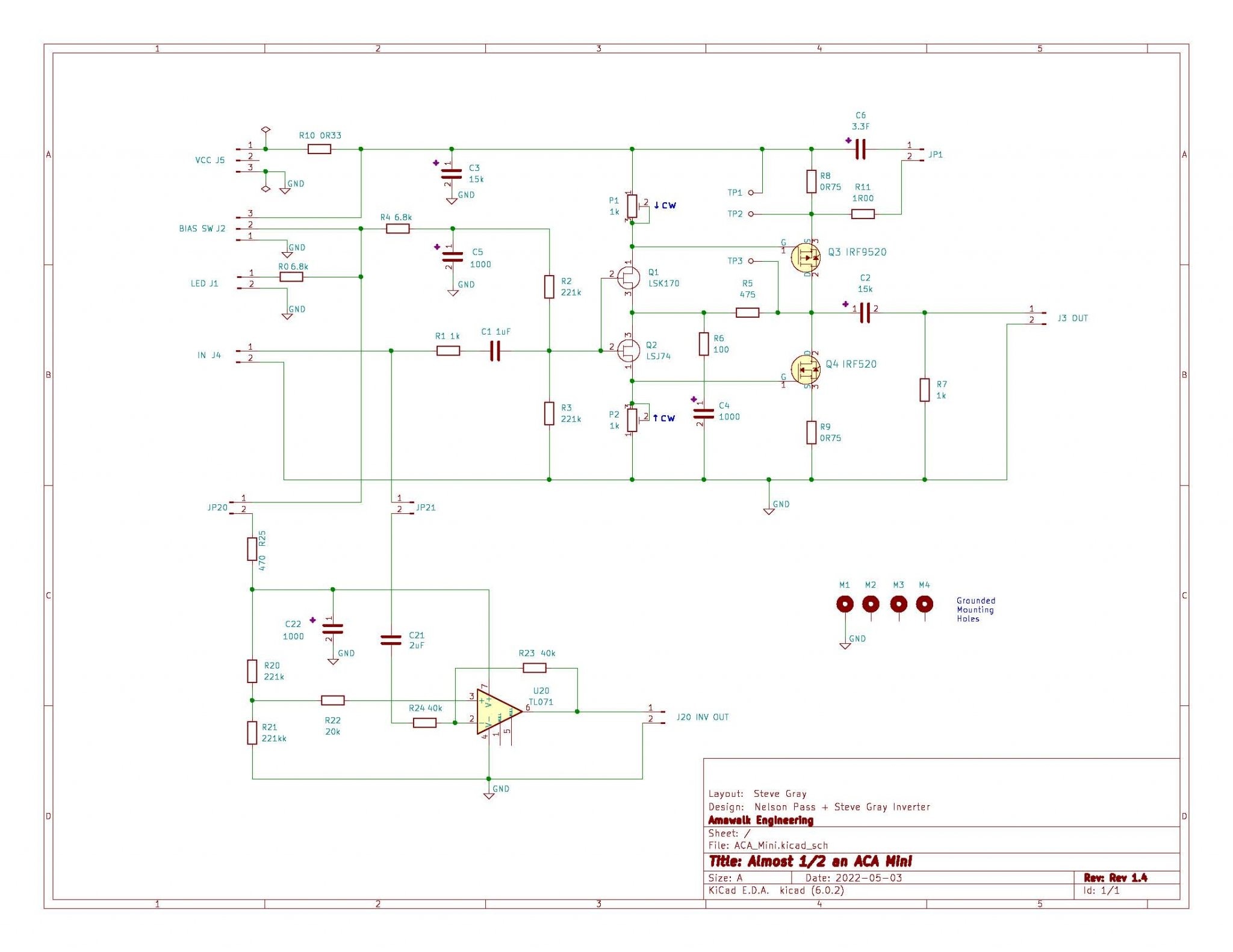

I entered the schematic in KiCAD. That program is marvelous!
Here is the schematic with a few notes and questions:
- The main channel is the same as Papa's. The super cap circuit may have the parts ordered differently .
- I would not populate and use that anyway, I prefer the "without jumper" sound
- The new stuff is the inverter where all such part numbers have a 2x number.
- If it won't be used anything with a 2x PN can be omitted.
- The inverter circuit has jumpers for power and signal so can be populated yet left fully 'off' if desired.
- The I/O and power connectors are JST plug ins, not the type used in the original.
- End use level connectors would be on the chassis, not the board.
- The inverter is a TL071, so should be unity gain stable and hence no compensation is used.
- Also no bypass cap is on the op amp PS as it it's for a low frequency (i.e. audio) signal and already has its own 1k filter cap nearby.
- I also added a resistor (470 ohm) to the filter and think I could have gone higher than 470 on that. Thoughts?
- And did I even need a separate filter or I could I have tapped into the bias supply? Thoughts?
- Considering the idle current of the TL071 plus signal load in actual use, I'm not sure this would draw more than 10 mA at most. Thoughts?
- After all, it's all low line level signal into a fairly hi Z load.

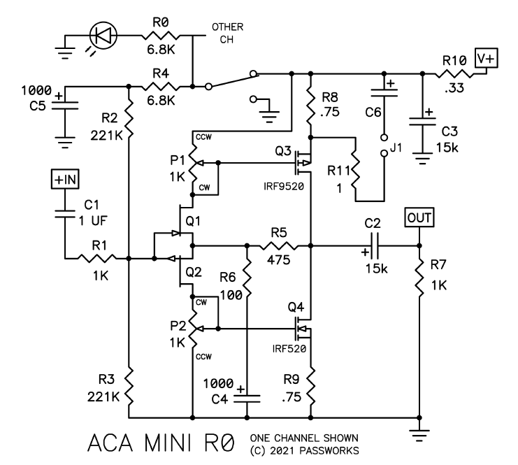

that's mini F5, not Mini ACA
catch is in my brain ........ difference between Mini ACA and ACA Mini
ZM Omniconfused

Sorry, I'm not sure what I did but it's definitely an ACA Mini (Mini ACA?) - with a twistthat's mini F5, not Mini ACA

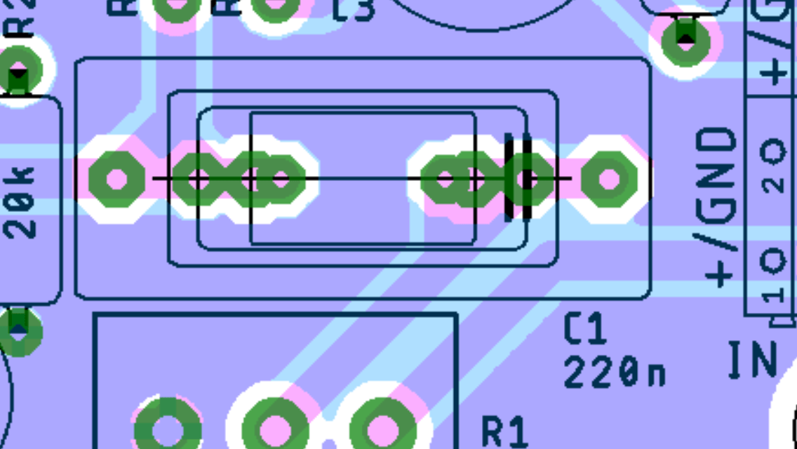

It’s unfortunate that C1 physical size is still very small, by moving OFFS+ on the left side and moving 2 small lines toward the top of the PCB would allow you to fit better quality cap.
For C1 you could do something similar to this pic which allows you a few different cap size.

Hi Eric,It’s unfortunate that C1 physical size is still very small, by moving OFFS+ on the left side and moving 2 small lines toward the top of the PCB would allow you to fit better quality cap.

When I mentioned that the cap C1 is small I mean the physical size not the 1uF value.
Buy a nice fancy cap rated 1uF, 400V and it won’t fit on your PCB. Not that it needs too, these are your pcb. Wish I had your knowledge to design pcb, whenever I need a small design I normally contact Prasi, he’s got very good design fees.

You had good suggestions! I have moved the trim pots closer to the MOSFETS and have also realigned them and the mounting holes to be UMS compliant although they may still need movement but not different spacing. And I have shortened the input path. All good stuff!! So many thanks!Hi

I'll see what will fit on board but I'm guessing a big cap may not cooperate with the needed board space. But I'll fid out when I start playing with it. Either way, I'm gonna generate all the files and have these boards built in the next day or two with whatever will fit.
The small radial Metallized Polyester caps aren't bad. There are a lot of nice caps under $10 each. Clarity caps being one.
