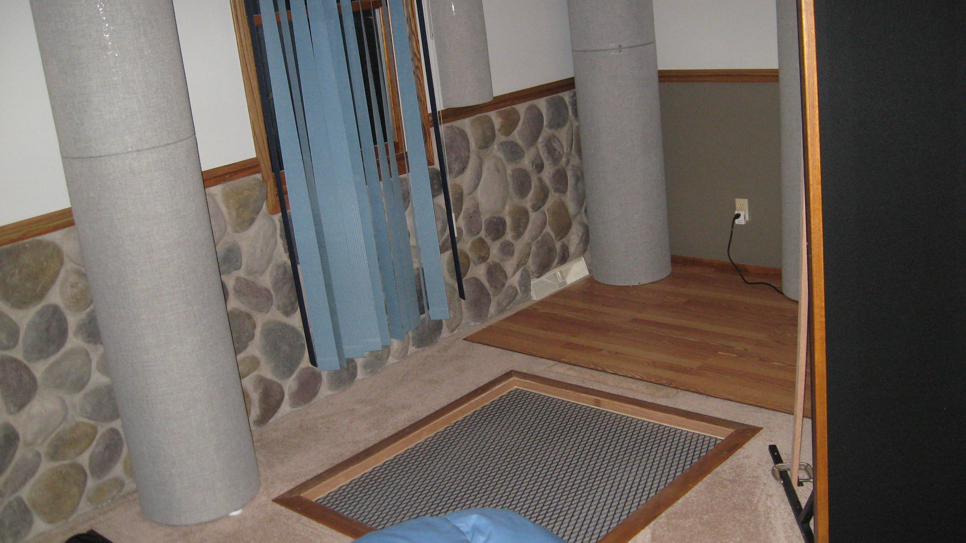

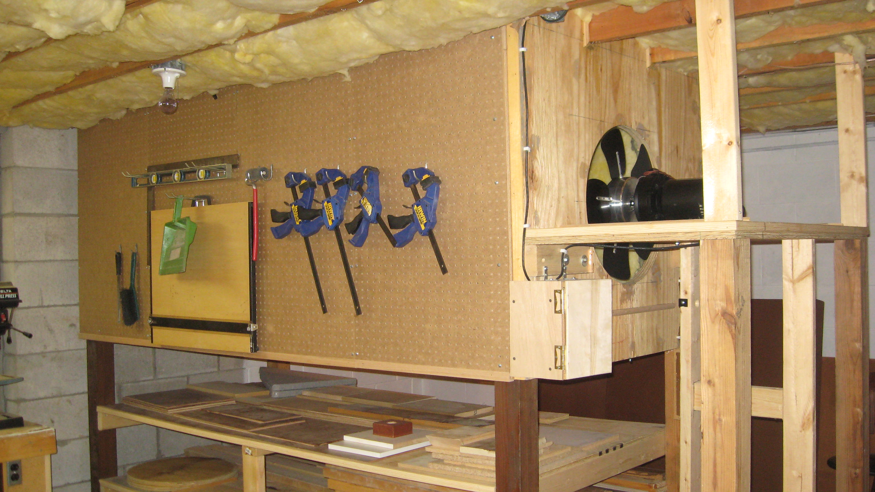

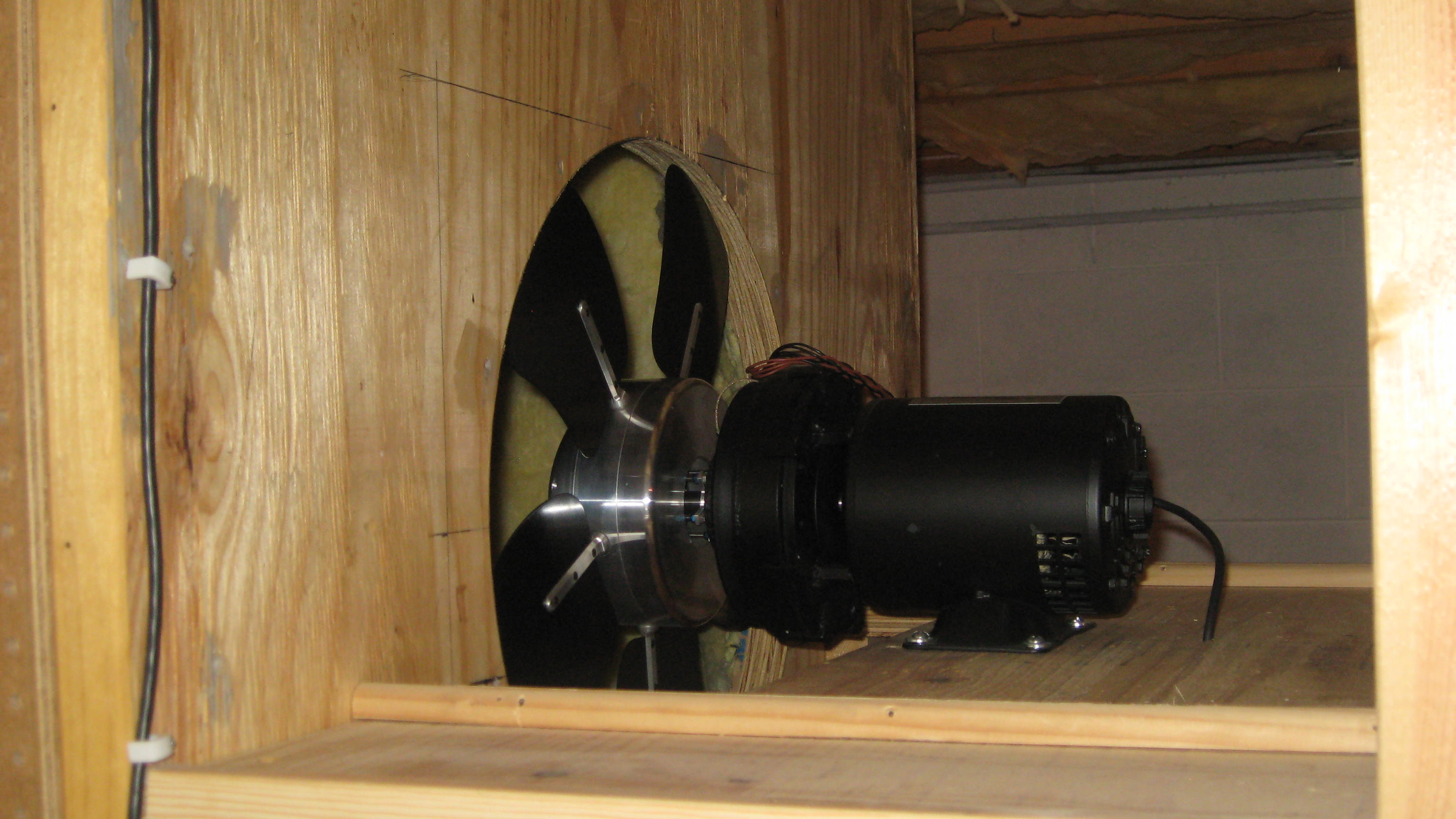

I have had the Eminent Technology TRW-17 Rotary subwoofer for over 2 years and it is awesome. Contrary to what you say, it has benefits for well recorded classical music and pipe organ, synthesizers.
Movies have a lot of content below 20 hz and with this rotary subwoofer it adds greatly to the excitement and realism. I can easily hear 10 hz and lower with this sub without shaking the house apart. Until one experiences this rotary subwoofer, making assumptions about it is wrong.

I use Eminent Technology's rotary woofer controller
that includes a variable low pass xover (15 hz to 25 hz) which I set at 25 hz. This controller has a 200 watt amplifier which pitches the blades, variable phase
control, damping and gain controls. The power comes from the ac current, rotating the fan. The only way that air would have a direction would be with a dc signal
which would never happen (- dc signal would suck air out of the room, a + dc signal would blow air into the room. A normal ac signal would be both positive and
negative, producing low frequency sound. When there is no LF content the blades of the fan are in a neutral position, producing no low frequency sound.
