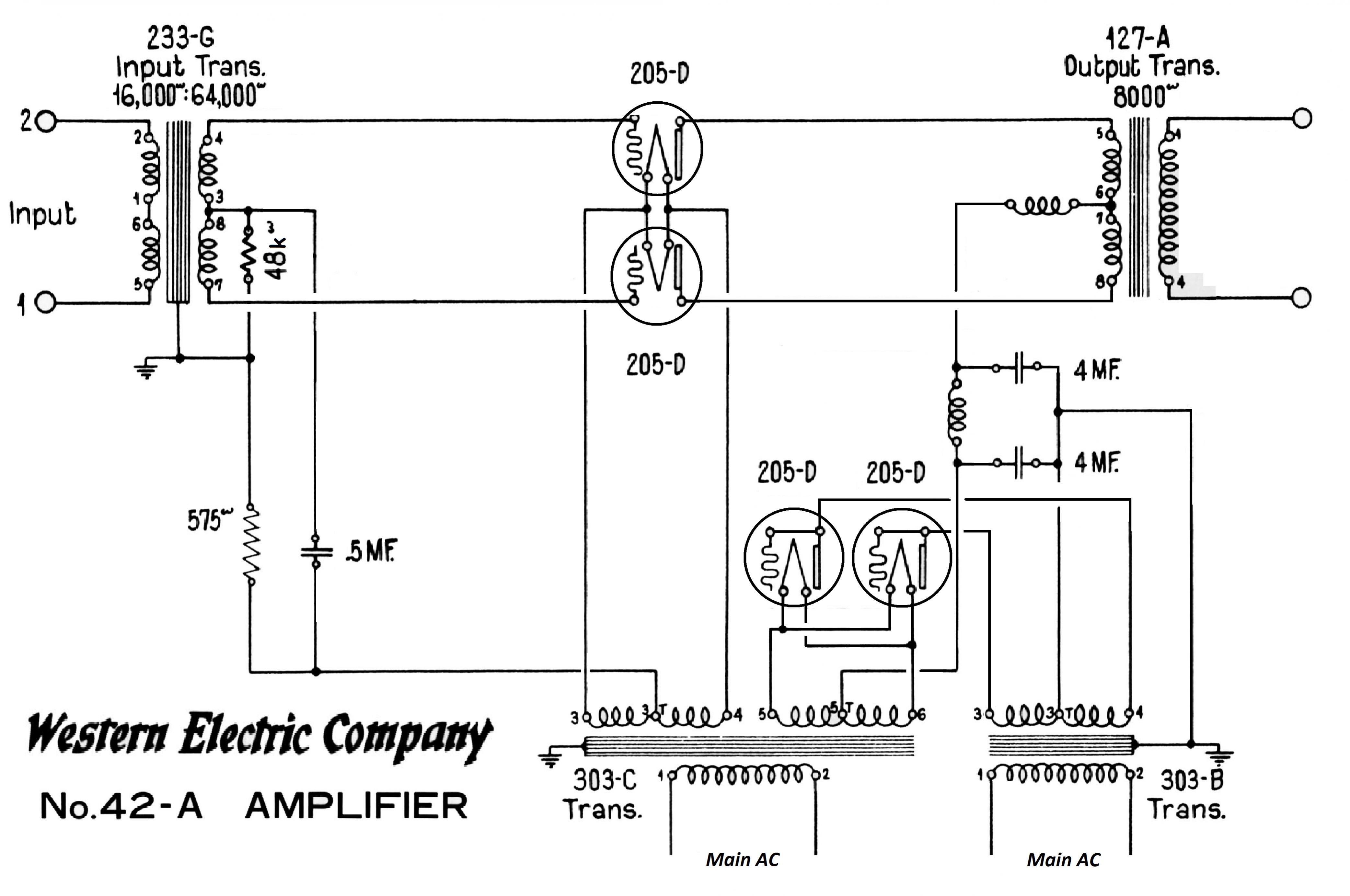

Since I bought Altec Voice of Theatre A5 speakers, I’m trying to materealize my idea and change my 300b amp to something even more low power.
Would love to try 205d. Any ideas what circuit and OPT I should try / use?
What about recreating Yamamoto 205d amplifier?

The WE datasheet for the 205D (the old one) has a table of operating points. How much power are you aiming for?
If a damping factor around 2 is acceptable, the datasheet gives some operating points that will get you over 1W. You'll need to find (or have made) some small 8K-10K series feed OTs.

Wow!
A 205D is a very expen$ive rectifier!
Other than for the look of a 205D used as a rectifier, I would $pend my money somewhere other than for 205D rectifier$.
And that choke from the B+ to the output transformer center tap . . .
Is it for filtering ripple?
Is it to act as a low pass filter to the music?

Its the second retard coil. WE did the same with their 43A amp.

A second retard coil deserves a 3rd filter capacitor, Right?
Cap missing from the schematic?
Or perhaps they used a Choke input filter, that would put the first cap last.
That would be easy on those expensive triodes.

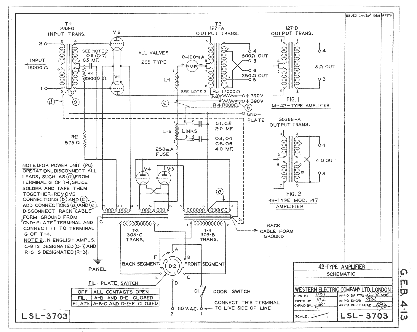

Second choke as CCS to output transformer
Others consider that the choke ahead of the output transformer (L2 in the 1936 schematic for the 42A attached) acts as a “constant current” induction to improve linearity and reduce distortion (see: 100 Amplifiers – Part 1 , 1916 – 45 | Lilienthal Engineering.)
OK.
But I believe that doing it that way will:
The constant current source that drives the output transformer's center tap, is going to restrict the output to Class A.
It will also limit the damping factor of the amplifier that does not use negative feedback around that output transformer.

...The constant current source that drives the output transformer's center tap, is going to restrict the output to Class A.
Good.
...It will also limit the damping factor of the amplifier that does not use negative feedback around that output transformer.
No.
It has only common-mode effect. Not longitudinal (differential) effect..
Also, "damping factor" would be moot in the period and market that amp was designed.
