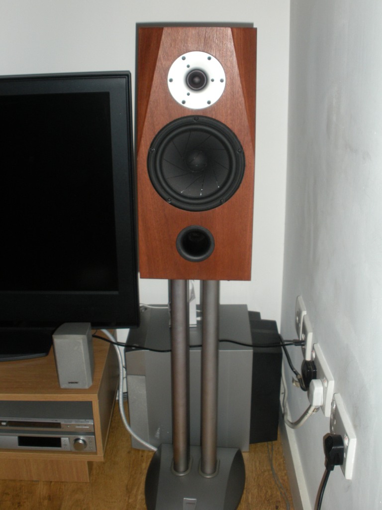

So, what do they look like? See attached. What do you think?
If anyone is interested in the design let me know

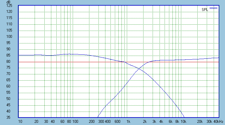

Chris, I hate to say this when you seem to enjoy your new speakers. I looked at the crossover design you posted in your original build thread:
http://www.diyaudio.com/forums/showthread.php?t=150648
It seems that this crossover basically relies on textbook formulas and maybe some hand/ear tuning after that. It has virtually no baffle step compensation built in there. If you really enjoy it, I have nothing to say further. But if you've looked for good hi-fi speakers whose tonal balance is neutral and precise, then this crossover is not for you. You chose some of the best, cutting-edge drive units on earth, and used them in a primitive way. Don't you feel their midrange too forward and bright? If not, I'm out 😀
-jAy

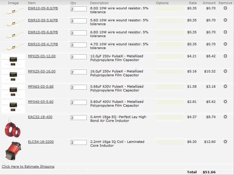

Chris,
I usually do my full modeling by incorporating baffle step loss/diffraction and box simulation results into drive units' published infinte baffle measurements. But since I don't have much time these days, this time I simply worked with crossover filters' transfer functions using drivers' impedance data. This approach works pretty well particularly for one, like me, who does crossover simulations frequently. First, take a look at your original crossover's transfer functions:
As you can see there's no baffle step compensation built into this crossover---no difference between 100 Hz and 1 kHz amplitude responses. This means that you hear less lower midrange and midbass than you need to. My predicted crossover frequency is around 3 kHz. The SS 7100 is a far better tweeter than many tweeters that could be crossed at 3 kHz.

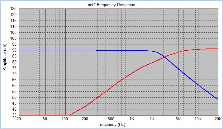

Now take a look at Zaph's ZRT 2-way design's filter transfer functions:
Though his design uses a different tweeter (SS 6600), you get the idea. He compensated full 6 dB for the baffle step loss on the 8531G's response.

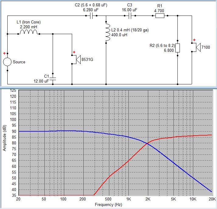

Finally, here is my suggested crossover and its filter transfer functions:
Mine has about 4-5 dB baffle step compensation, which will work in most listening rooms. The crossover point will be about 1.9 kHz. Note that the tweeter is wired in normal polarity (i.e., same polarity as the woofer is wired).
I provide a tweeter output adjustment option in case you need it. Replace the R2 resistor to increase or decrease the tweeter output. Default value is 6.8 ohm. A larger R2 value will increase the level and a smaller one will decrease it.
Here is my suggestion about crossover components. Rather than cannibalizing your current crossovers, I recommend purchasing inexpensive components to try the above crossover. Never use expensive components. 99.9 % of speaker system distortion is from drive units, not from crossover components. Simply use components of values and types specifed in my crossover schematic. Use iron core inductors for L1, and air core 18 or 20 gauge coils for L2. Use any inexpensive poly caps, and any resistors rated at 5 watts or greater. Is there any local or online store you can order these from?
If you like the new crossover, then you can cannibalize the previous ones and replace some parts with higher quality ones.
-jAy

Hi Jay
Thanks for taking the time to write that; I really appreciate it. I'll order the new components over the next few days and give it a try.
There are no local shops that sell this kind of thing so I tend to order from Parts Connexion or Hificollective.

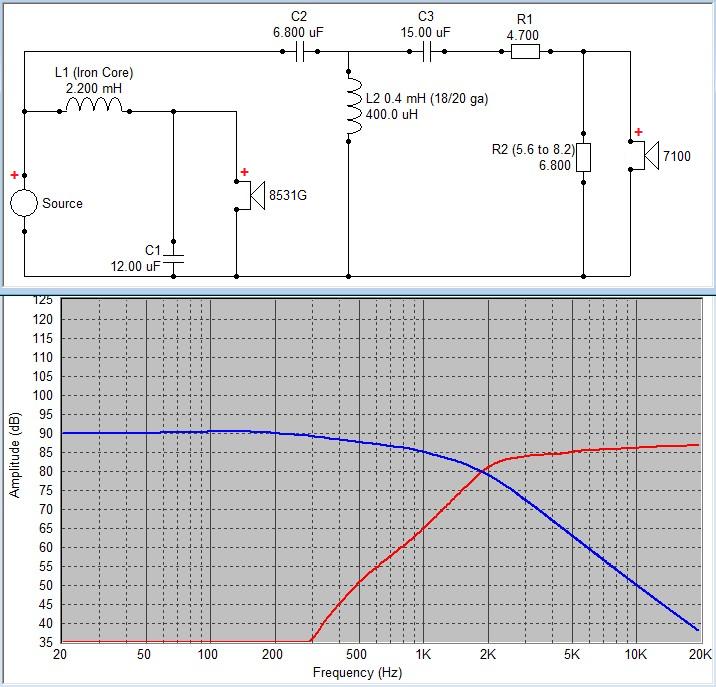

Chris,
If you haven't ordered the components yet, here's a little better modeling result I obtained. For C2, wire 5.6 uF and 0.68 uF caps in parallel.
If you have to order online, here's a great solution for you. Use the Erse Audio online store (www.erseaudio.com). They manufacture crossover components in house. Outstanding quality components at great prices. You don't need Mundorf or Duelund parts. You can use as good components at a fraction of costs. Erse also charges only actual shipping cost. So no problem ordering internationally. Email and ask them to send them, for example, via USPS Priority Mail. Shipping won't cost a lot. See attached below for BOM I made for you. Only $52 for xover components for a pair of speakers. Isn't it sweet?

Just one more thing before I forget. When I made the BOM at Erse, I actually wanted to include 16 gauge IXQ steel laminate core inductors for L1 (2.2 mH), but found that it is currently out of stock. So I included the 18 gauge IQ steel laminates instead. When you contact the Erse, ask them if they can unwind IXQ 16 gauge 2.5 mH coils to 2.2 mH for you. Otherwise, if you are willing to spend a little more (only $13 more for a pair), use the Super Q 16 gauge. It's the best iron core inductor you can possibly get.

You don't have to get the Super Q. The IXQ 16 gauge is more than sufficient. Ask them if they can unwind the 2.5 mH first.

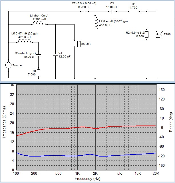

And you're building the tube amp, too! In case you're not aware, this kind of tub amp has a low damping factor, or high output impedance, equivalently. Output impedance is usually 2 ohms. In this case, you won't get my designed frequency response due to the effect of the speaker's impedance swing. To avoid this problem, you need an impedance compensation circuit. Adding this filter will enable you to use the speakers with any amplifiers regardless of their damping factors. Take a look at the attched schematic for an added circuit and its effect on system impedance. Note that this LCR filter is placed before both low-pass and high-pass filters (that is, between amp and crossovers). Just use components I suggested there. Using more expensive parts in this circuit makes absolutely no difference in performance. For C5, use electrolytic caps, and for L5, use 20 gauge air cores.
