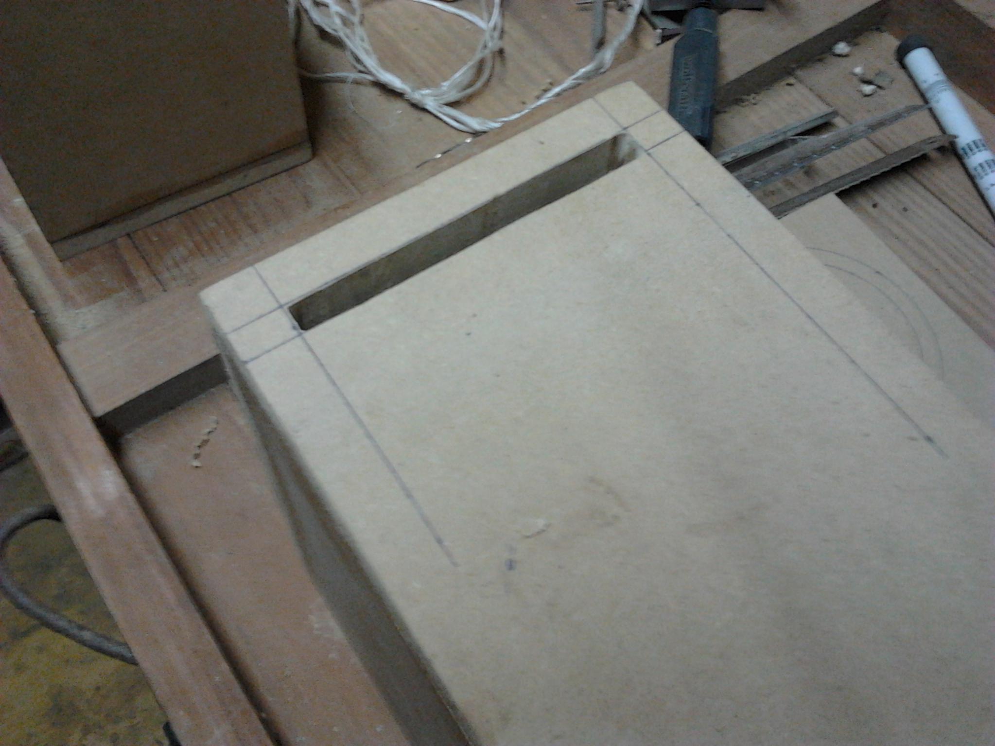

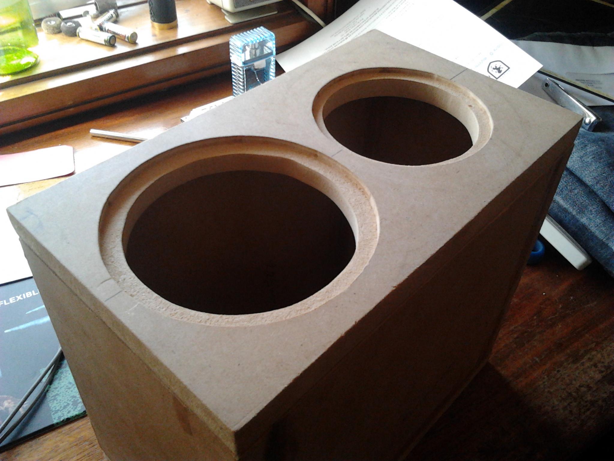

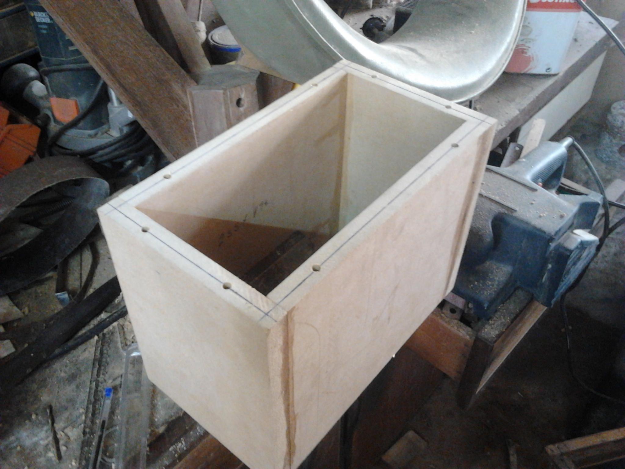

I will start here to present my current status of this DIY project: Eekel's Mini + 8" RSS210HF-4 Subwoofer.
The plan is to go all active. Thus, I will make my own version of thee Eekel's Mini with integrated Hypex AS2.100 amplifier (master + slave). I will have to change the port configuration from round to rectangular in order to accomodate the plate amplifier. Also I plan to put polycarbonate covers on the XOs so I can see them directly from the outside... niiiiice 🙂
The subwoofer I get a preliminary design of 17,6 liter closed box with a QTC of 0,634 and F3 of 48,77Hz... I would appreciate if you could comment on this also! All of you who are far more experienced than me for sure...
I will start next weekend and I will put the photos here so I can share my work.
Best Regards
André

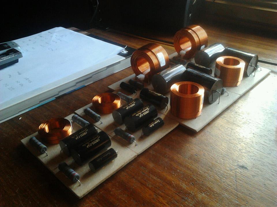

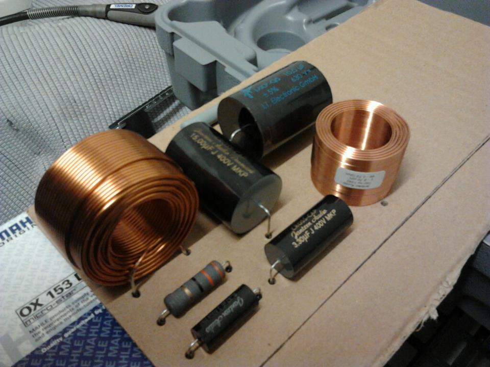

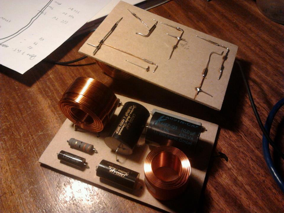

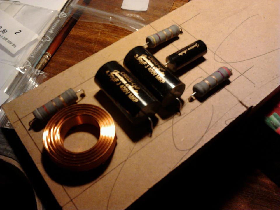

So I made a template for each crossover, treble and bass, in order to study best component placement and this is the final result! 😀
Hello Cal
I still have to make all the connections... Also I still don't have the drivers with me :S
But I am pretty curious on how will it sound... also with the Hypex AS2.100 plate amplifier.
