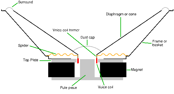

I would inspect the rear spider (corrugated suspension) to check it is securely glued to the speaker basket and speaker cone/voice coil former - see attached cutaway.
I presume you will already have checked that the speaker cone is securely fixed to the front roll surround.

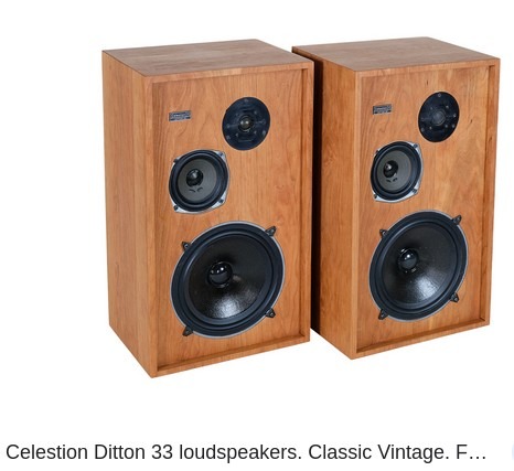

Could I make a suggestion here?
Simply run the broken Celestion 33 speaker upside down! Or sideways.
This will eliminate voice coil rubbing as the source of your problems... 10" paper bass, 5" paper midrange and 1" mylar tweeter. All closed box.
After that, I would suspect a broken solder connection in the crossover. A visual inspection always helps. Maybe the back panel is rattling due to dried up glue?
