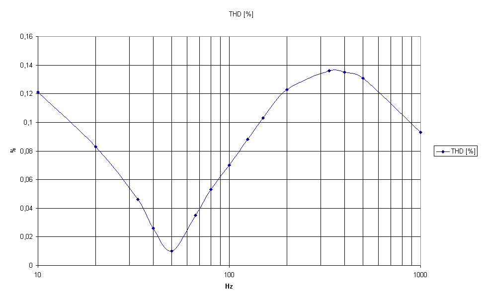

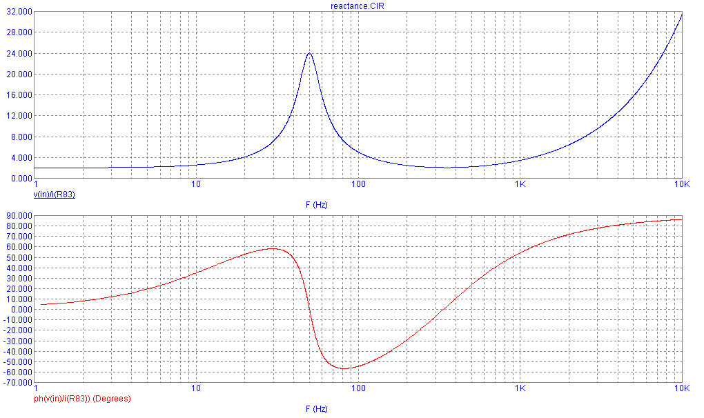

PMA's plots show some interesting facts.
The load hits 4ohm 50degree phase angle at ~19Hz and ~130Hz.
At both these frequencies the distortion is neither at minima nor maxima.
At 50Hz the load phase angle is zero degrees and the resistive impedance is 24r
The distortion is at minimum driving this frequency. To be expected, with a resistive low current load.
The other zero phase angle frequency (330Hz) throws up an anomaly. Here the resistive load is ~2r0.
The distortion is near maxima into this resistive high current load. Why?
Why does the distortion appear to fall from this resistive maxima to the more reactive loading above 400Hz?
Referring back to the 50Hz distortion. Why is it appearing so much better than the 1kHz distortion? Has this amplifier been accidentally optimised for minimum distortion at low frequencies and low currents?

Seems that distorsion is inversely proportionnal
to the impedance.
I guess that a resistive load varying the same way
with frequency would yield about the same figures,
apart from a slight reduction in the distorsion delta.
A comparison with a resistive load would be insightful.

There s surely a bit more NGFB at 50hz.
[snip]Referring back to the 50Hz distortion. Why is it appearing so much better than the 1kHz distortion? Has this amplifier been accidentally optimised for minimum distortion at low frequencies and low currents?
Most of the time, when you see something like this, it shows hum that is in opposite phase to the distortion so it largely cancels.
I normally just disregards it as THD below 1kHz is almost always flat, except when you use a cap in the fb loop.
