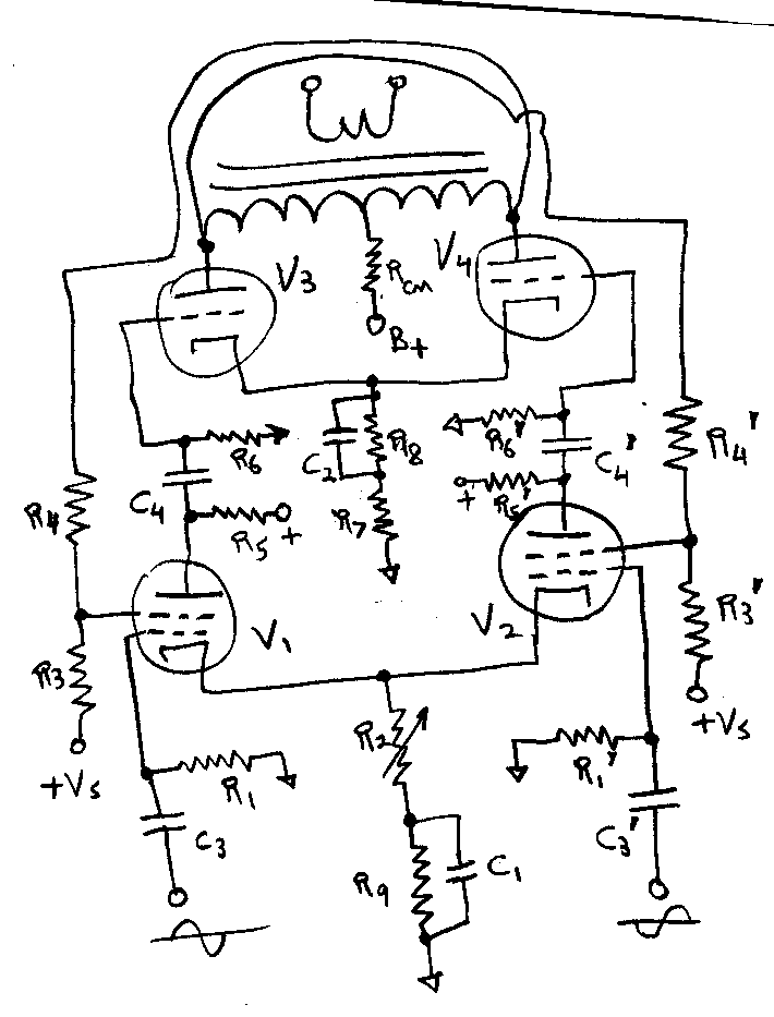

I was toying around with a class A, P-P amplifier design recently using cross-coupled resistive neg. feedback from the output plates back to the screen grids of the driver tubes. The drivers are configured in an differential LTP arrangement.
I started thinking about what would happen if the LTP used just a resistor in the tail instead of a CCS, and came across an interesting mechanism that appears to cancel only odd harmonics.
The idea of crosscoupling canceling odd order distortion I believe has been mentioned by Thorsten earlier in a thread on partial feedback to the driver grids and I think I also heard it mentioned for the Wolcott design too. At the time(s) I couldn't see how two inversions (1st from moving the feedback to the driver grids instead of the plates, the 2nd from the cross coupling) could account for any effect particular to odd harmonics other than the normal negative feedback action. And no explanation was offered at the time as to how this could happen. And I still think that in the ideal case of a perfect LTP there would not be any effect.
However, for a resistor tailed LTP, the variation of tail current with a common mode signal on the grids, causes a variation in gain of the LTP stage. Which potentially can be used to cancel gain variations elsewhere (like the outputs!). Now a perfect P-P output transformer will only have differential signals across the plate terminals (unless the B+ sags). But a real xfmr will have some winding resistances which act as current sampling resistors.
For a distortion where one tube increases in gain by the same amount that the other tube decreases in gain, no common mode voltage droop will appear. (ie. for perfect class A and also for this quasi-complementary distorting example of class A operation, constant B+ current is drawn.)
But for even order distorting devices like tubes and Mosfets (outside of their square law region), errors in gain are monotonic in polarity. Ie, their gain typically increases with increasing turn-on (well, untill saturation is hit) This means that one P-P output device will increase it's conduction more than the other device decreases its conduction, causing a common mode current change.
Increased common mode conduction thru the xfmr resistance causes the common mode plate voltages to drop, and the LTP grids will also drop correspondingly in common mode, which lowers the current in the LTP tail. This in turn lowers the LTP gain, which if adjusted for the correct amount can compensate the output stage's net increase in gain.
Near saturation, this common mode mechanism will also operate, since only one output device enters saturation at a time causing a large common mode current change. But the error effect is much larger there, and the common mode error correction loop gain is fixed ( by tail resistor value) at the lower level needed for the correction in the nearly linear region of operation. So saturation will still be soft and tube like. (notice that this common mode mechanism operates with a finite loop gain, just like Hawksford Error Correction, but is specific to only odd order distortion in this case)
Certain types of output device distortion, such as Mosfet square law conduction, will not be corrected by this scheme. There, the transconductance increase of one device is matched by the transconductance decrease (in class A only) of the other device, causing no common mode feedback. But this has no net affect in class A, since the total signal transconductance remains the same.
So no correction occurs when none is needed.
Obviously, this scheme only works for class A operation of the output devices. And requires strictly regulated B+ for sure.

odd-order cancellation
You have stumbled upon what Western Electric called "harmonic equalization" and a version of it was used in its 92A push-pull 300A amplifier in 1936. This seems to have been forgotten up until recently, although it has been used in the Dynaco power amps (the common-cathode current sense resistor) and in the Scott 340 receiver (as a unbypassed common screen resistor).
Your explanation is quite clear. Another was of looking at this is from the point of view of an RF SSB balanced modulator. In a push-pull circuit, a signal taken off of a common load gives the balanced modulator output. Adding this signal back in can cancel odd-order harmonics. In the long-tailed pair, this happens automatically.
I have experimented with this using a test amp where I could dail-in the amount of common cathode impedance from infinity (i.e. a CCS) to zero. Using push-pull 6CK4s, I found that the odd-order distortion could be significantly reduced, and that the null was not too sharp. With infinite resistance (CCS in the cathodes) the odd-order distortion was much higher than with grounded cathodes, arguing against the use of a CCS in this location. The amount of common-cathode resistance needed for minimum distortion depends on the tube type, which reflects the different distortion characteristics of each type.
Distortion cancellation should always be approached with caution, since usually the reduction of low-order terms either (in the best case) leaves the higher-order terms the same or increases them. This alters the sonic signature of the amp, usually to the worse. However, my limited experience with the harmonic equalizer shows that it doesn't seem to significantly increase the high-order terms, and can thus be used to tailor the sound of the amp.
This is an area that needs more exploration. Congratulations on your discovery and clear explanation.

Thank you John.
As usual with tube circuitry, someone has thought of it before. But the idea doesn't seem to have made it into the textbooks, much like inner positive feedback loops didn't either.
The common resistor in the P-P screens idea is interesting. I had some while ago looked at optimizing a single ended "triode" wired pentode. I came up with an equation that indicated that there is an optimum resistance and voltage drop to put between the screen grid and plate when the plate was loaded with a finite load resistance. My guess is the P-P case is related, with the SE signal part nulled out in the P-P pentode case.
Now if someone can just figure out how to do the harmonic fix for class AB!

Hi Sheldon,
Yes, Allen Wrights use of the 68 Ohm unbypassed common cathode resistor in post 292 by Gingertube appears to be a related method. It measures common mode current, which is proportional to total transconductance, and alters biasing of the tubes to approximately (only approx. unity gain available from CF mode) restore common mode current (or total transconductance) back to the norm.
By including an additional gain stage in the loop, the cross coupled approach or Steve's A2 PP 801/ WE ... designs can more accurately regulate the total transconductance.
Hi Dave C.,
The basic distortion correction mechanism is fairly straightforward in my way of thinking (I hope, but lengthy): The total common mode current is proportional to total transconductance from the two output tubes. If their grid signal drives are truly complementary, then this common mode summed current should remain steady during a signal cycle.
Ideally the output devices would have constant gm versus grid signal drive and so would give constant summed or common mode current during a signal cycle. Real devices however don't meet this high standard, but we can settle for equal increase of one device gm being offset by the same decrease of gm by the other device. Since both devices are operating in parallel AC-wise and effectively sum, this is adequate. This still produces constant common mode (CM) current too, so our measurement technique is safe.
Variation (with signal) from the constant CM current level would indicate a distortion causing variation of total gm. If this variation is polarity sensitive we would be seeing even harmonic distortion. But for a P-P output stage, symmetry prevents this. So any variation must be symmetrical, producing (or indicating) odd order distortion.
Typical 3/2 power current variation (100% component for pentodes or as a distortion component for loaded triodes) will produce an increasing total gm as signal increases from zero in either polarity (for P-P) up until saturation is reached at which point total gm will plunge due to the saturated tube loosing serious gm (and the other tube being almost cutoff by grid signal already). So the 3/2 component will be causing odd order distortion. ( the 3/2 power effect produces a greater increase in gm in one tube than the drop it causes in the other tube for an increasing signal)
The saturation effect is likewise fully symmetrical in P-P so it is producing odd order distortion too.
So by monitoring the CM current we can use it to effect a compensating gain change in some way.
The cross coupled feedback LTP driver, with a resistive tail, uses the CM portion of the feedback signals to alter its tail current. Increasing tail current causes a gm increase in the LTP driver by the same 3/2 power non-linear gm mechanism to, in turn, give a gain boost (or buck) to the incoming grid differential drive signals.
Net effect being to keep the final thru-channel gain constant.
The differential component of the cross coupled feedback, meantime, also makes for a short, nearly local (transformer and input stages not included, so high bandwidth) negative feedback loop to effect conventional NFB error correction of the output stage and to lower output impedance.
So we are getting our moneys worth from the driver stage twice: differential (or P-P) mode and SE (or CM) mode corrections. Only a small amount of CM correction is thus required to fill in for the lack of infinite gain in the differential NFBK loop. So a pot in the tail is useful to set the optimum level of correction.
Hope that clarifies the mechanism. (Take two aspirin and call me in the morning ) 😀

Diagram
I have attached a diagram of the cross coupled feedback scheme to clarify the idea. Some sorta extra resistors like Rcm and R7 are included for clarification or extensions. The more usual cross coupled feedback design would bring the R4 feedbacks to grid 1 of V1 and V2, this would provide more gain to the NFDBK loops and would work also for the distortion neutralizer idea.
I was originally just toying with the idea of the screen grid feedbacks since they would avoid loading down the input impedance of V1 and V2 and are a better voltage match to the plate pickoffs.
R2 is the common mode feedback gain adjustment pot. R7 could be used to provide some common mode feedback too. Rcm represents the effective common mode resistance in the xfmr primary, but could be a real resistor too.
Don

Correction to post #10
Oops! Was getting late last night when I posted #10.
In the near to last paragraph I said:
"Only a small amount of CM correction is thus required to fill in for the lack of infinite gain in the differential NFBK loop."
This is incorrect, it should read:
The common mode corrector loop is adjusted for best fit to the FULL gain correction of the output stage (by pot R2 in the above diagram) , then the conventional cross coupled differential NFDBK loops clean up any remaining imperfections as best they can. This is just the old maxim applied: to linearize the open loop as best you can before applying NFDBK.

Its a little hard to tell what Steve's intentions are in the A2 PP 801 circuit without some input from him. The unbypassed 50 Ohm resistors in the 801 cathodes are acting as current sampling resistors, and since the grids hover above the cathodes in A2 operation, one is getting an indirect current measure of the output current appearing on the grids. This may have an advantage in that the current measurement is with respect to ground instead of the B+, so regulated B+ is not strictly required.
But some disadvantages seem to lurk here also:
The cathode resistors will be raising the output impedance of the 801s. And, the voltage drop between grid and cathode in A2 operation has the opposite sense to the cathode current for correction purposes. (Let me explain: If a tube is providing less than expected Gm, then the G1 to cathode voltage will rise in A2, countering the expected drop of the cathode resistor current sampling voltage, thus canceling at least some of the desired feedback.)
The final merits off course rest with the spectrum analyzer results and listening tests.
Don
Hi Pete,
Good to see some others have been experimenting with the harmonic neutralizing thing. You are all ahead of me, I haven't built anything for this yet! I MUST find those WE schematics now, so I know what you all are working with. (I think I have seen at least the WE92A schematic around on the net. Have to do some searching.)
I would especially like to get this neutralization idea to work for class AB. Will take some real Cowabunga tricks to pull it off though.
Just a random thought: When one P-P tube cuts off to class B, we lose the countering decreasing current contribution to the CM sum from that tube, which served to eliminate the expected linear effects from the common mode signal. Perhaps a P-P driver stage operating in matched class AB (same matched timing of the cut to class B as the output stage) could be configured to provide the required compensation or missing signals. Then again, the cut to class B depends on load current draw, so out with that idea. Mucho work to do yet.

smoking-amp said:I MUST find those WE schematics now, so I know what you all are working with. (I think I have seen at least the WE92A schematic around on the net. Have to do some searching.)
WE92A schematic. I still can't figure out how it works, but I think I'm beginning to see some pieces of the puzzle. Several other Western Electric amp schematics can be found on this page.
WECo patent on distortion reduction
Among the patents listed on the side of a Western Electric 92A amp is this interesting one: 1,970,325 "Reduction of Distortion in Vacuum Tube Circuits".
This seems to cover their idea of the harmonic equalizer. The file is too big to upload here, but you can find it at http://www.google.com/patents?id=QtVZAAAAEBAJ&dq=1970325
- John
- John
In my schematic collection I have one that I kept in the hope of understanding it one day.
Reading this thread made me remember it...
It's compensation circuit looks somewhat similar to the WE92.
Can anyone confirm if this circuit has a distortion neutralizer for odd harmonics?
It would solve a small mystery for me....
I found it on http://www.pmillett.com/el802_spud.htm
Tia,
edit: typo
Tia,
edit: typo
Just to add my 2p. I've experimented with the WE harmonic equalizer. It doesn't work for all valves, and I came to the conclusion that depending on the curvature of the nonlinearity that needs compensation, you might need a negative value of resistance (haven't tried this yet). For valves where it does work, like all cancellation schemes, it requires the load to be constant. Zobel networks are useful.
markanica said:Can anyone confirm if this circuit has a distortion neutralizer for odd harmonics?
Geesh, I forgot all about that one. I didn't realize senile dementia can set in as early as your 40's...
Yes, this is a distortion cancellation similar to the WE scheme, though a little different. Note that there's a choke feeding the OPT CT, and that the cathode "ultrapath" cap goes to the OPT and inductor. So from an AC standpoint, the AC return is through the 62 ohm resistor. The common-mode signal generated there is fed via the input transformers to the grids.
The 62 ohms I came up with experimentally. It forms a voltage divider with the 50 ohm balance pot (you can think of it as just 25 ohms connected to both cathodes).
As I recall I dialed the balance off-center to make the even distortion higher than the odd. If you adjusted it for a null, the THD was incredibly low, though it did drift off-center a bit.
It sounded very nice. The downside was high miller capacitance, and the tubes were run so hot they were starting to show a little plate color.
Pete
